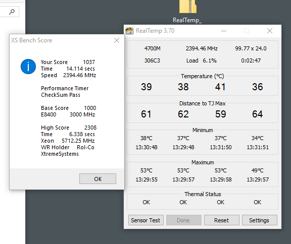

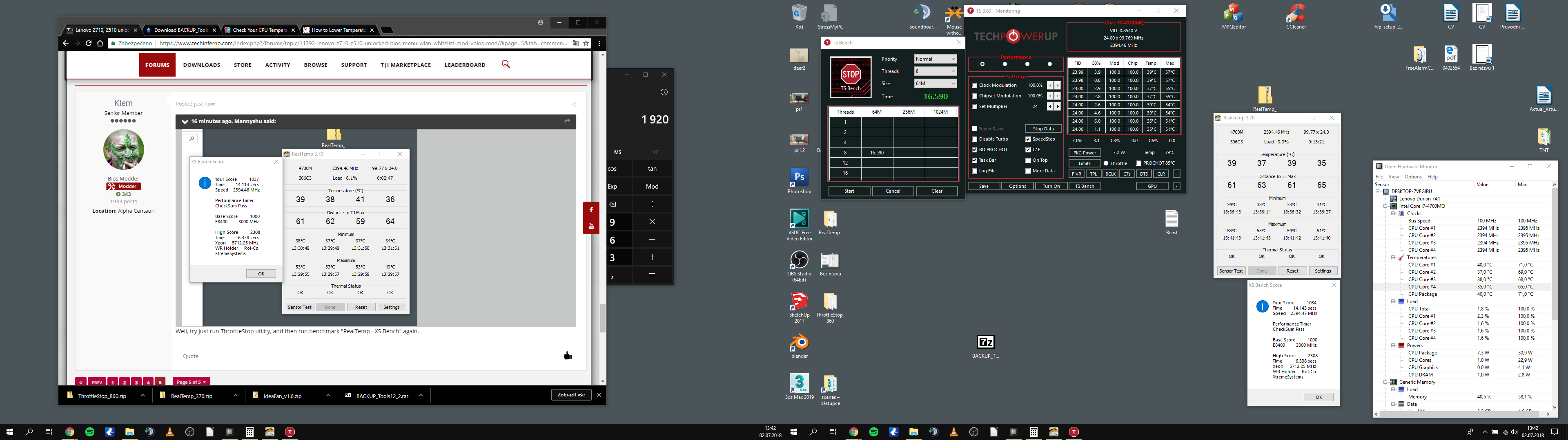

Mannyshu Posted July 2, 2018 Share Posted July 2, 2018 15 minutes ago, Klem said: Well, try just run ThrottleStop utility, and then run benchmark "RealTemp - XS Bench" again. im not sure if ive done it right, but this is what i got Quote Link to comment Share on other sites More sharing options...
