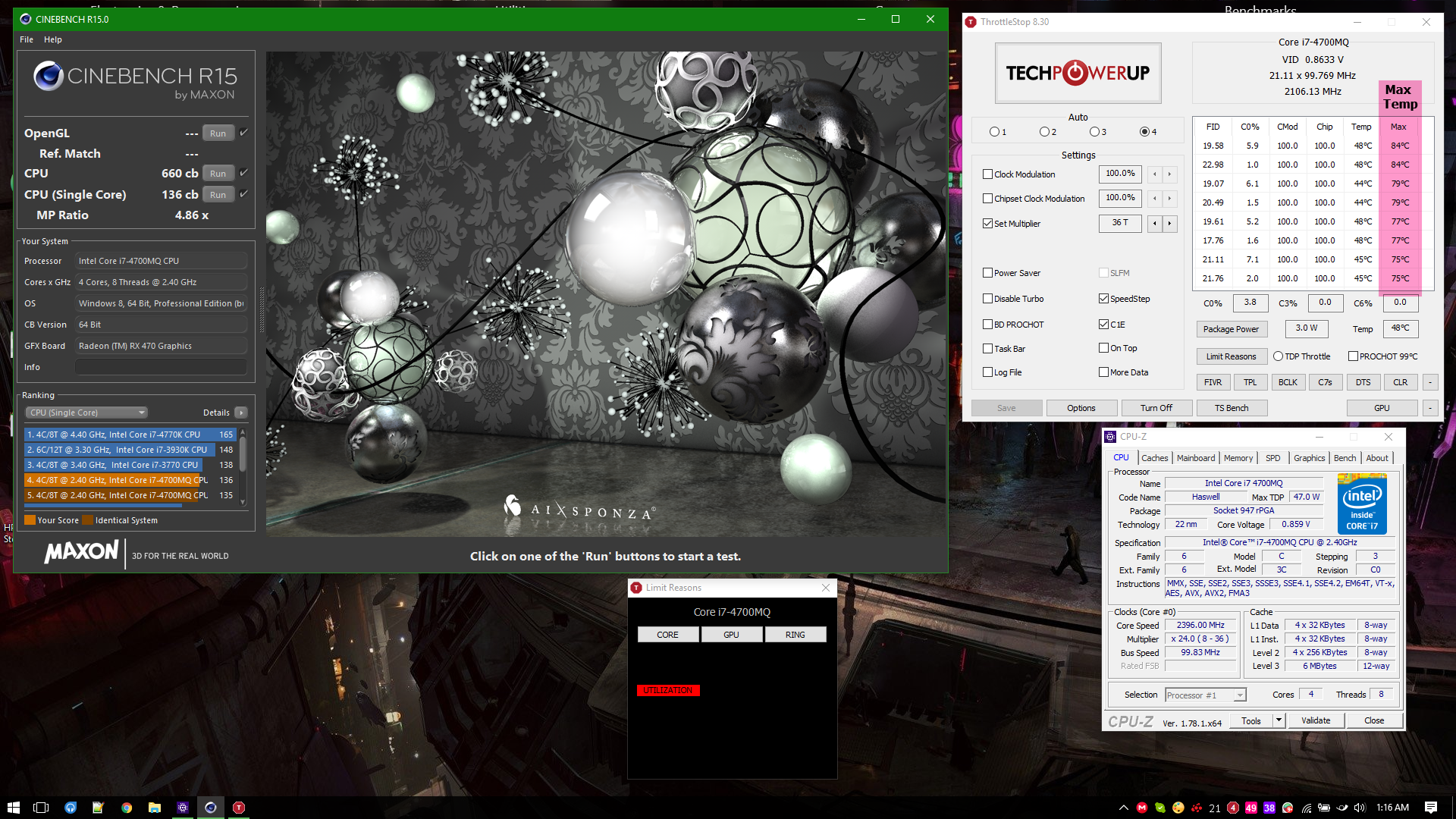

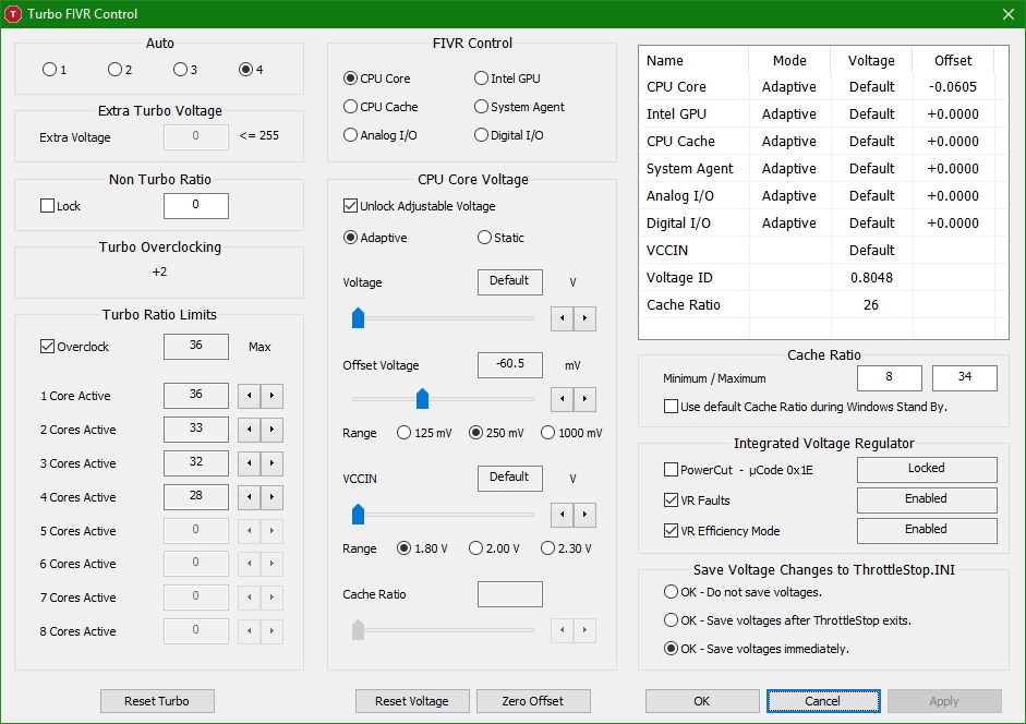

Tesla Posted February 11, 2017 Share Posted February 11, 2017 (edited) Since I started to use the Ultrabay eGPU setup(Thanks to Gerald) with the RX 470. I noticed a CPU bottleneck in some games that need some CPU horsepower (Witcher 3, Watchdogs 2, GTA V ...etc). So the first thing I did was to replace the thermal paste and clean the laptop from the inside. I used Arctic MX-4 TP and results were impressive(I got rid of instant thermal throttle of the cheap TP that I had before). However, I was not satisfied because I still can not maintain a constant 3.4 Ghz on all cores without hitting 99c(aka thermal throttle). Next I figured what is the highest clock I can get my cpu to on a single core, 2 cores, 3 cores and 4 cores while keeping temperatures within the acceptable range and set up a custom OC profile(using Throttle stop) with the following settings: * -60mV on the core offset voltage. * Difference multiplier ratios for different core usage as shown in the picture below. The achieved temperatures are really nice hovering in 75-85(4 cores @2.8 Ghz), ~65(single core @3.5Ghz) in CPU intensive games. if a game uses single core, then the CPU will run at 3.5 GHz, if four cores then it will run at a 2.8 Ghz. that way I kept both temperatures and fan noise level in check. However, I'm still looking for a better cooling solution that will allow me to run the CPU at 3.4-3.5 Ghz all the time. Here are couple of ideas that came to my mind: 1- attach another cooler to the heat pipes that are exposed when removing the bottom cover of the laptop (AIO water cooler or air cooler; the AIO is an expensive option but will be easier to mount). 2- same as above but using a custom copper pipes from the exposed heat pipes of the laptop to an external CPU cooler. in other words external heat pipes to a secondary external heatsink. 3- strip the laptops motherboard and mount a water cooler (no idea how to do so, thermal glue or custom bracket?). 4-Give me your idea. I need your help to help me decide which path to go and if there is a better way to do it. I really wanna get the max performance out of my 4700MQ. Edited February 21, 2017 by Tesla removed misleading title 1 Quote Link to comment Share on other sites More sharing options...

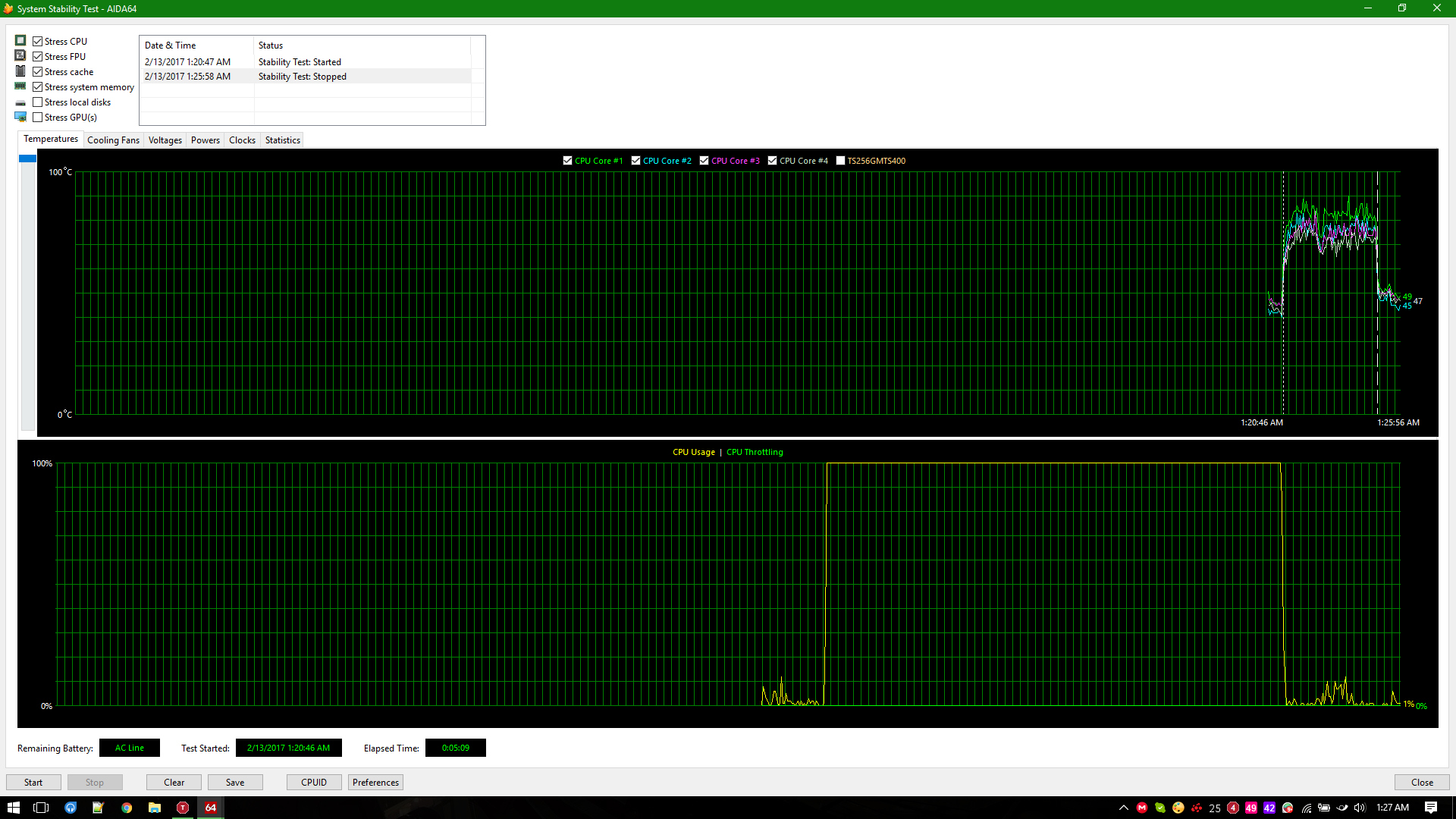

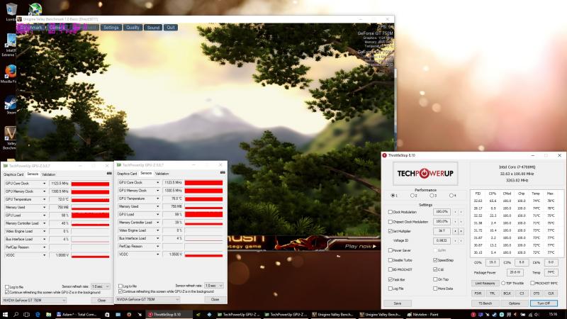

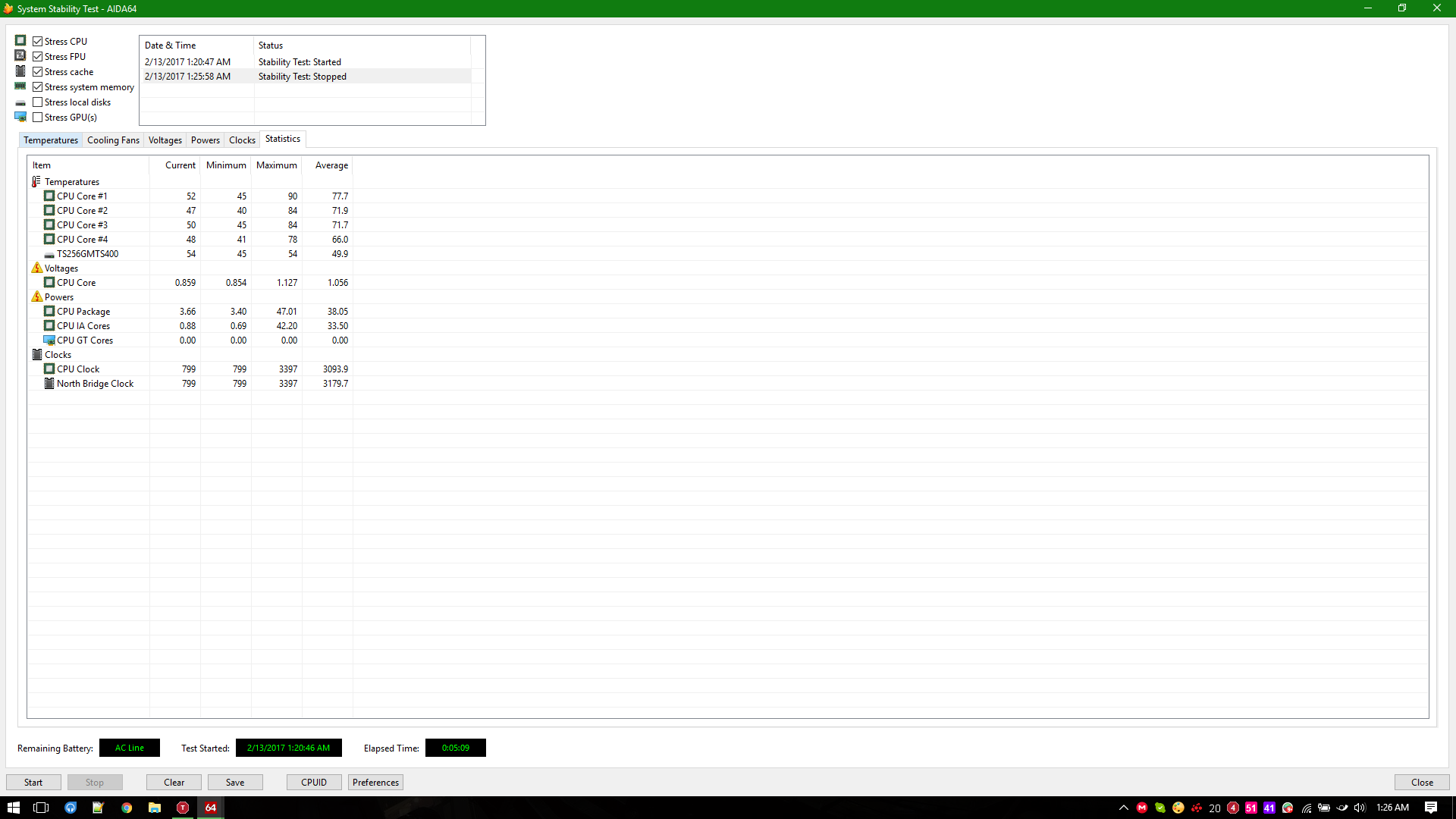

Tesla Posted February 12, 2017 Author Share Posted February 12, 2017 (edited) Update: So I've done some minor modifications, although they don't seem much, but they resulted in a huge temperature drop, now the cpu temps dont go past 83 even when stressing it with AIDA64 (5 mins, 3.4Ghz on all 4 cores) In games the cpu temp is hovering in the 50s - 60s even when the processor is being heavily utilized. So I'm pretty happy with the thermals so far. Basically I've done two things: 1- I put a good amount of thermal paste in the area under the heat pipe that goes to the gpu and the aluminum base. This will allow CPU temps to be dissipated by 2 Heat pipes instead of one. 2- I removed keyboard to allow more air intake. Cheers. Edited February 12, 2017 by Tesla typo Quote Link to comment Share on other sites More sharing options...

Tesla Posted February 12, 2017 Author Share Posted February 12, 2017 3 hours ago, AndreiKan said: Last time I removed the keyboard it really gave me very bad temps.I also put paste on that part of the heat sink. On the opposite of you, it gave me a good results. There are many variables tho. the thermal paste, ambient temperature. Here are some numbers: Idle: 45 'C CB R15 MC/SC Render Session: 5 minutes AIDA64 Stability Test Quote Link to comment Share on other sites More sharing options...
AndreiKan Posted February 13, 2017 Share Posted February 13, 2017 (edited) With stock bios, overclocked with IXTU cache voltage at - 75 full load 81 C. GPU1 65C and ultrabay 70, usually there is 6'C difference between them, the latter running hotter.(full load +135 MHZ,) Second GPU gives me Video management internal after sleep/hibernate though. I have put a button on each brown wire if things get hairy. Edited February 13, 2017 by AndreiKan 1 Quote Link to comment Share on other sites More sharing options...

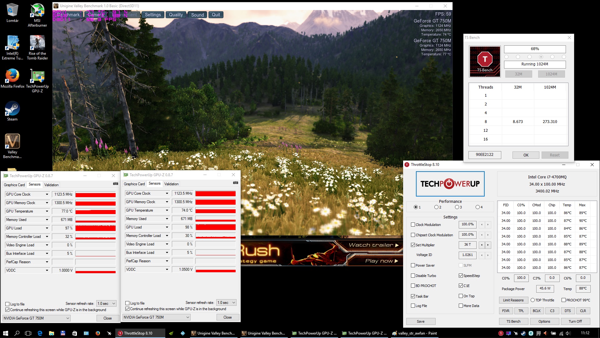

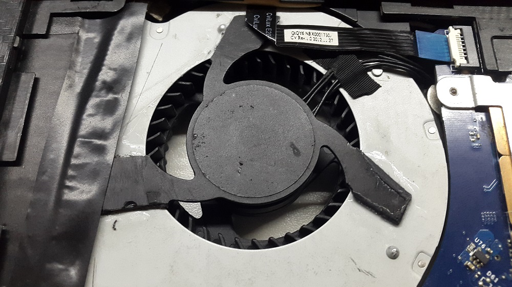

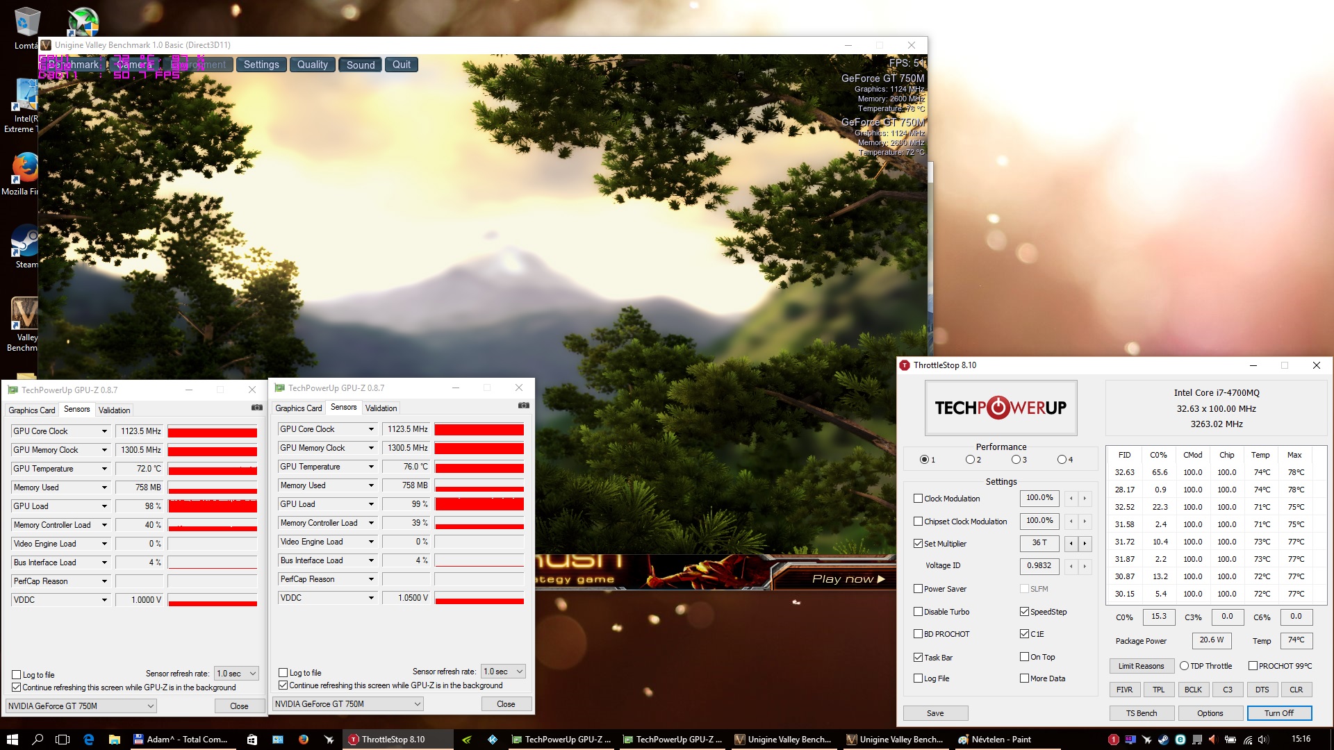

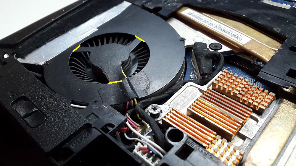

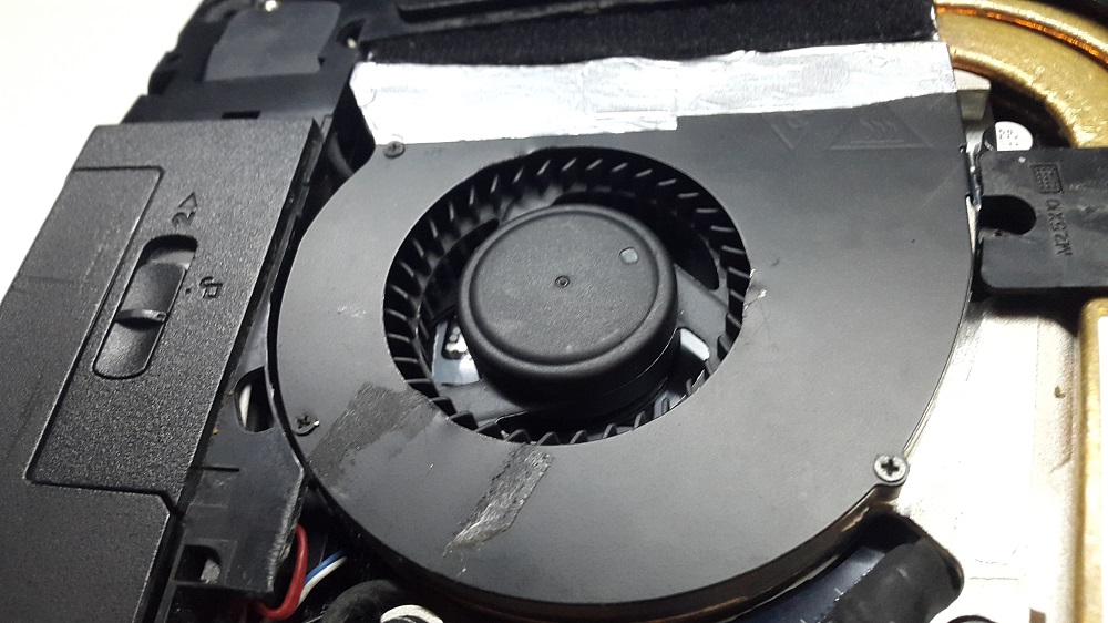

ghoul Posted February 21, 2017 Share Posted February 21, 2017 This is not a mod, this is just underclock. Title couldn't be more misleading.... Let me show you a real mod: Cut out original fan Cut out AW fan, and glue it into original fan shroud Other side: Valley stress test: Valley + TS bench No laptop cooler,or anything, just slightly elevated chassis With this, been able to use 4930MX@4Ghz for gaming... 1 Quote Link to comment Share on other sites More sharing options...
