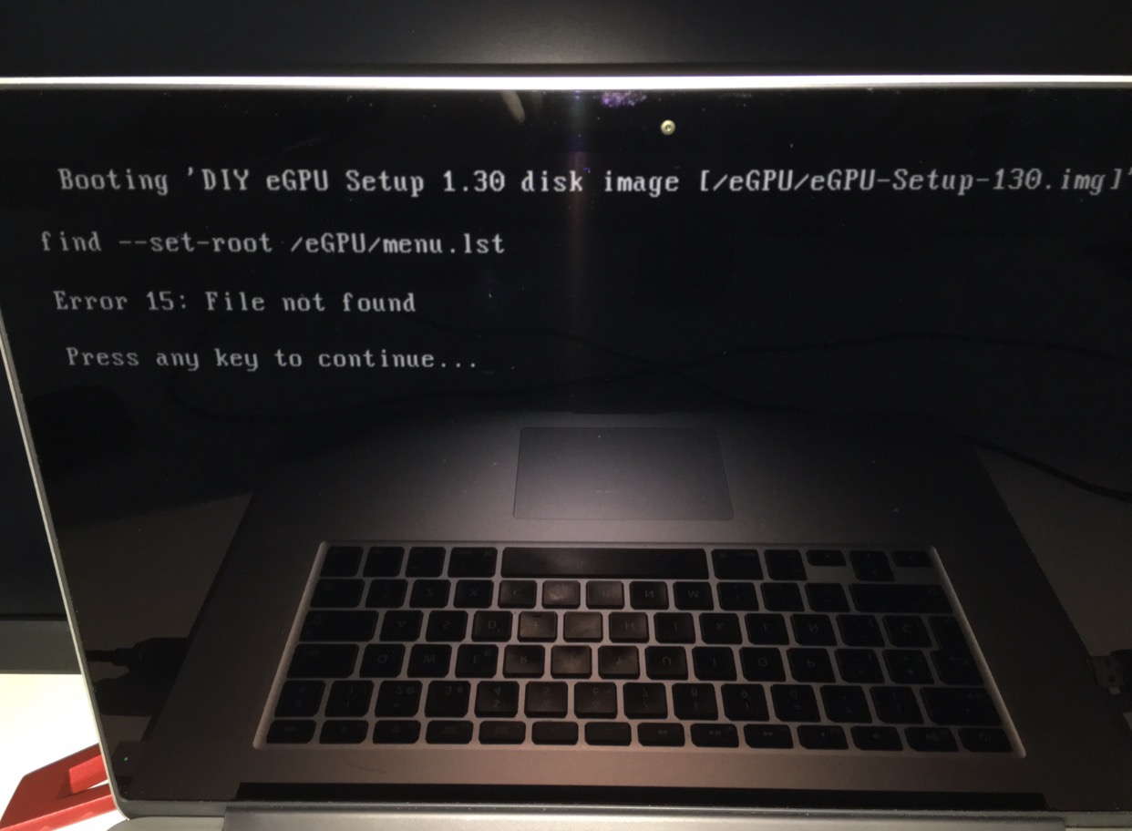

Hi guys, I have been trying to install Nando 1.2 or 1.3 patch for my egpu setup, followed all the steps but once I mount the external image and boot into windows (and get prompted to choose 1.2 patch on boot screen( I get the following error (see updated image).
I have a late 2012 mbp retina with nvidia 650m and windows installed on an external ssd drive without bootcamp.
Any help on this would be much appreciated..

Pls check if your using got or mbr partitions to host your windows. Setup 1.20 requires mbr partitions. If it is mbr and disk image install is still problematic, then pls use a USB stick installation instead.
Hi Tech Inferno Fan, HDD are MBR (checked with diskpart and list disk, my boot ssd hard drive which has windows on it is MBR), on the other hand I also tried to make a boot usb stick as stated on the instructions:

It gets recognised on the startup of mac (get two windows drives) but does not make any difference.
Pls use easybcd to add a second boot item to your primary her that points to the windows on your Usb drive.
Then install setup 1.30 on the primary her and use its chainloading mbr to bring up that primary her bootmenu from which you select the usb HDD win installation.
Need to do this because the grub bootloader probably does not recognize your Usb drive and so can't boot the setup 1.30 image off it.
