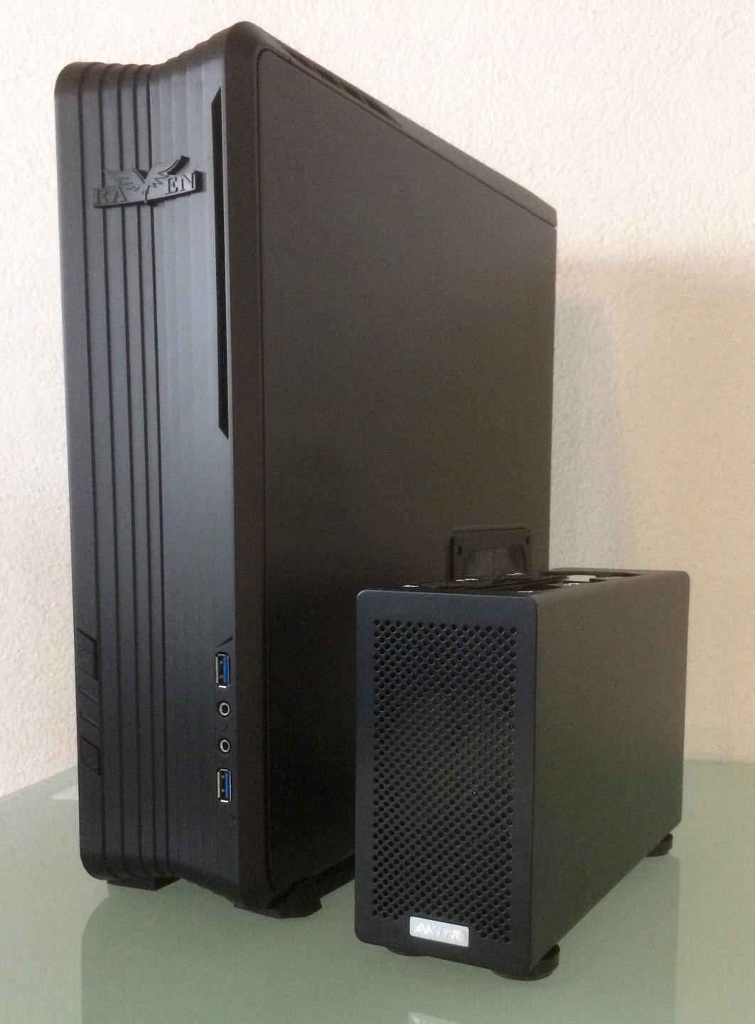

Dschijn Posted May 7, 2015 Share Posted May 7, 2015 Added some pictures in the first post. Now all the ventilation cuts are made. Need to figure out how to cover the uncoated aluminum on the cutting edges. Link to comment Share on other sites More sharing options...

Dschijn Posted May 8, 2015 Share Posted May 8, 2015 Added some pictures in the first post. Now all the ventilation cuts are made. Need to figure out how to cover the uncoated aluminum on the cutting edges. Finished all cuts. Now I have to wait for some wires from Hongkong to start the soldering. old vs. new: 1 Link to comment Share on other sites More sharing options...
