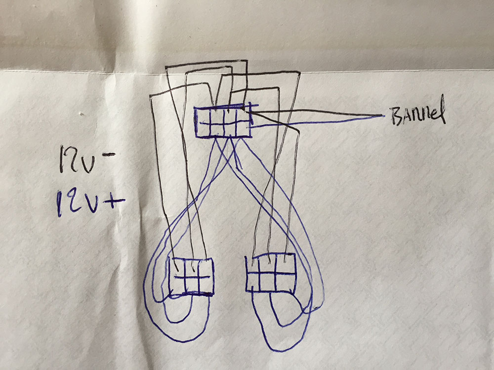

w4vz Posted April 25, 2015 Share Posted April 25, 2015 you can also use an extension cable for 24-Pin ATX, cut the cables and rewire as you wish.Hey Dschijn, Thanks for more infos on that. I am leaning toward using a Da2 myself and Im very interested to do the wiring with an extender because the soldering appears very tricky there. Could you elaborate on that by any chance ? I have no idea how to wire it really. As I understand I need to plug 2x 6 pins PCIE connectors to power my 970 and my barrel to molex for the akitio from a 24 pin extender connected to the DA2 ? Link to comment Share on other sites More sharing options...
Dschijn Posted April 25, 2015 Share Posted April 25, 2015 Well… you must take a look at the connectors on the DA-2. It can be connected on two positions to the 24-Pin ATX cable. If you cut the all the wires of the 24-Pin you can reconnect (soldering) them to the 8-Pins of the 24-Pin you chose. Maybe it is even easier to directly solder 6-Pin PCIe cables directly to that cut wires. Link to comment Share on other sites More sharing options...
w4vz Posted April 25, 2015 Share Posted April 25, 2015 Well… you must take a look at the connectors on the DA-2. It can be connected on two positions to the 24-Pin ATX cable. If you cut the all the wires of the 24-Pin you can reconnect (soldering) them to the 8-Pins of the 24-Pin you chose. Maybe it is even easier to directly solder 6-Pin PCIe cables directly to that cut wires. Please forgive my electrical ignorance. I read the guide here but still can't figure it out :/ The idea is to make 2 x 12v 6pin molex adaptors and one 12v molex to barrel from the 3 12v pairs pairs coming out of the DA2 ? each 6pins molex takes 6 connectors (3+ and 3-) so I could in theory connect everything like my (bad) diagram below ? Well... each part (barrel, 2x6-pin) has to deliver 75W. To spread the load even you can connect everything to all 3x12V and 3xground. 1x12V for the barrel might be insufficient. @w4vz: As long as you keep matching 12V (yellow) and ground (black) between PCIe and DA-2 it should be fine. Just don't mix 12V from DA-2 with ground of the PCIe plug. Get the wiring diagram of the DA-2 and the 6-Pin PCIe plug. Link to comment Share on other sites More sharing options...
w4vz Posted April 25, 2015 Share Posted April 25, 2015 Ok so my diagram is correct ? I could double the barrel one. Would that be sufficient ? @jacobsson Just found this on eBay, would that work you think ? could be plugged directly on the DA2 and only need to modify it for the barrel ? what do you think ? Link to comment Share on other sites More sharing options...
