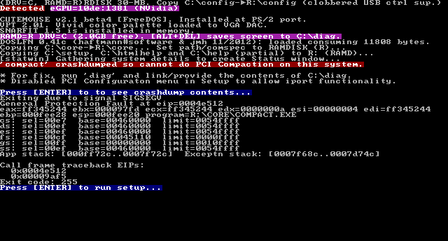

ArneFW 10 Posted April 9, 2015 I am trying to run my eGPU on my laptop display, meaning I need to enable both igpu and egpu (right?), and to do this I need to run pci compaction (right?). I am unable to use pci compaction in setup1.x, it ways that it is disabled. Any help is appreciated, thank you Quote Share this post Link to post Share on other sites
Tech Inferno Fan 20 Posted April 9, 2015 I am trying to run my eGPU on my laptop display, meaning I need to enable both igpu and egpu (right?), and to do this I need to run pci compaction (right?). I am unable to use pci compaction in setup1.x, it ways that it is disabled.[ATTACH=CONFIG]14533[/ATTACH]Any help is appreciated, thank youPlease go into the Setup menu, select Save Diags->compact_fails and allow it to run through. Once complete, reboot into Windows, run c:\eGPU\eGPU-setup-mount to get V:, archive the v:\diag contents, upload them to mediafire.com and email me the link. Thanks. Quote Share this post Link to post Share on other sites
