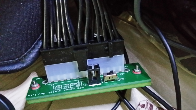

What is this part right here may I ask? So I have a 2011 MBP Sandy Bridge and a Sapphire HD7950 3GB, I just need Akitio Box and x16 riser and a power supply to make an eGPU? I tried to search how to connect PSU to Akitio but no luck. Where can I find this guide? Please let me know. Thank you
Here you go:
Would you mind adding these pics to complete your thread at http://forum.techinferno.com/implementation-guides/7879-%5Bguide%5D-2013-13-macbook-pro-gtx970%4016gbps-tb2-akitio-thunder2-win8-1-osx10-10-a.html#post107838 . I've attempted to edit them in but seems they don't preview unless added by the attachment owner.
@Dschijn , there's a bit of discussion about Optimus internal LCD mode not working for you. Did you apply Evo's guide to get it all sorted: http://forum.techinferno.com/diy-e-gpu-projects/8106-%5Bwip%5D-2013-15-macbook-pro-iris-gtx970%4016gbps-tb2-akitio-thunder2-win8-1-osx10.html#post110489 or was it the EVGA GTX970's unique delayed power on that did it? Would you like to integrate what was necessary to get internal LCD mode sorted into the opening post? There's mention of it not working, then there's benchmarks of it working. Would be confusing for the casual reader.
[ATTACH=CONFIG]13300[/ATTACH]
http://forum.techinferno.com/enclosures-adapters/8441-%5Bguide%5D-switching-atx-psu-using-paperclip-trick-swex.html#post115323
