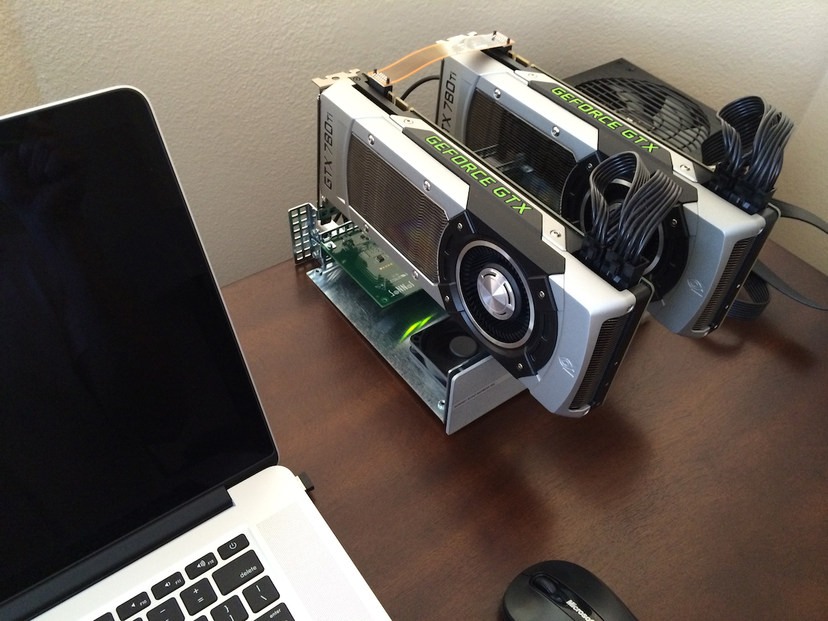

mnrc Posted August 18, 2014 Share Posted August 18, 2014 Hey all, I received an Echo SEL after not being able to cancel my order and switch to the Akitio Thunder2. This case is quite small and cannot fit an eGPU, but I thought that Squinks's solution in his SLI post is not too bad looking: While he uses regular risers, a more stable solution would be to use a 90 degree riser. The only one I've found on eBay appears to tilt in the wrong direction: PCI E 8x to 16x Riser Adapter Card for 1U 2U | eBay I can't find any others similar to this. Any tips? Thanks! Link to comment Share on other sites More sharing options...
