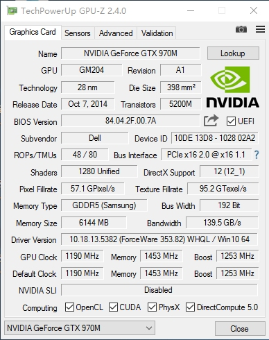

Hello. I got problem with my clevo 970m 6g on M15x. I have tried these inf, but none of them is working for it. the hardware ID is 13D8 02A2.

Would you mind teach me how to add it? Thank you in advance! I am using Clevo 970M on my AW M15X. The hardware ID is as below
Sorry I didn't see your reply. Im not online here often.
  • Download new stock drivers and unpack it.
  • Download old stock drivers and unpack it
  • Download modified INF file for your clevo for old drivers from this thread
  • Use something like WinMerge to see differences between these old stock INF files and modified INF for your laptop
  • You will now see which parts are required for your card to be supported
  • Make same changes in new stock drivers INF file and install it.
