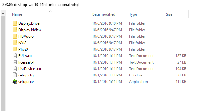

  • Run DDU "Clean & Shutdown (Safe Mode)
  • Extract driver using 7-Zip
  • Display.Driver folder,  copy/overwrite the proper .inf file(s).
  • Extracted driver package >> delete the folders as shown below (don't skip this step)  -> run setup.exe
       >>> Keep these folders only <<<

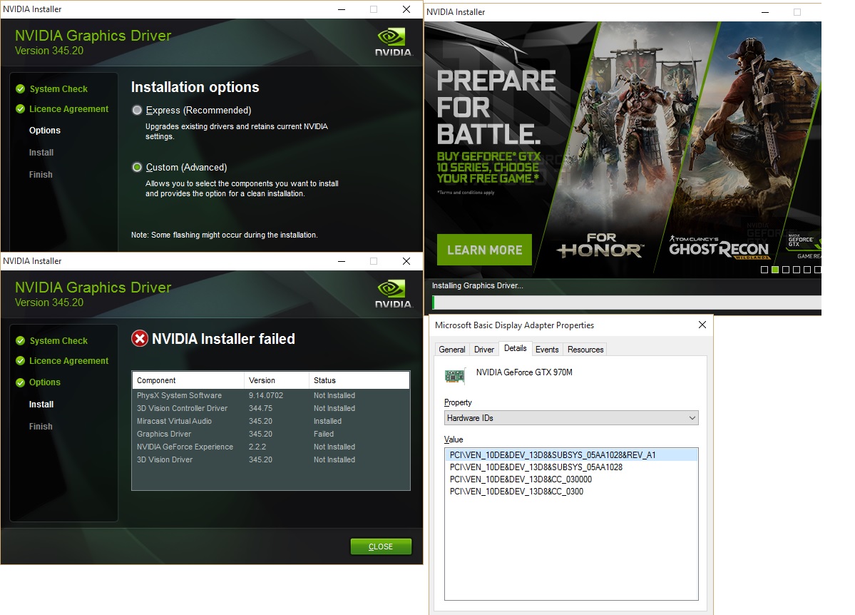

For any of you ...which of the drivers are best in general for the 970M? I am struggling to get it to work. I mean driver during the Windows installation works (the one that Windows picks automatically) the only issue I have with them is that OPTIMUS does not work completely. Nothing wants to use the 970m despite profiles set to use high performance card...
But whenever I try to install other once it comes as unsupported hardware (used Mr Fox modded once and passed the hardware check and started installation but 5sec in Fails to do so-pic enclosed; did the DSE disabling as well if any one wondering, also windows 10, full UEFI, fresh install of windows)
The device ID is as per picture
Also when I have used the Fn+F7 (or F5 dont rem now) to swap to dedicated after reboot got nothing and few beeps pointing to gfx and only CMOS battery removal revives the machine.
Is there a version of unlocked bios that will alow to disable Intel GPU and to install thos darn drivers?
