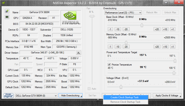

If you're using svl7 & Johnksss vbios mod, try increasing voltage offset (1.0v default), set it as a startup task. Some cards won't hold @1200 MHz w/ 1.0v. Run Valley benchmark free edition to test stability and monitor temperature. https://unigine.com/products/valley/

I took your advice, it seems to run stable at stock voltage. So I'll leave it there for now unless I want to overclock a bit in the future. Thanks again for the advice, that tool seems like a great way to test changes.
