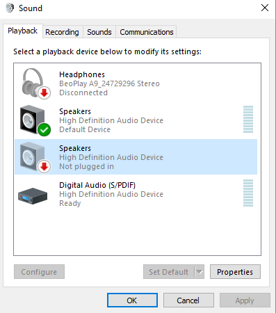

On 8/6/2016 at 10:15 PM, Christian Ademius said:
@J95I am aware of that. The playback devices as the attached screenshot shows has one which says "not plugged in". I believe that is my HDMI-out to which my Smart TV is connected to. I cannot do much except disable it in properties.
Anyone?
I had enough of alienware and DELL complicating things and limiting system modifications. I changed GFX from 460M to 680M 3-4 years ago and everything now on requires modding, hacking etc etc to get the drivers to work and I still cant get sound out of my HDMI to work since Win 10 (I think).
If no one can help in this matter then I better start saving for a non-complicated laptop such as ASUS, should I not?

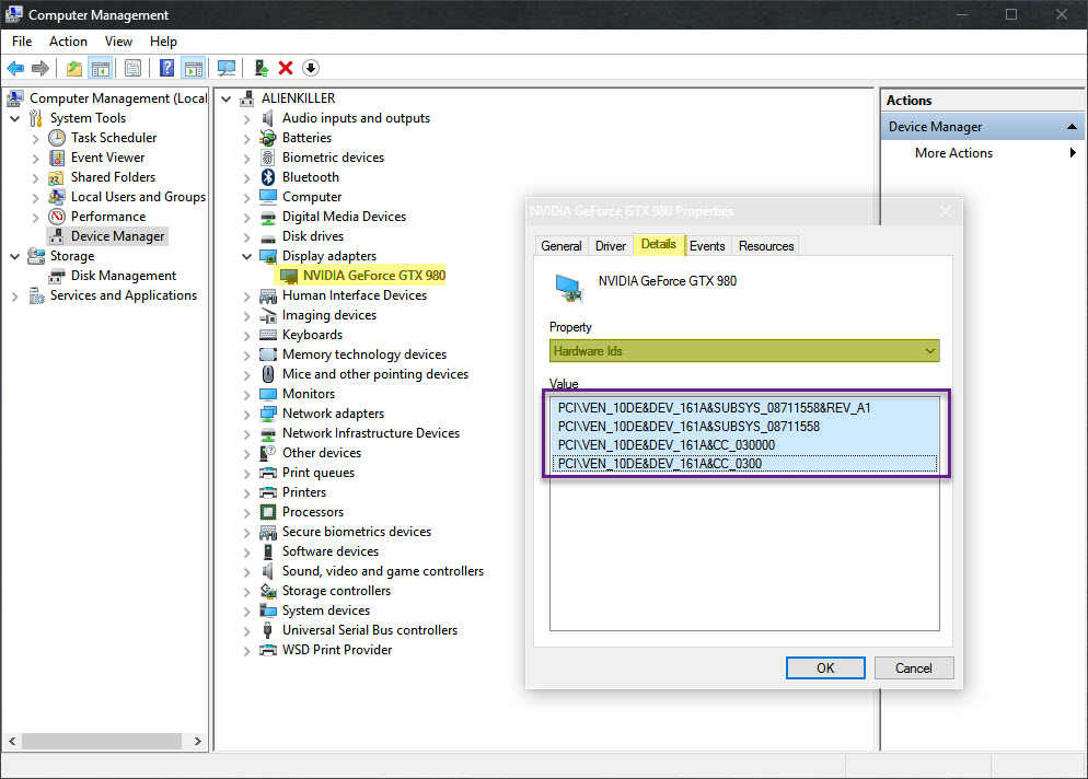

Sorry you are having trouble. GPU upgrades in laptops was almost always super easy for Alienware owners until Maxwell screwed up everything. NVIDIA has gone out of their way to make everything a pain in the ass now. Using Maxwell GPUs in an Alienware laptop is probably one of the worst upgrade experiences you could have chosen for your initiation ceremony. I hope it does not make you shy away from it in the future.
Just to confirm, you disabled Driver Signature Enforcement before attempting modded driver installation?
If you are trying to use MSI 980M cards, that could also be causing you extra grief. Are you using Clevo or MSI GPUs?
The hardware ID for your G-sync GPUs is different. It may need to be added to the driver INF mod. Can you please post your hardware ID from Device Manager? Also, please post a screen shot of the error message you see during driver installation attempts.

You need to download and install this driver from dell website(its the correct drivers + software which you need for the audio jacks to work properly):
http://www.dell.com/support/home/us/en/19/Drivers/DriversDetails?driverId=G340X
And also as @J95 mentioned previously make sure DSE is disabled before AND after installation, otherwise the software will disappear again once you update!
@haXBOXpro, @Shiroe you need to clean install modded Creative drivers from HERE (latest full package), otherwise Recon3Di control panel won't work. Just disable DSE (F8) before and after installing drivers.

Did you change BIOS sound card settings? those are required for the 780M only, not 680M.
You will need to install IDT drivers.

I have a GTX 780m on an Alienware M17xr3 Windows 7. The card is working find but I want to update from 344.75 to 372.70.
I was able to update yesterday from 344.11 to 344.75 to experiment on how I could do it. Found a guide and was able to do it no problem. From there I was directed here to upgrade to a 372.70. I pretty much have no idea how this works since I am fairly new at this.
I got what you were saying but when I try to download your  modded inf nv_dispi.inf_v372.70_Win7_8.1_PEG_Dedicated_Alienware.zip it keeps giving me the "page not found" error so I was just wondering if was only me that was having this problem.

Just adding this, installed it perfectly followed instructions and it works amazingly. Crazy good stuff  THANKS!!:hyper:
