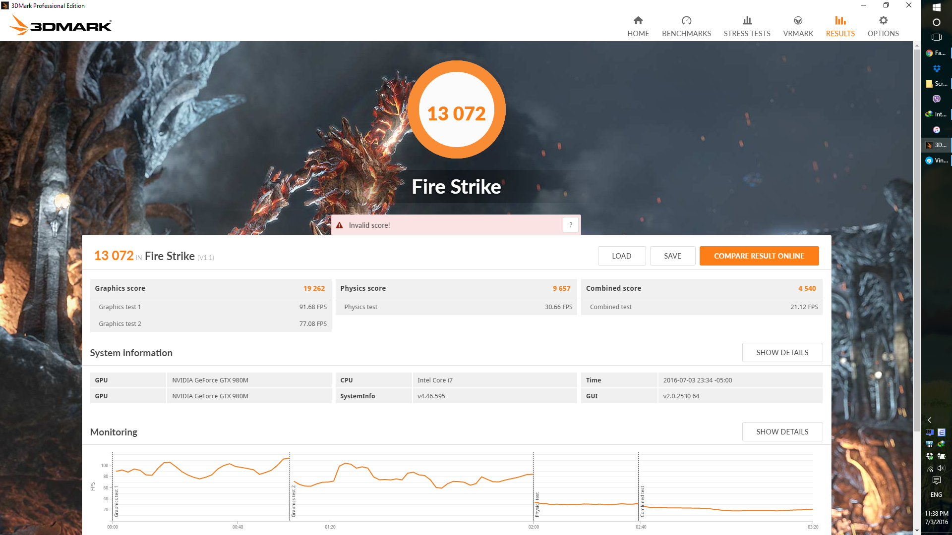

OMG the Hibernate trick did work! Never know about this, you save my life!
got over 19k graphic score with newer driver! never been so happy!
Edited by twin snakes

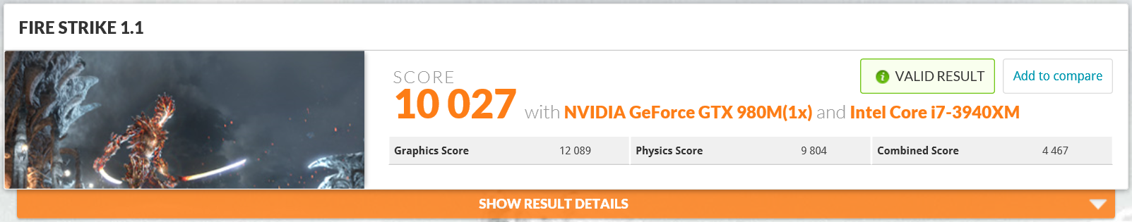

Did some benchmarks I got 12306  in firestrike v1.1 720p <<<<<<<is that good ?
I got 7100 in 1080P
PS: something interesting I noticed that TDP usually before was around 35% but now it's only around 25% ( maybe the new vBIOS ?) ? although the Clock speed is full I dont think there is throttling ? what is a way to know if my card is throttling ?
