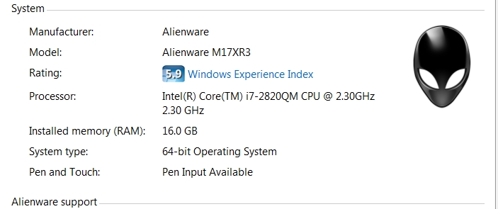

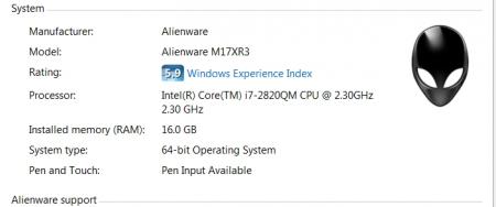

Hello, I've tried (and probably messed up somewhere while trying to follow the instructions) to install the latest drivers for a card I just recently installed and it seems its not recognizing the new installed hardware, I upgraded from a nvidia 460m to a 680m, I've made sure everything was seated properly and firmly but I am having no luck.
My hardwear ID's are showing:
PCI\VEN_10DE&DEV_11A0&SUBSYS_04BA1028&REV_A1
PCI\VEN_10DE&DEV_11A0&CC_030000
and my system specs on my M17XR3
This is my first upgrade so I'm sure I goofed up somewhere but any help would be appreciated.
Hi @IggyDerp, welcome to T|I.
Follow this guide, just skip the IDT workaround (780M/Integrated sound card disabled) [Guide] Alienware M17xR3 GTX 780M installation
Thank you for the welcome c: and for the quick guide as well! Seems like everything installed smoothly once the proper steps were followed, I have just one more follow up question.
Am I able to re-enable my integrated graphics or would you advise against this and just leave it as is?
Nope, keep it disabled. Glad it worked out...:D

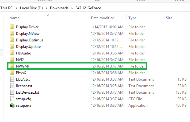

  • Extract driver w/ 7-Zip/winrar
  • Extracted driver folder "34x.xx-notebook-win8-win7-64bit-international-whql" -> copy NVWMI folder.
  • Display.Driver folder -> copy/overwrite nvcv.inf(NV drivers v344.91) or nvcvi.inf (NV drivers v347.09, v344.80, v344.75) nvcvui.inf/v347.12.
  • Extracted driver folder -> run setup.exe
  • -> reboot -> disable Optimus <-
Delete unnecessary folders. Rename "NVWMI_2.20" to "NVWMI"

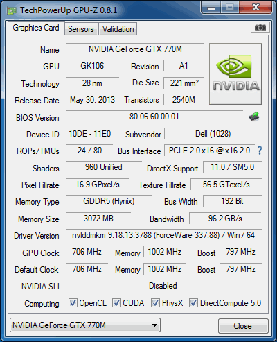

*edit never mind read up on how to do this. i got it to work with 337.88. is this the newest i should go? or should i go even newer?
m15x-337.88.zip

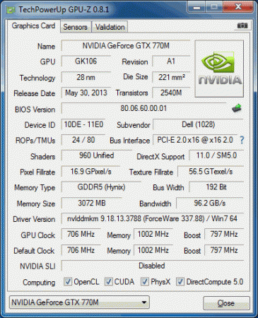

can you please upload an updated .inf driver for me please. anything suggested to run best, everything i have tried aside from 320.49 with slv7's inf have not worked thus far
M15x
gtx770m
windows 7 64bit
PCI\VEN_10DE&DEV_11E0&SUBSYS_02A21028&REV_A1
PCI\VEN_10DE&DEV_11E0&CC_030000
[ATTACH]13939[/ATTACH]
M15x
gtx770m
windows 7 64bit

thank you for your reply. i did this yesterday when i saw it was posted but i didnt install it as i was waiting on a green light from you pro's
i tried Mr. Fox's desktop drivers and saw no benefit. should i stick to the mobile drivers since i dont have sli? (yes i modified the nv_dispi.inf to include the 11E0)
Yep, nv_dispi.inf all desktop entries.

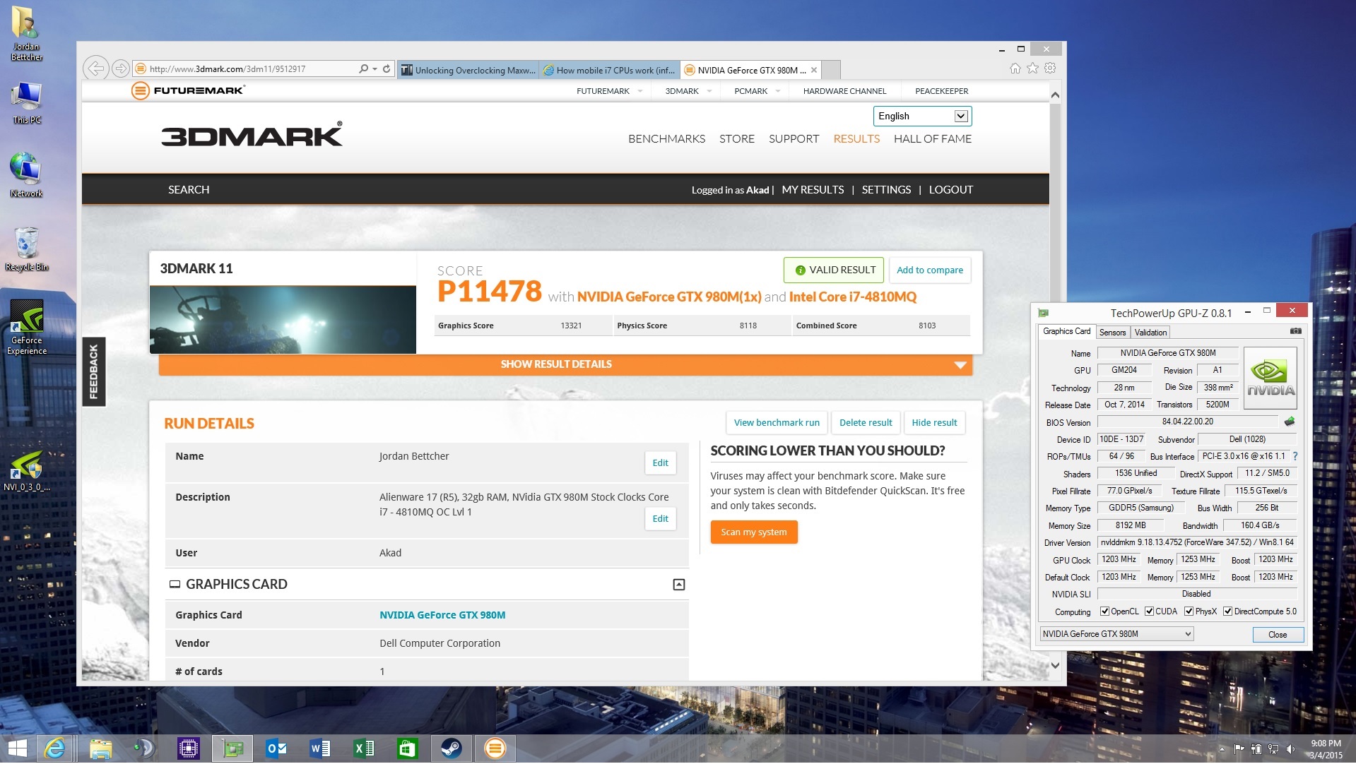

Here's something I can't seem to figure out J95, I'm using your 347.52 Mod to do overclocking but I'm still using nvdmi.inf that I've had to mod myself to get my 980m to work.
Every driver I try doesn't seem to work with the nvdispi, or the other modded files you provide. My computer boots but it hangs shortly after boot, I have to quickly reboot with advanced options to get Safe mode to remove drivers.
I've had this problem with the modified BIOS for overclocking and without, doesn't seem to matter. Somewhere in there as well I lost the ability to switch from dedicated to Optimus so I've left the system in optimus. If I leave the system with NVidia drivers modified using nvdmi.inf my system runs stable and seems to benchmark fairly well. I just can't seem to wrap my head around what is hanging Windows, this is on a very fresh install as well. I wiped system because of this issue shortly after I received my card. Any magic or tips you can suggest?
It's an Alienware 17 (2014) with an HIDEvolution 980M, id is 05AA 1028
Changed a couple settings and just ran 11801. So obviously it's not doing too bad.
