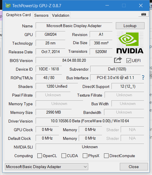

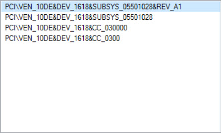

Jester945271 Posted May 14, 2016 Share Posted May 14, 2016 Hi Guys including the Golden Goose aka @J95 Never done this before can I get some help, upgraded my GPU's from GTX680's and tried the Mr Fox drivers but still cant install them without the NVidia cannot fine ETC screen. Can someone help me please. Cards are installed ok, I want to enable SLI. I have an Alienware M18x R2, Running Windows 10 64Bit PCI\VEN_10DE&DEV_1618&SUBSYS_05501028 Quote Link to comment Share on other sites More sharing options...
J95 Posted May 15, 2016 Author Share Posted May 15, 2016 On 5/14/2016 at 0:35 AM, 82280zx said: Thats also a good find, I'll give that a try as well just to see what happens, I tried sleeping it and waking it back up later (unplugged while it sleep, plugged back in then woke it up) and my throttle was back. Temporary throttling fixes, specific drivers, switching RAM XMP profiles, BCLK, 120Hz always PEG + IGP enabled (120Hz owners never try this, certain brick >>combination of BIOS settings<<)...basically messing w/ BIOS settings that will force F10 shutdown behavior "reset". Hibernation method HERE and HERE 18 hours ago, BDogg464 said: j95 do i copy over just the one inf file stated or both inf files that are in the download you directed m1e to? nv_dispi.inf and nvdmi.inf or just the nv_dispi.inf? Yep, copy both files. Please follow instructions above...disabling DSE & deleting the proper folders. 14 hours ago, Jester945271 said: Hi Guys including the Golden Goose aka @J95 Never done this before can I get some help, upgraded my GPU's from GTX680's and tried the Mr Fox drivers but still cant install them without the NVidia cannot fine ETC screen. Can someone help me please. Cards are installed ok, I want to enable SLI. I have an Alienware M18x R2, Running Windows 10 64Bit PCI\VEN_10DE&DEV_1618&SUBSYS_05501028 Those are G-SYNC 900M's...? 1618=970M 1617=980M GeForce 365.19 Win10 nv_dispi.inf_v365.19_Win10_PEG_Dedicated.zip Installation instructions above, skip vBIOS flashing part...ask @Prema proper vBIOS mod. Quote Link to comment Share on other sites More sharing options...

Jester945271 Posted May 15, 2016 Share Posted May 15, 2016 Thanks @J95 you are a star Sir, I will take a look into this and hopefully get it all working, Can I still use Geforce Experience et al? I just want to get back to Flight Simming. I get withdrawal symptoms, oh that and The Division. Quote Link to comment Share on other sites More sharing options...
Jester945271 Posted May 15, 2016 Share Posted May 15, 2016 Guys Just wanted to thankyou. Works like a dream @J95 You are a star Sir Quote Link to comment Share on other sites More sharing options...
