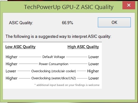

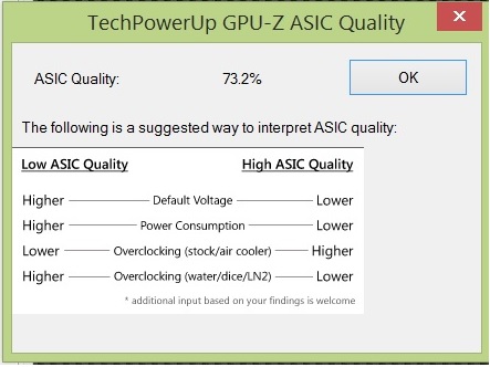

Both cards ASIC Quality?
Try  removing power cable and battery -> wait 5 minutes -> reinsert battery and power cable. Hopefully it's not temporary...

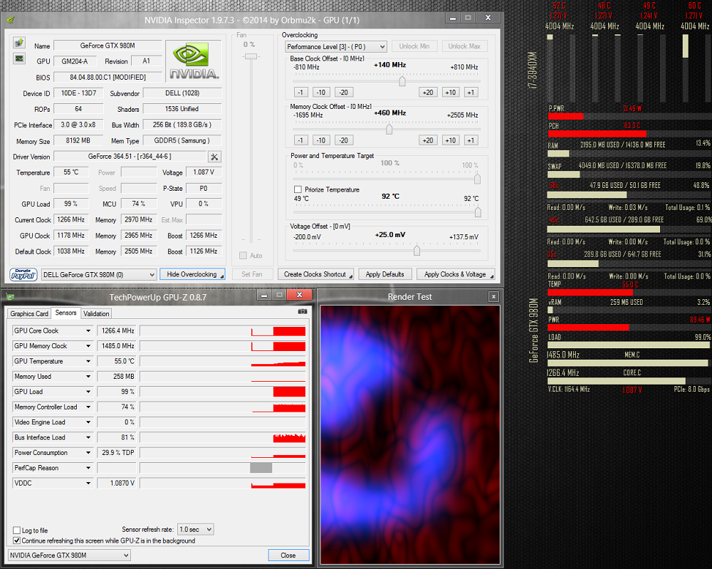

Valley best FPS since 350.12.  NV trying to compensate for previous drivers Fiasco...gimping performance?...:whistle:

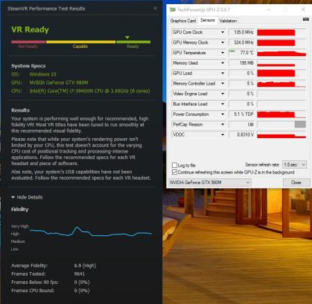

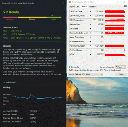

Yes, got the 120Hz screen now (the last upgrade this time). The 364.51 seems to work ok with no throttling for me too. I am running svl7 vbios though, not Prema version.
First screen is for 361.91, second one - 364.51. No throttle on both versions after restarts, power off/on as long as the battery is not removed, however I did not try cmos reset or PSU disconnect/battery removal yet.
