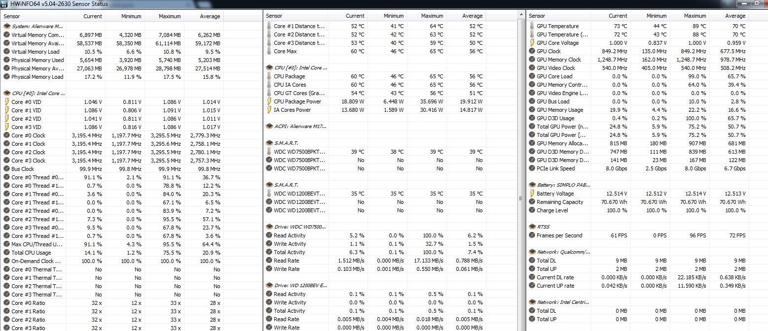

Fergus Posted October 6, 2015 Share Posted October 6, 2015 Goodnight everyone, now applied the AS5 folder (still can not get the gelid, but I'll buy) and my 104C CPU dropped to 65C ... great! My FPS Borderlands not go down under 55 with ALL the ultra inclusive Physix in High ... I thank the attention of everyone here! I'm just my GPU does not yet satifsfeito is with 84C (all in ultra) ... now I wonder, should I use overclocking to improve? which recommend? Quote Link to comment Share on other sites More sharing options...
TomJGX Posted October 6, 2015 Share Posted October 6, 2015 Goodnight everyone, now applied the AS5 folder (still can not get the gelid, but I'll buy) and my 104C CPU dropped to 65C ... great! My FPS Borderlands not go down under 55 with ALL the ultra inclusive Physix in High ...[ATTACH=CONFIG]16182[/ATTACH]I thank the attention of everyone here!I'm just my GPU does not yet satifsfeito is with 84C (all in ultra) ... now I wonder, should I use overclocking to improve? which recommend?Fergus stop overclocking... You will burn out your GPU... Have you applied new paste to GPU? If so temps are too high still.. Have you bought Gelid yet? Get some new thermal pads for GPU..Sent from my LG-H811 using Tapatalk Quote Link to comment Share on other sites More sharing options...
Fergus Posted October 6, 2015 Share Posted October 6, 2015 Fergus stop overclocking... You will burn out your GPU... Have you applied new paste to GPU? If so temps are too high still.. Have you bought Gelid yet? Get some new thermal pads for GPU..Sent from my LG-H811 using TapatalkHi Tom, yes already applied the paste and thermal pads all new, live where the temperature is already high, can not in any way lower the temp of my GPU ... I have no idea how to do this without being over control of the Season NV inspector ... CPU is reasonably good, but GPU would at most 70C, but never got, not with my old 675m = /Something else I can do? Quote Link to comment Share on other sites More sharing options...

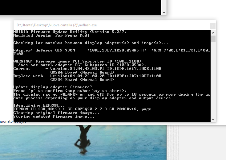

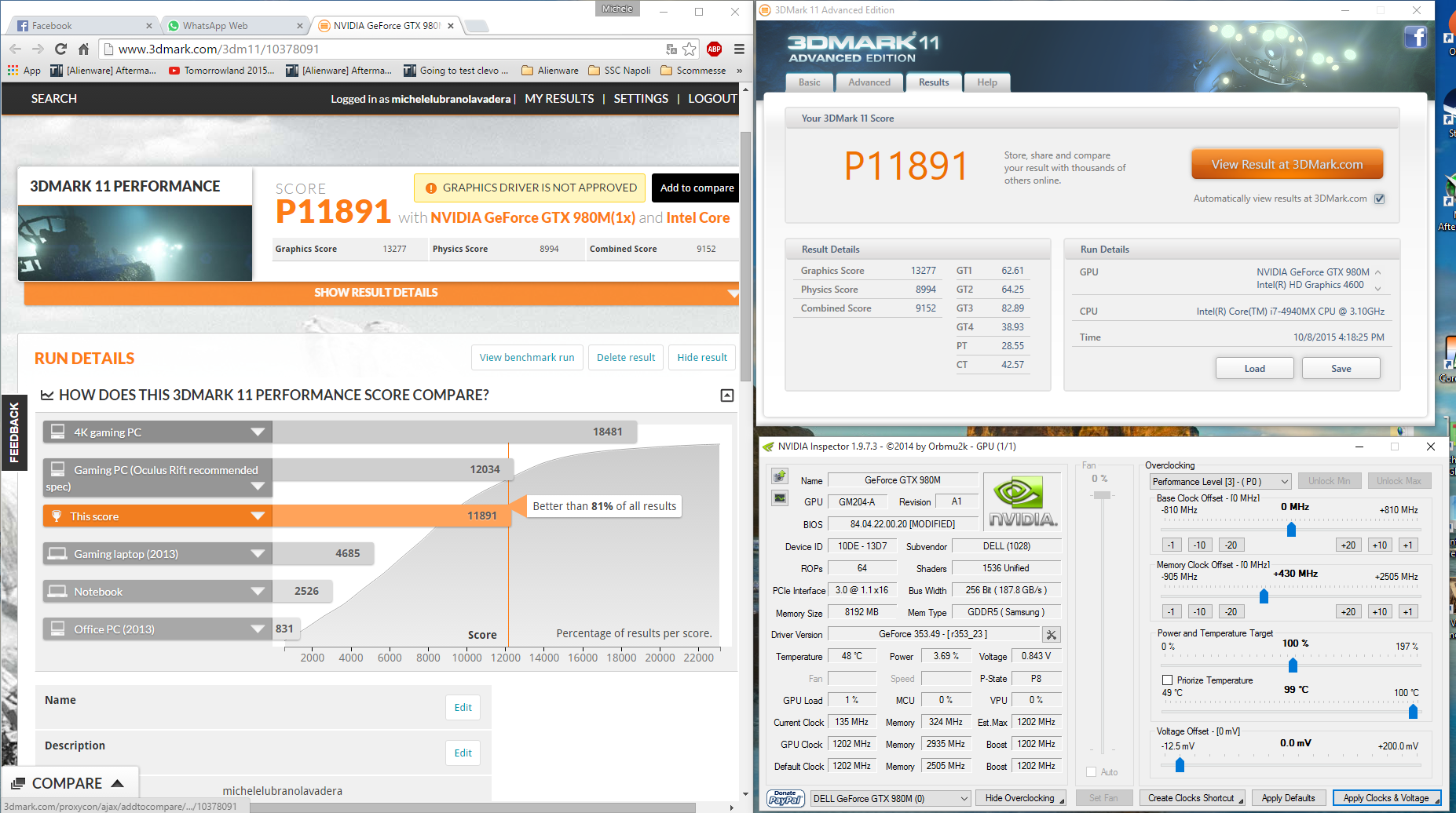

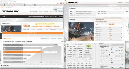

kelone Posted October 8, 2015 Share Posted October 8, 2015 The maximum settings I reached are 1344/2800 on the card using prema vbios. This configuration does 14,5k gpu score in 3dmark11. Above these limits card does not go and pops up an error. Regarding to the problem it may also be the card itself. Each card may have slightly different parameters. This is the maximum that I can get. 1202 MHz (1.00V) / 2935 mhz with the same frequencies if i increase 0.25V after a few minutes of benchmarks i have tdp error but if I put ram at 2000MHz i can be up to 1320 1.10v stable but have lower results in bencmark. seems that the card struggle to feed ram + gpu over a certain power. the gpu rises smoothly even 1350mhz only keeping the Rams to minimum. probably is a structural limit of the GPU Quote Link to comment Share on other sites More sharing options...
