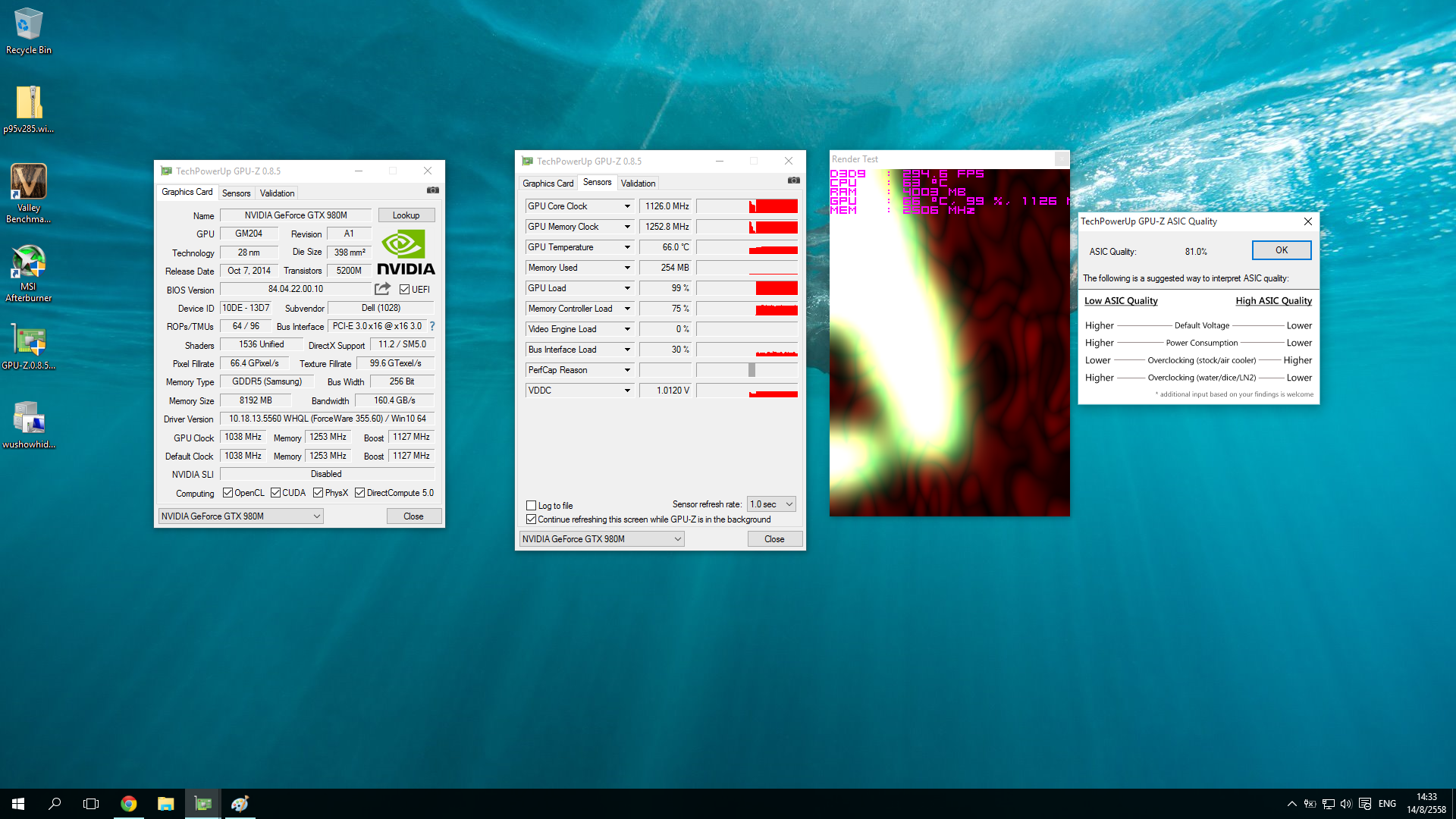

My vBIOS levels the GTX970M to a 3D base voltage of 0.9930v, this has been selected by looking at the average ASIC score of sold Clevo MXM cards.
If your card defaults above 0.993v with current vBIOS then its ASIC is below average (65.5-68.5% range) and it would use the same higher voltage as on a stock vBIOS.

@Mr. Fox Due to voltage throttling VDDC/3D readings weren't accurate, please repeat the GPU-Z render test, both cards. Like above run each card at a time.
Thx
Better late than never. Sorry, with everything going on at work and wife's surgery, etc. I just totally forgot. Stock vBIOS as requested.
