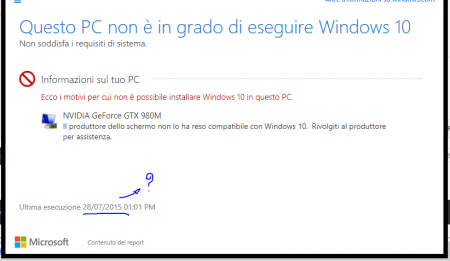

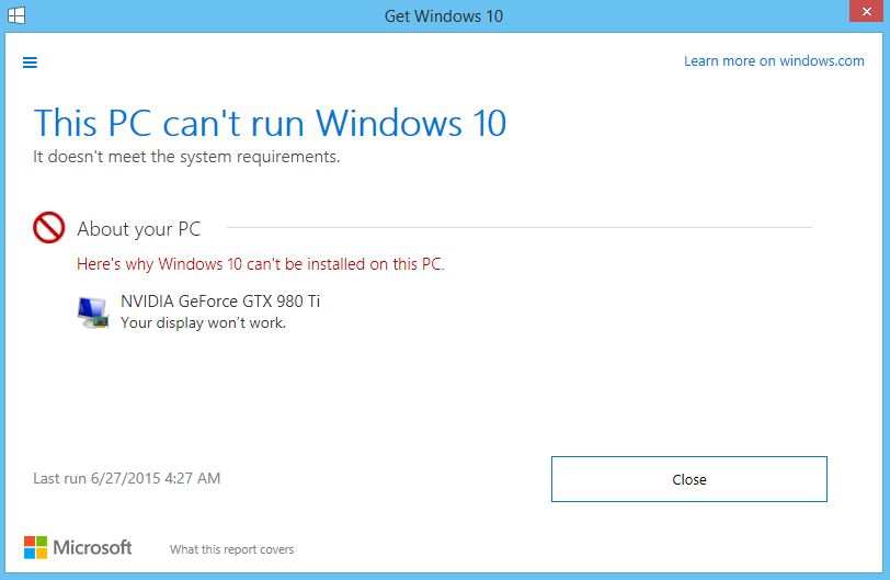

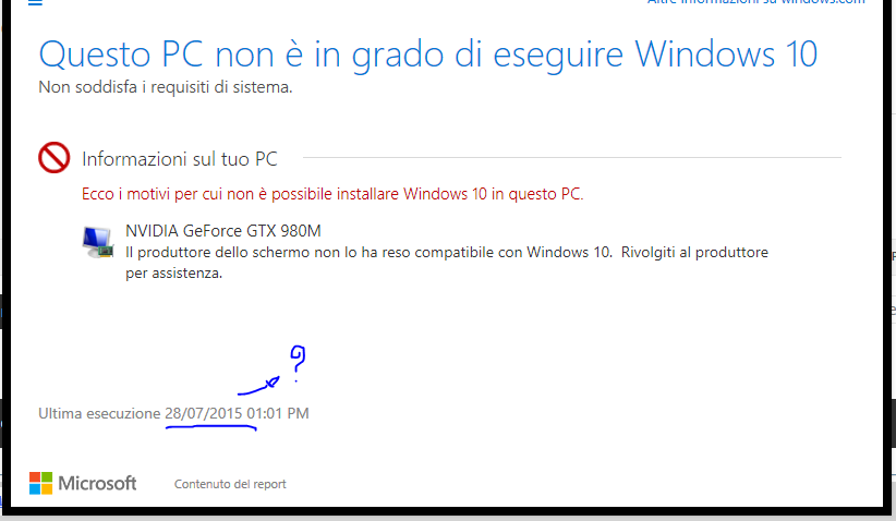

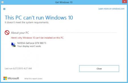

I'm getting this error but instead of 980 Ti it says 980M, is there anyway of fixing that?
[ATTACH=CONFIG]15669[/ATTACH]
Thank you
Uninstall the modded driver from device manager and restart the PC. I had the exact same error when upgrading from 8.1.
Got Win 10 along with all the Drivers installed on my M18Xr2 with dual GTX980m's. Works perfectly apart from locking up on cold boot tho powering it off and turning it on again gets it to boot normally. Dont suppose anyone knows a way to fix that? Its not present on the 350.12 drivers on windows 8.1.
Same problem as miguel. Can't update to 10. Tried to unistall driver...but same problem. Any news?
Unistalled everything from device manager and using DDU...what am I doing wrong? T_T
Nothing, all should be good to go. You might want to force Windows to recheck your laptop for Windows 10 compatibility:
Win+X, then a (it will open cmd as admin), paste this:
schtasks.exe /Run /TN "\Microsoft\Windows\Application Experience\Microsoft Compatibility Appraiser"
Hit enter and then open 'get Windows 10' app, it should have a new report waiting and saying you can install windows now. You might need to check for available updates in Windows update.
unfortunately it didn't work..... I don't understand why.... :( It doesn't seem to do nothing at all..post-32148-14495000619631_thumb.png ( I have windows 8.1)
EDIT
I did it!!!!! Windows 10!!! ^ ^ ( <code>wuauclt.exe /updatenow)</code>
