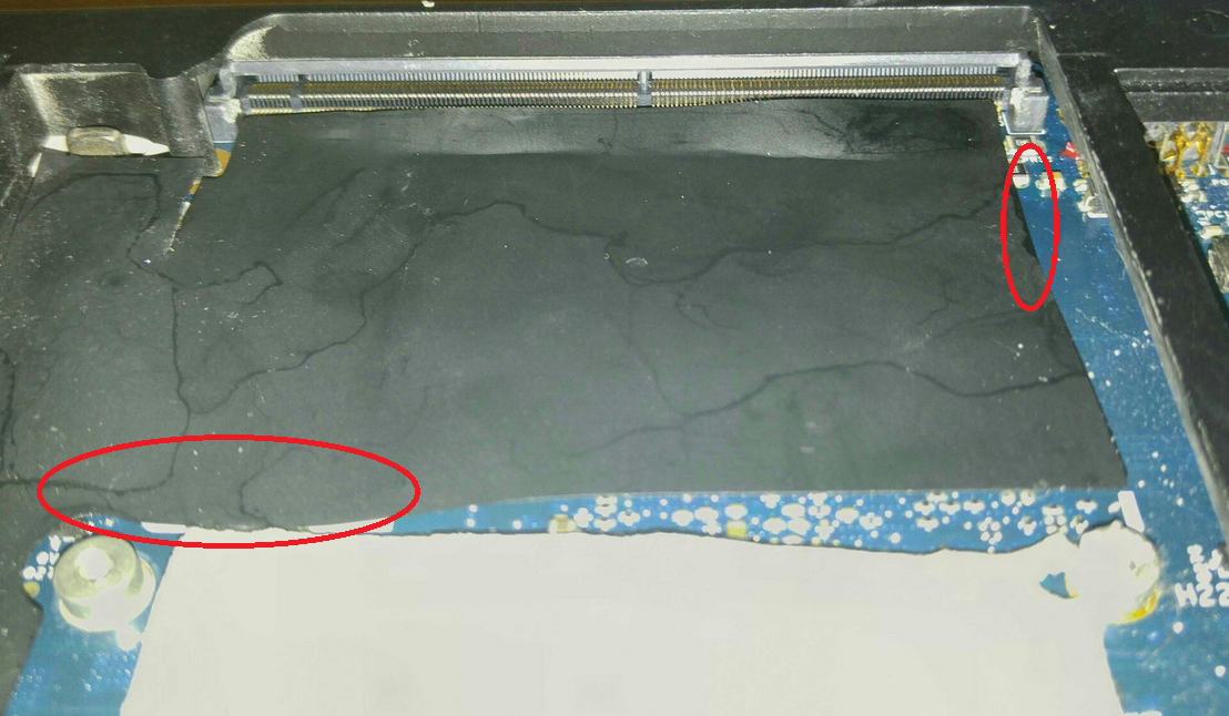

TomJGX Posted July 30, 2015 Share Posted July 30, 2015 Yep, looks fine. What have you been drying there...? What do you mean? I blew some compressed air earlier and dried it out.. Can't do much more Sent from my LG-H811 using Tapatalk Quote Link to comment Share on other sites More sharing options...
J95 Posted July 30, 2015 Author Share Posted July 30, 2015 What do you mean? I blew some compressed air earlier and dried it out.. Can't do much moreSent from my LG-H811 using Tapatalk Nothing serious... just keep reseating the card, 2 screws only no need to remove the heat sink. Quote Link to comment Share on other sites More sharing options...
TomJGX Posted July 30, 2015 Share Posted July 30, 2015 Nothing serious... just keep reasiting the card, 2 screws only no need to remove the heat sink. Did a full removal and reset.. Didn't work... Trying your 2 screws trick.. Sent from my LG-H811 using Tapatalk Quote Link to comment Share on other sites More sharing options...

J95 Posted July 30, 2015 Author Share Posted July 30, 2015 Did a full removal and reset.. Didn't work... Trying your 2 screws trick..Sent from my LG-H811 using TapatalkStrange thing is card is kind off working, drivers install but now getting code 43.. Its detected by gpuz etc.. If the Code 43 persists , run DDU and re-install drivers. F8 'DSE'. Quote Link to comment Share on other sites More sharing options...
mw86 Posted July 30, 2015 Share Posted July 30, 2015 What do you mean? I blew some compressed air earlier and dried it out.. Can't do much moreSent from my LG-H811 using Tapatalkis this the compressed gas in a can? We noticed the remnants of liquid that evaporated. If its one of those gas based cans if they are used at an angle they start to spray propellent that evaporates quickly but is very cold. This was on the insulating black plastic in the picture. If so did anything else get wet with propellant before evaporating? 1 Quote Link to comment Share on other sites More sharing options...

TomJGX Posted July 30, 2015 Share Posted July 30, 2015 Guys I have done everything... Something is weird or the card is kaput.. Have reset it quite a few times etc however God knows what the issue.. Trying to install drivers one last time then I will RMA once hide gets off their arses and sends me the info.Sent from my LG-H811 using Tapatalk 1 Quote Link to comment Share on other sites More sharing options...
