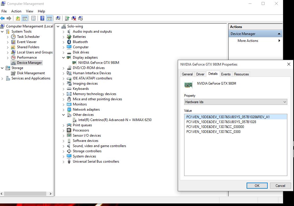

I'm also having issues with XTU installation. Followed the steps twice but no dice.
I have an M17x R4 with 120Hz and 980m.
For the drivers, I must've tried every single ****ing driver out there and each one is throttling like a bit**! (Nvidia ! the way it's meant to be throttled)
Flashed Prema's 1.1 Vbios -> made matters worse with every driver I could get : 34x.xx - 352.84 - 353.xx
Flashed svl7 vbios -> With wooodzstack 352.84 no throttling for the core at all. As for the memory, it throttles from 2500 to 1600 but I managed to fix it by matching the states P0,P1 -->>>> So no throttling at all :)
However, when I modify the voltage, PT, core. Throttling occurs:grumpy:
Here are my hwids:
I get this at installing visual 9.0 (the rest are fine though)
A compatible version of Visual Studio 2008 was not detected on the system. This update is designed for only the Microsoft Visual Studio 2008 (ENU) product family, and is not compatible with any Express editions.
And if I forget about Visual (I have tried to find and install the redistributable, seems to not work properly) XTU still gives the same errors, it just keeps try and trying, I have to cancel it myself, because it says it can not start the XTU3Service.
Afaik, I followed the instructions to the letter. Also, from a fresh install.
