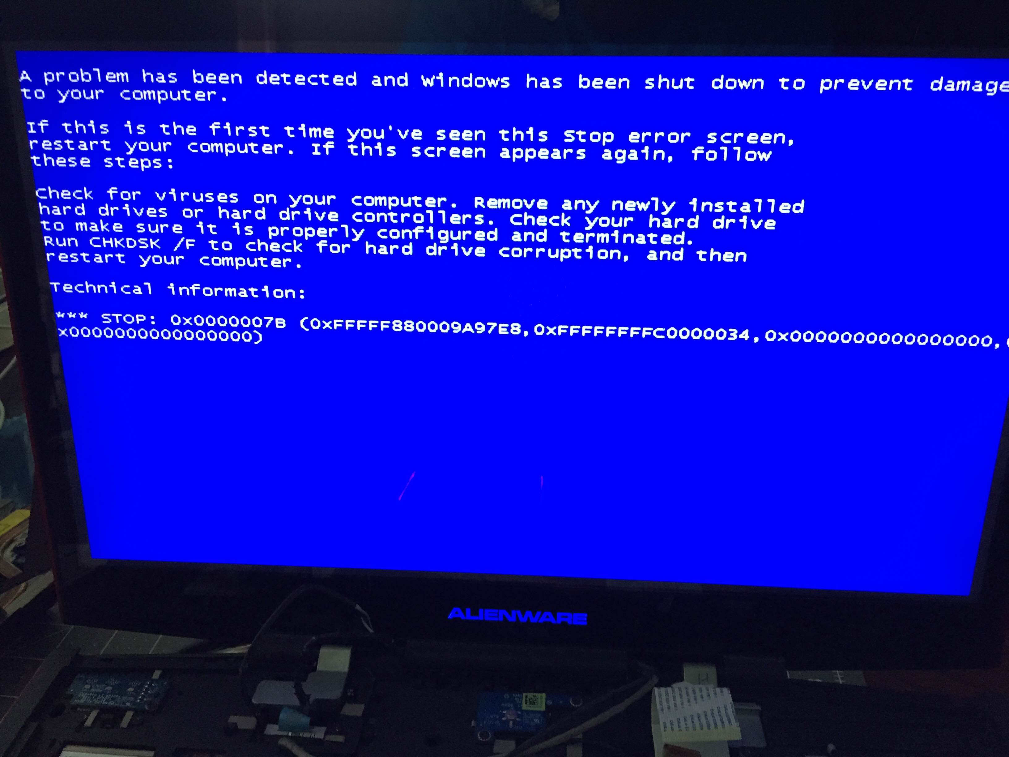

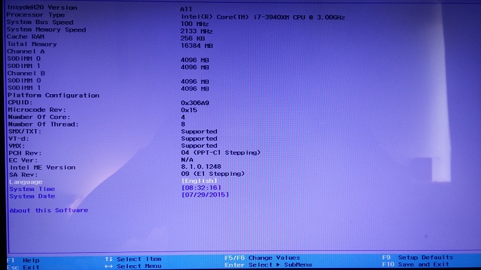

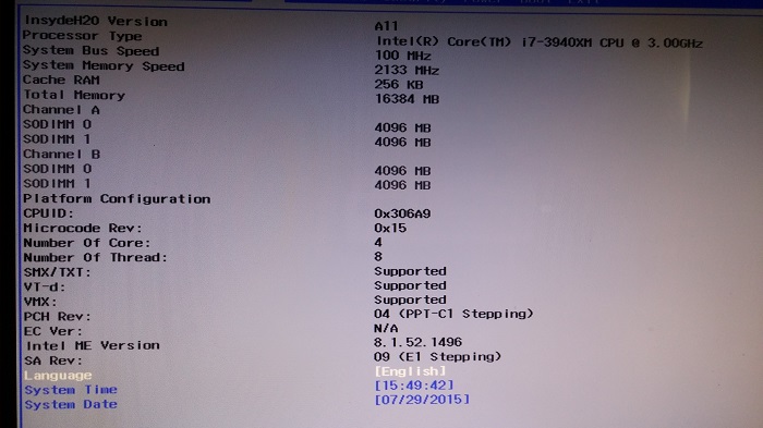

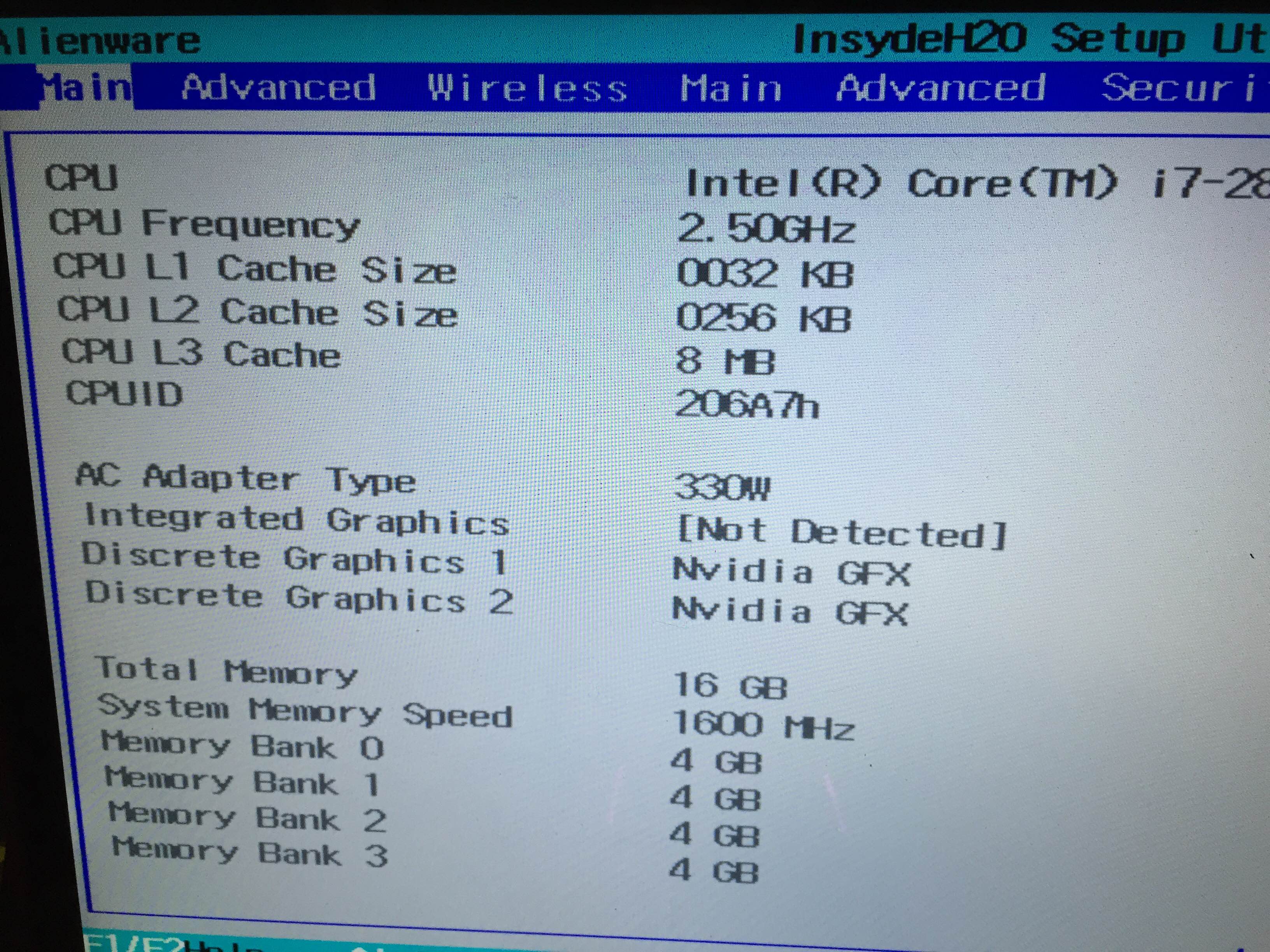

aricww Posted July 29, 2015 Share Posted July 29, 2015 @J95 I'm having difficulties upgrading my m18xr1 video cardto dual 860m's or even a single 860m. On boot I get a blue screen followed by reboot; safe mode doesn't help. I've uninstalled all video/graphics drivers and tried both the unlocked 03 & 05 drivers and both video cards. I can only seem to get the laptopto boot with internal or 560m installed. I was told you might be able to help.... I've read your previous posts and followed your instructions; however, I can never get past the compatibility check with the Nvidia drivers. One thing I did notice is that while the bios seems to recognize the cards as Nvidia Graphics cards. The bios doesn't seem to know that they are 860m's , while with the old cards it does identify them as 560m's .. if that makes any sense...maybe that isn't helpful. Thanks in advance! Quote Link to comment Share on other sites More sharing options...

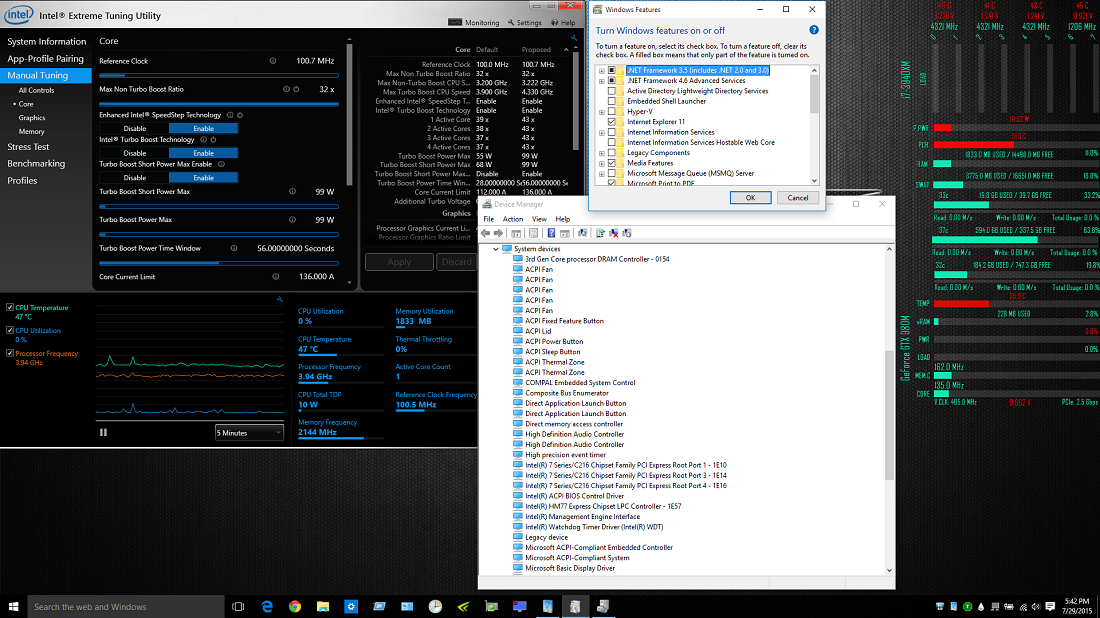

Lee James Wood Posted July 29, 2015 Share Posted July 29, 2015 I can't friggin get Microsoft Visual Studio 2008 part to install. I have uninstalled all visual studio's and re-installed, but I can not get the SP1 update for 2008 to install. The others, no problem. Anyways, XTU still does not install. Guessing it really needs the Visual Studio 2k8I get the usual :XTU3Service could not be installed[0D98:278C][2015-07-29T14:19:17]: Burn v3.6.2803.0, Windows v6.2 (Build 9200: Service Pack 0), path: C:\Users\woodz\Downloads\XTU-Setup-exe (1).exe, cmdline: '-burn.unelevated BurnPipe.{44FC2431-B94B-467B-BB37-8A8189B1BCE7} {6276C6FB-B86C-49A9-8948-CA97B7FC9748} 10352'[0D98:278C][2015-07-29T14:19:17]: Initializing string variable 'RemoveAllDataCheckboxValue' to value '[RemoveAllDataCheckbox]'[0D98:278C][2015-07-29T14:19:17]: Setting string variable 'WixBundleLog' to value 'C:\Users\woodz\AppData\Local\Temp\Intel_Extreme_Tuning_Utility_20150729141917.log'[0D98:278C][2015-07-29T14:19:17]: Setting string variable 'WixBundleOriginalSource' to value 'C:\Users\woodz\Downloads\XTU-Setup-exe (1).exe'[0D98:278C][2015-07-29T14:19:17]: Condition 'VersionNT >= v6.1' evaluates to true.[0D98:278C][2015-07-29T14:19:17]: Setting string variable 'WixBundleName' to value 'Intel Extreme Tuning Utility'[0D98:278C][2015-07-29T14:19:17]: Detect 4 packages[0D98:278C][2015-07-29T14:19:17]: Detected package: MEISetup.exe, state: Absent, cached: Complete[0D98:278C][2015-07-29T14:19:17]: Detected package: SSCERuntime_x86_ENU.msi, state: Present, cached: Complete[0D98:278C][2015-07-29T14:19:17]: Detected package: SSCERuntime_x64_ENU.msi, state: Present, cached: Complete[0D98:278C][2015-07-29T14:19:17]: Detected package: XTU_Setup.msi, state: Absent, cached: Complete[0D98:278C][2015-07-29T14:19:17]: Detect complete, result: 0x0[0D98:278C][2015-07-29T14:19:19]: Plan 4 packages, action: Install[0D98:278C][2015-07-29T14:19:19]: Skipping dependency registration on package with no dependency providers: MEISetup.exe[0D98:278C][2015-07-29T14:19:19]: Setting string variable 'WixBundleLog_MEISetup.exe' to value 'C:\Users\woodz\AppData\Local\Temp\Intel_Extreme_Tuning_Utility_20150729141917_0_MEISetup.exe.log'[0D98:278C][2015-07-29T14:19:19]: Condition 'VersionNT64' evaluates to true.[0D98:278C][2015-07-29T14:19:19]: Setting string variable 'WixBundleRollbackLog_XTU_Setup.msi' to value 'C:\Users\woodz\AppData\Local\Temp\Intel_Extreme_Tuning_Utility_20150729141917_1_XTU_Setup.msi_rollback.log'[0D98:278C][2015-07-29T14:19:19]: Setting string variable 'WixBundleLog_XTU_Setup.msi' to value 'C:\Users\woodz\AppData\Local\Temp\Intel_Extreme_Tuning_Utility_20150729141917_1_XTU_Setup.msi.log'[0D98:278C][2015-07-29T14:19:19]: Planned package: MEISetup.exe, state: Absent, default requested: Present, ba requested: Present, execute: Install, rollback: None, cache: No, uncache: No, dependency: None[0D98:278C][2015-07-29T14:19:19]: Planned package: SSCERuntime_x86_ENU.msi, state: Present, default requested: Present, ba requested: Present, execute: None, rollback: None, cache: No, uncache: No, dependency: Register[0D98:278C][2015-07-29T14:19:19]: Planned package: SSCERuntime_x64_ENU.msi, state: Present, default requested: Present, ba requested: Present, execute: None, rollback: None, cache: No, uncache: No, dependency: Register[0D98:278C][2015-07-29T14:19:19]: Planned package: XTU_Setup.msi, state: Absent, default requested: Present, ba requested: Present, execute: Install, rollback: Uninstall, cache: No, uncache: No, dependency: Register[0D98:278C][2015-07-29T14:19:19]: Plan complete, result: 0x0[0D98:278C][2015-07-29T14:19:19]: Apply begin[2870:298C][2015-07-29T14:19:19]: Automatic updates could not be paused due to error: 0x80040154. Continuing...[2870:298C][2015-07-29T14:19:19]: Creating a system restore point.[2870:298C][2015-07-29T14:19:19]: Created a system restore point.[2870:298C][2015-07-29T14:19:19]: Caching bundle from: 'C:\Users\woodz\AppData\Local\Temp\{c39ccdf6-4cad-48b9-87d8-00131589afca}\.be\xtu-setup-exe.exe' to: 'C:\ProgramData\Package Cache\{c39ccdf6-4cad-48b9-87d8-00131589afca}\xtu-setup-exe.exe'[2870:298C][2015-07-29T14:19:19]: Registering bundle dependency provider: {c39ccdf6-4cad-48b9-87d8-00131589afca}, version: 5.2.0.14[2870:272C][2015-07-29T14:19:19]: Verified existing payload: MEISetup.exe at path: C:\ProgramData\Package Cache\2EA0148C3093F7D274187E971810A7ECE7144803\MEISetup.exe.[2870:272C][2015-07-29T14:19:20]: Verified existing payload: XTU_Setup.msi at path: C:\ProgramData\Package Cache\{02874FB3-3E27-4A14-96B8-1562F5A04A31}v5.2.0.14\XTU-Setup.msi.[2870:298C][2015-07-29T14:19:20]: Applying execute package: MEISetup.exe, action: Install, path: C:\ProgramData\Package Cache\2EA0148C3093F7D274187E971810A7ECE7144803\MEISetup.exe, arguments: '"C:\ProgramData\Package Cache\2EA0148C3093F7D274187E971810A7ECE7144803\MEISetup.exe" -s'[2870:298C][2015-07-29T14:19:20]: Registering dependency: {c39ccdf6-4cad-48b9-87d8-00131589afca} on package provider: {3A9FC03D-C685-4831-94CF-4EDFD3749497}, package: SSCERuntime_x86_ENU.msi[2870:298C][2015-07-29T14:19:20]: Registering dependency: {c39ccdf6-4cad-48b9-87d8-00131589afca} on package provider: {D4AD39AD-091E-4D33-BB2B-59F6FCB8ADC3}, package: SSCERuntime_x64_ENU.msi[2870:298C][2015-07-29T14:19:20]: Applying execute package: XTU_Setup.msi, action: Install, path: C:\ProgramData\Package Cache\{02874FB3-3E27-4A14-96B8-1562F5A04A31}v5.2.0.14\XTU-Setup.msi, arguments: ' ARPSYSTEMCOMPONENT="1" MSIFASTINSTALL="7" REMOVEALLAPPDATA=""'[2870:298C][2015-07-29T14:19:47]: Error 0x80070643: Failed to install MSI package.[2870:298C][2015-07-29T14:19:47]: Error 0x80070643: Failed to execute MSI package.[0D98:278C][2015-07-29T14:19:47]: Error 0x80070643: Failed to configure per-machine MSI package.[0D98:278C][2015-07-29T14:19:47]: Application requested retry of package: XTU_Setup.msi, encountered error: 0x80070643. Retrying...[2870:298C][2015-07-29T14:19:50]: Applying execute package: XTU_Setup.msi, action: Install, path: C:\ProgramData\Package Cache\{02874FB3-3E27-4A14-96B8-1562F5A04A31}v5.2.0.14\XTU-Setup.msi, arguments: ' ARPSYSTEMCOMPONENT="1" MSIFASTINSTALL="7" REMOVEALLAPPDATA=""'[2870:298C][2015-07-29T14:20:12]: Error 0x80070643: Failed to install MSI package.[2870:298C][2015-07-29T14:20:12]: Error 0x80070643: Failed to execute MSI package.[0D98:278C][2015-07-29T14:20:12]: Error 0x80070643: Failed to configure per-machine MSI package.[0D98:278C][2015-07-29T14:20:12]: Application requested retry of package: XTU_Setup.msi, encountered error: 0x80070643. Retrying...[0D98:278C][2015-07-29T14:20:16]: Error 0x80070642: UX aborted execute MSI package begin.[0D98:278C][2015-07-29T14:20:16]: Error 0x80070642: Failed to execute MSI package.[2870:298C][2015-07-29T14:20:16]: Skipped rollback of package: XTU_Setup.msi, action: Uninstall, already: Absent[2870:298C][2015-07-29T14:20:16]: Removing dependency: {c39ccdf6-4cad-48b9-87d8-00131589afca} on package provider: {D4AD39AD-091E-4D33-BB2B-59F6FCB8ADC3}, package SSCERuntime_x64_ENU.msi[2870:298C][2015-07-29T14:20:16]: Removing dependency: {c39ccdf6-4cad-48b9-87d8-00131589afca} on package provider: {3A9FC03D-C685-4831-94CF-4EDFD3749497}, package SSCERuntime_x86_ENU.msi[2870:298C][2015-07-29T14:20:16]: Removing bundle dependency provider: {c39ccdf6-4cad-48b9-87d8-00131589afca}[2870:298C][2015-07-29T14:20:16]: Removing cached bundle: {c39ccdf6-4cad-48b9-87d8-00131589afca}, from path: C:\ProgramData\Package Cache\{c39ccdf6-4cad-48b9-87d8-00131589afca}\[0D98:278C][2015-07-29T14:20:16]: Apply complete, result: 0x80070642, restart: None, ba requested restart: No Quote Link to comment Share on other sites More sharing options...
TomJGX Posted July 29, 2015 Share Posted July 29, 2015 I can't friggin get Microsoft Visual Studio 2008 part to install. I have uninstalled all visual studio's and re-installed, but I can not get the SP1 update for 2008 to install. The others, no problem. Anyways, XTU still does not install. Guessing it really needs the Visual Studio 2k8I get the usual :XTU3Service could not be installed[0D98:278C][2015-07-29T14:19:17]: Burn v3.6.2803.0, Windows v6.2 (Build 9200: Service Pack 0), path: C:\Users\woodz\Downloads\XTU-Setup-exe (1).exe, cmdline: '-burn.unelevated BurnPipe.{44FC2431-B94B-467B-BB37-8A8189B1BCE7} {6276C6FB-B86C-49A9-8948-CA97B7FC9748} 10352'[0D98:278C][2015-07-29T14:19:17]: Initializing string variable 'RemoveAllDataCheckboxValue' to value '[RemoveAllDataCheckbox]'[0D98:278C][2015-07-29T14:19:17]: Setting string variable 'WixBundleLog' to value 'C:\Users\woodz\AppData\Local\Temp\Intel_Extreme_Tuning_Utility_20150729141917.log'[0D98:278C][2015-07-29T14:19:17]: Setting string variable 'WixBundleOriginalSource' to value 'C:\Users\woodz\Downloads\XTU-Setup-exe (1).exe'[0D98:278C][2015-07-29T14:19:17]: Condition 'VersionNT >= v6.1' evaluates to true.[0D98:278C][2015-07-29T14:19:17]: Setting string variable 'WixBundleName' to value 'Intel Extreme Tuning Utility'[0D98:278C][2015-07-29T14:19:17]: Detect 4 packages[0D98:278C][2015-07-29T14:19:17]: Detected package: MEISetup.exe, state: Absent, cached: Complete[0D98:278C][2015-07-29T14:19:17]: Detected package: SSCERuntime_x86_ENU.msi, state: Present, cached: Complete[0D98:278C][2015-07-29T14:19:17]: Detected package: SSCERuntime_x64_ENU.msi, state: Present, cached: Complete[0D98:278C][2015-07-29T14:19:17]: Detected package: XTU_Setup.msi, state: Absent, cached: Complete[0D98:278C][2015-07-29T14:19:17]: Detect complete, result: 0x0[0D98:278C][2015-07-29T14:19:19]: Plan 4 packages, action: Install[0D98:278C][2015-07-29T14:19:19]: Skipping dependency registration on package with no dependency providers: MEISetup.exe[0D98:278C][2015-07-29T14:19:19]: Setting string variable 'WixBundleLog_MEISetup.exe' to value 'C:\Users\woodz\AppData\Local\Temp\Intel_Extreme_Tuning_Utility_20150729141917_0_MEISetup.exe.log'[0D98:278C][2015-07-29T14:19:19]: Condition 'VersionNT64' evaluates to true.[0D98:278C][2015-07-29T14:19:19]: Setting string variable 'WixBundleRollbackLog_XTU_Setup.msi' to value 'C:\Users\woodz\AppData\Local\Temp\Intel_Extreme_Tuning_Utility_20150729141917_1_XTU_Setup.msi_rollback.log'[0D98:278C][2015-07-29T14:19:19]: Setting string variable 'WixBundleLog_XTU_Setup.msi' to value 'C:\Users\woodz\AppData\Local\Temp\Intel_Extreme_Tuning_Utility_20150729141917_1_XTU_Setup.msi.log'[0D98:278C][2015-07-29T14:19:19]: Planned package: MEISetup.exe, state: Absent, default requested: Present, ba requested: Present, execute: Install, rollback: None, cache: No, uncache: No, dependency: None[0D98:278C][2015-07-29T14:19:19]: Planned package: SSCERuntime_x86_ENU.msi, state: Present, default requested: Present, ba requested: Present, execute: None, rollback: None, cache: No, uncache: No, dependency: Register[0D98:278C][2015-07-29T14:19:19]: Planned package: SSCERuntime_x64_ENU.msi, state: Present, default requested: Present, ba requested: Present, execute: None, rollback: None, cache: No, uncache: No, dependency: Register[0D98:278C][2015-07-29T14:19:19]: Planned package: XTU_Setup.msi, state: Absent, default requested: Present, ba requested: Present, execute: Install, rollback: Uninstall, cache: No, uncache: No, dependency: Register[0D98:278C][2015-07-29T14:19:19]: Plan complete, result: 0x0[0D98:278C][2015-07-29T14:19:19]: Apply begin[2870:298C][2015-07-29T14:19:19]: Automatic updates could not be paused due to error: 0x80040154. Continuing...[2870:298C][2015-07-29T14:19:19]: Creating a system restore point.[2870:298C][2015-07-29T14:19:19]: Created a system restore point.[2870:298C][2015-07-29T14:19:19]: Caching bundle from: 'C:\Users\woodz\AppData\Local\Temp\{c39ccdf6-4cad-48b9-87d8-00131589afca}\.be\xtu-setup-exe.exe' to: 'C:\ProgramData\Package Cache\{c39ccdf6-4cad-48b9-87d8-00131589afca}\xtu-setup-exe.exe'[2870:298C][2015-07-29T14:19:19]: Registering bundle dependency provider: {c39ccdf6-4cad-48b9-87d8-00131589afca}, version: 5.2.0.14[2870:272C][2015-07-29T14:19:19]: Verified existing payload: MEISetup.exe at path: C:\ProgramData\Package Cache\2EA0148C3093F7D274187E971810A7ECE7144803\MEISetup.exe.[2870:272C][2015-07-29T14:19:20]: Verified existing payload: XTU_Setup.msi at path: C:\ProgramData\Package Cache\{02874FB3-3E27-4A14-96B8-1562F5A04A31}v5.2.0.14\XTU-Setup.msi.[2870:298C][2015-07-29T14:19:20]: Applying execute package: MEISetup.exe, action: Install, path: C:\ProgramData\Package Cache\2EA0148C3093F7D274187E971810A7ECE7144803\MEISetup.exe, arguments: '"C:\ProgramData\Package Cache\2EA0148C3093F7D274187E971810A7ECE7144803\MEISetup.exe" -s'[2870:298C][2015-07-29T14:19:20]: Registering dependency: {c39ccdf6-4cad-48b9-87d8-00131589afca} on package provider: {3A9FC03D-C685-4831-94CF-4EDFD3749497}, package: SSCERuntime_x86_ENU.msi[2870:298C][2015-07-29T14:19:20]: Registering dependency: {c39ccdf6-4cad-48b9-87d8-00131589afca} on package provider: {D4AD39AD-091E-4D33-BB2B-59F6FCB8ADC3}, package: SSCERuntime_x64_ENU.msi[2870:298C][2015-07-29T14:19:20]: Applying execute package: XTU_Setup.msi, action: Install, path: C:\ProgramData\Package Cache\{02874FB3-3E27-4A14-96B8-1562F5A04A31}v5.2.0.14\XTU-Setup.msi, arguments: ' ARPSYSTEMCOMPONENT="1" MSIFASTINSTALL="7" REMOVEALLAPPDATA=""'[2870:298C][2015-07-29T14:19:47]: Error 0x80070643: Failed to install MSI package.[2870:298C][2015-07-29T14:19:47]: Error 0x80070643: Failed to execute MSI package.[0D98:278C][2015-07-29T14:19:47]: Error 0x80070643: Failed to configure per-machine MSI package.[0D98:278C][2015-07-29T14:19:47]: Application requested retry of package: XTU_Setup.msi, encountered error: 0x80070643. Retrying...[2870:298C][2015-07-29T14:19:50]: Applying execute package: XTU_Setup.msi, action: Install, path: C:\ProgramData\Package Cache\{02874FB3-3E27-4A14-96B8-1562F5A04A31}v5.2.0.14\XTU-Setup.msi, arguments: ' ARPSYSTEMCOMPONENT="1" MSIFASTINSTALL="7" REMOVEALLAPPDATA=""'[2870:298C][2015-07-29T14:20:12]: Error 0x80070643: Failed to install MSI package.[2870:298C][2015-07-29T14:20:12]: Error 0x80070643: Failed to execute MSI package.[0D98:278C][2015-07-29T14:20:12]: Error 0x80070643: Failed to configure per-machine MSI package.[0D98:278C][2015-07-29T14:20:12]: Application requested retry of package: XTU_Setup.msi, encountered error: 0x80070643. Retrying...[0D98:278C][2015-07-29T14:20:16]: Error 0x80070642: UX aborted execute MSI package begin.[0D98:278C][2015-07-29T14:20:16]: Error 0x80070642: Failed to execute MSI package.[2870:298C][2015-07-29T14:20:16]: Skipped rollback of package: XTU_Setup.msi, action: Uninstall, already: Absent[2870:298C][2015-07-29T14:20:16]: Removing dependency: {c39ccdf6-4cad-48b9-87d8-00131589afca} on package provider: {D4AD39AD-091E-4D33-BB2B-59F6FCB8ADC3}, package SSCERuntime_x64_ENU.msi[2870:298C][2015-07-29T14:20:16]: Removing dependency: {c39ccdf6-4cad-48b9-87d8-00131589afca} on package provider: {3A9FC03D-C685-4831-94CF-4EDFD3749497}, package SSCERuntime_x86_ENU.msi[2870:298C][2015-07-29T14:20:16]: Removing bundle dependency provider: {c39ccdf6-4cad-48b9-87d8-00131589afca}[2870:298C][2015-07-29T14:20:16]: Removing cached bundle: {c39ccdf6-4cad-48b9-87d8-00131589afca}, from path: C:\ProgramData\Package Cache\{c39ccdf6-4cad-48b9-87d8-00131589afca}\[0D98:278C][2015-07-29T14:20:16]: Apply complete, result: 0x80070642, restart: None, ba requested restart: NoXTU installed.. Have the latest version however getting the 0Hz processor reading bug... Quote Link to comment Share on other sites More sharing options...
Lee James Wood Posted July 29, 2015 Share Posted July 29, 2015 At least you can get it installed. I can't get Visual 2008 SP1 installed or XTU.. Quote Link to comment Share on other sites More sharing options...
TomJGX Posted July 29, 2015 Share Posted July 29, 2015 At least you can get it installed. I can't get Visual 2008 SP1 installed or XTU..See J95's above post of the 353.62 driver... He's given a fix for XTU...Also @J95 thanks for the mod, will report of the performance later.... Quote Link to comment Share on other sites More sharing options...
Lee James Wood Posted July 29, 2015 Share Posted July 29, 2015 See J95's above post of the 353.62 driver... He's given a fix for XTU...Also @J95 thanks for the mod, will report of the performance later....what I'm saying is the fix, has not worked. Quote Link to comment Share on other sites More sharing options...

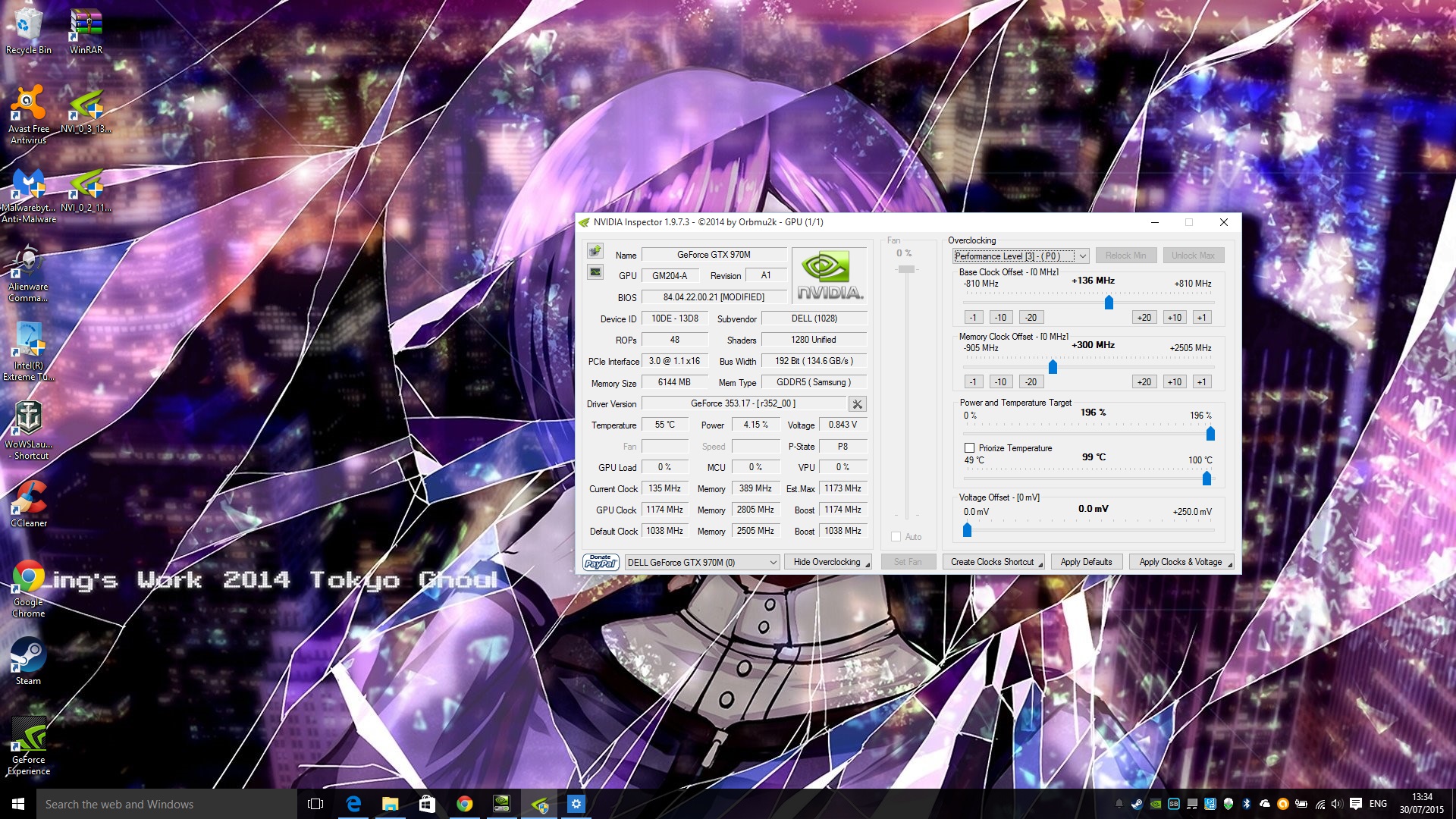

TomJGX Posted July 29, 2015 Share Posted July 29, 2015 @J95 the nvdisp file is a total fail.. Drivers install but for any game GPU is stuck at lowest power setting... it doesn't ramp up at all.. Memory usage is like <100mb.. Trying ncvif or whatever the other one is..Edit: Have tried both, no difference. Drivers install however whenever I run game, GPU is stuck at lowest power setting which is 135/500 or something...I even reinstalled Windows 10 since it was installed in a Legacy manner earlier and made it UEFI but I am lost and don't know what else to do... @Lee James Wood, have you come across this bug or whatever? Quote Link to comment Share on other sites More sharing options...

TomJGX Posted July 30, 2015 Share Posted July 30, 2015 Disable DSE, then re-install.Try my driver : https://www.dropbox.com/sh/46rritxlkhd0270/AAAYLmGI8lonNsXGfH-Rkvmsa?dl=0(I think your on a M17X-R4, right ?)I'll try yours... I tried the modded inf from laptopvideo2go and hardly any better.. It seems no memory is being used by the GPU and clocks are stuck on low P-state... Wtf has NVIDIA released.. POS driver.. J95's inf mod is dead on and it installs etc but something is fundamentally wrong with this driver... Quote Link to comment Share on other sites More sharing options...
Lee James Wood Posted July 30, 2015 Share Posted July 30, 2015 I'll try yours... I tried the modded inf from laptopvideo2go and hardly any better.. It seems no memory is being used by the GPU and clocks are stuck on low P-state... Wtf has NVIDIA released.. POS driver.. J95's inf mod is dead on and it installs etc but something is fundamentally wrong with this driver...Thats exactly it though, that works for windows 7 and windows 8, but not windows 10, which I suspect you are using. (did you say you were on win 10 ?) Quote Link to comment Share on other sites More sharing options...
TomJGX Posted July 30, 2015 Share Posted July 30, 2015 Thats exactly it though, that works for windows 7 and windows 8, but not windows 10, which I suspect you are using. (did you say you were on win 10 ?)I am on 10... Nothing is working.. Their inf is for 10 too..Sent from my LG-H811 using Tapatalk Quote Link to comment Share on other sites More sharing options...

J95 Posted July 30, 2015 Author Share Posted July 30, 2015 @J95 I'm having difficulties upgrading my m18xr1 video cardto dual 860m's or even a single 860m. On boot I get a blue screen followed by reboot; safe mode doesn't help. I've uninstalled all video/graphics drivers and tried both the unlocked 03 & 05 drivers and both video cards. I can only seem to get the laptopto boot with internal or 560m installed. I was told you might be able to help.... I've read your previous posts and followed your instructions; however, I can never get past the compatibility check with the Nvidia drivers. One thing I did notice is that while the bios seems to recognize the cards as Nvidia Graphics cards. The bios doesn't seem to know that they are 860m's , while with the old cards it does identify them as 560m's .. if that makes any sense...maybe that isn't helpful. Thanks in advance! [ATTACH=CONFIG]15653[/ATTACH][ATTACH=CONFIG]15654[/ATTACH] Please post HWID -> Device manager -> Display Adapters -> Details -> Hardware Ids. First disable driver signing. Win10 'F8' Boot options 'Safe Mode' & 'Disable driver Signing' cmd (Admin) bcdedit /set {default} bootmenupolicy legacy -> reboot -> F8 -> select 'Disable Driver Signature Enforcement' -> Install drivers. Extract driver using 7-Zip Display.Driver folder -> copy/overwrite the proper .inf file Extracted driver package -> run setup.exe nvdispi.inf v353.49 Win8.1 http://forum.techinferno.com/nvidia/6307-%5Balienware%5D-aftermarket-upgrades-driver-support-modded-inf-45.html#post138999 XTU installed.. Have the latest version however getting the 0Hz processor reading bug... Just follow the instructions and don't skip anything or change the install order. Windows 10 upgraded/activated. MSA -> Devices -> check Alienware XXXXX. Clean install windows 10 using available ISOs, always skip product key -> just activate w/ your MSA login. 1- Install/enable .NET 3.5 -> Plug in the USB drive with Windows 10 installation files.cmd (Admin) -> replace "X" w/ the proper drive letter. DISM /Online /Enable-Feature /FeatureName:NetFx3 /All /LimitAccess /Source:X:\sources\sxs 2- 'F8' Boot options 'Safe Mode' - 'Disable driver Signing' cmd (Admin) bcdedit /set {default} bootmenupolicy legacy -> Reboot 3- Install Intel Chipset Drivers v10.0.27 Intel Chipset Device Software Version 10.0.27 WHQLcmd (Admin) cd C:\Users\username\Desktop\Chipset_v10.0.27\SetupChipset.exe -> Reboot 4- Install Intel MEI v11.0.0.1157cmd (Admin) cd C:\Users\username\Desktop\Intel MEI_v11.0.0.1157\MEISetup.exe -> Reboot -> F8 'Disable Driver Signature Enforcement'. 5- Install DirectX SDK (June 2010) *Steam CommonRedist* -> Visual C++ both 32-bit & 64-bit: 12.0, 11.0, 10.0, 9.0 from HERE 6- Install XTU -> XTU-Setup-exe.exe right click "Run as Administrator".-> Reboot @J95, the nvdisp file is a total fail.. Drivers install but for any game GPU is stuck at lowest power setting... it doesn't ramp up at all.. Memory usage is like <100mb.. Trying ncvif or whatever the other one is.. Try P-states matching, 980M stock 1127/2505...or v352.84 -> http://forum.techinferno.com/nvidia/6307-%5Balienware%5D-aftermarket-upgrades-driver-support-modded-inf-31.html#post136061 - - - Updated - - - [MENTION=119]Mr. Fox[/MENTION] Upgraded ME FW v8.1.52.1496, BCLK nice improvements regarding cold boot freezes. I will do some further testing as soon as I have some spare time. I've done this a few times, even different stuff M18xR2 modules <ME greyed out> hoping to fix M17xR4 CPU TDP...unlocking it occasionally under UEFI. Intel Management Engine: Drivers, Firmware & System Tools Filename : ME8_1.5M_Production.binMD5 : 57d24c09484834e0a1772bce3489f1f4SHA1 : a48fe5390d07a0f4e1def9958e697c3351f2b4bbME driver installed, exit ThrottleStop, HWiNFO and defender.cmd (Admin)Check current version:FWUpdLcl64 -fwverBackup firstFWUpdLcl64 -save BACKUP.BINFlashFWUpdLcl64 -f ME8_1.5M_Production.bin Intel ME System Tools v8.1.rar Quote Link to comment Share on other sites More sharing options...
Lee James Wood Posted July 30, 2015 Share Posted July 30, 2015 I still can not get XTU to work. I literally just did a re-install of windows 10 as well. What a waste of 5 hours. Quote Link to comment Share on other sites More sharing options...
TomJGX Posted July 30, 2015 Share Posted July 30, 2015 @J95, my XTU works fine.. Everything is fine except for this damm GPU driver lol.. I've tried the 343.17 and event that is a fail.. I am totally lost other people have no such stupid issues...So ok @J95, do you want me to try 343.49? I can decipher which part of your post is aimed towards me.. Also what is this P-states matching? How to do it? Quote Link to comment Share on other sites More sharing options...

J95 Posted July 30, 2015 Author Share Posted July 30, 2015 I still can not get XTU to work. I literally just did a re-install of windows 10 as well. What a waste of 5 hours.Follow instructions...first install Intel MEI v11.0.0.1157 then reboot and finally install XTU.Link my mods instead https://www.dropbox.com/sh/rwe2gxu5bz5y9k6/AAC86isvtF59MzEesByipAP3a?dl=0@J95, my XTU works fine.. Everything is fine except for this damm GPU driver lol...I've tried the 343.17 and event that is a fail.. I am totally lost other people have no such stupid issues...So ok @J95, do you want me to try 343.49? I can decipher which part of your post is aimed towards me.. Also what is this P-states matching? How to do it?P-states matching, stock clocks instead 1038/5012 or install v352.84 -> http://forum.techinferno.com/nvidia/6307-%5Balienware%5D-aftermarket-upgrades-driver-support-modded-inf-31.html#post136061 Quote Link to comment Share on other sites More sharing options...
TomJGX Posted July 30, 2015 Share Posted July 30, 2015 Follow instructions...first install Intel MEI v11.0.0.1157 then reboot and finally install XTU.Link my mods instead https://www.dropbox.com/sh/rwe2gxu5bz5y9k6/AAC86isvtF59MzEesByipAP3a?dl=0##]P-states matching, stock clocks instead 1038/5012 or install v352.84 -> http://forum.techinferno.com/nvidia/6307-%5Balienware%5D-aftermarket-upgrades-driver-support-modded-inf-31.html#post136061J95 I tried, however not working... Still stuck like this.. On Performance Level [0]-P8... Quote Link to comment Share on other sites More sharing options...
J95 Posted July 30, 2015 Author Share Posted July 30, 2015 J95 I tried, however not working... Still stuck like this.. On Performance Level [0]-P8...Did you disable driver signing using F8 method? NVCPL set to high performance, add games/applications it's probably running optimus. Quote Link to comment Share on other sites More sharing options...
TomJGX Posted July 30, 2015 Share Posted July 30, 2015 It's something like this: - - - Updated - - - Did you disable driver signing using F8 method? NVCPL set to high performance, add games/applications it's probably running optimus. I have been using the advance restart method to disable driver signature enforcement (Is there anything wrong with that?)... NVIDIA control pannel settings is always on high performance and yes I am running Optimus mode... I'm going to install 353.62 again... Never had so much trouble making this work before... Quote Link to comment Share on other sites More sharing options...
J95 Posted July 30, 2015 Author Share Posted July 30, 2015 It's something like this:- - - Updated - - -I have been using the advance restart method to disable driver signature enforcement (Is there anything wrong with that?)... NVIDIA control pannel settings is always on high performance and yes I am running Optimus mode... I'm going to install 353.62 again... Never had so much trouble making this work before...Nope, set stock clocks 1038/2505 P0/P1 matching. NVCPL force dedicated graphics...all games. Quote Link to comment Share on other sites More sharing options...
