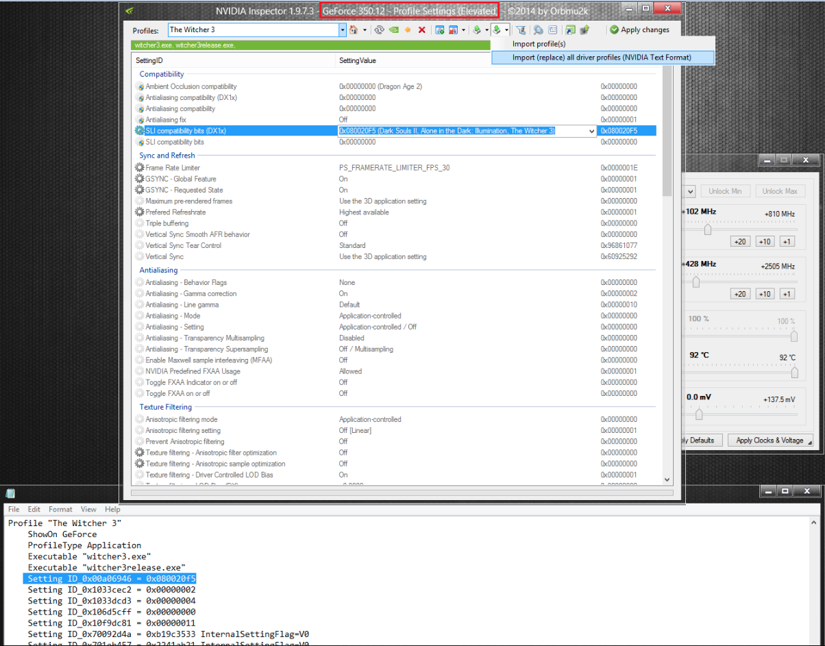

This will work for 350.12, but will not work for me with 345.20 drivers. Since I cannot use 350.12 I had to find a different workaround. With 345.20, I can overwrite the profile .BIN files in Safe Mode, but apparently the Windows Repository replaces them when I reboot, because the old versions keep coming back upon reboot. If I delete them from the repository, then there are no profiles accessible in NVCP. The only way I could do it without the PeeForce Cancer Experience is to install 352.86 over the top of 345.20 (no DDU cleaning), reboot with DSE disabled and then go into Device Manager and manually select 345.20. Since the only game I have that is not covered in the new game profiles is Wolfenstein: The Old Blood, it doesn't really make any difference for me one way or the other. I am not planning to purchase GTA V or The Witcher 3 until they can be purchased for $20 or less. I am not a huge fan of either genre... much prefer FPS. What did work was exporting 352.86 profiles for those games as NVIDIA Inspector .NIP files and importing them into a clean 345.20 installation. So, that might be an option that will work for some folks.
Then import the base profile (all games), it should work like reverting to v345.20. Agreed $59 The Witcher 3 Beta & Alpha drivers guinea pigs...

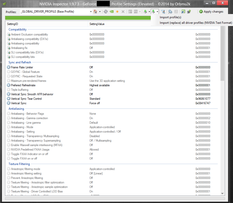

  • NV Inspector -> Driver Profile Settings -> Import User Defined Profiles -> Import (replace) all driver profiles (Nvidia text format) -> Full_Profiles_11_v353.00.txt
  • NV Inspector -> restore current profile to Nvidia defaults -> reboot

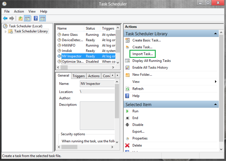

  • Task scheduler -> import task .xml -> one task at a time...:D or disable current task or edit task/Actions (System tasks/hidden command prompt window).

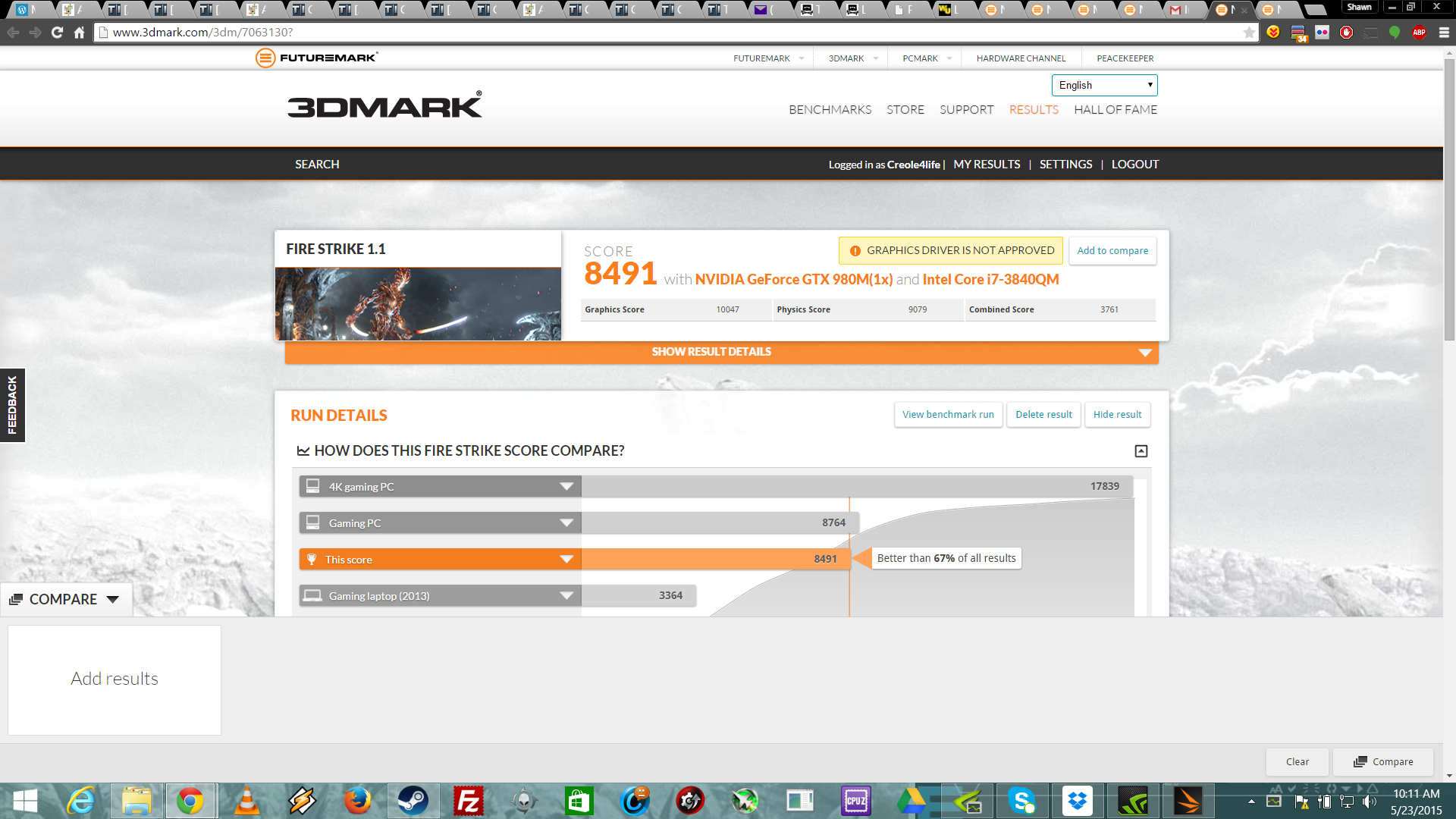

@J95
Man you are awesome!
I went into safe mode DDU the old video drivers (clean and shutdown) Then shut off driver signature > GeForce 353.00 Hotfix unziped added yourINF MOD v353.00
Here are the results
[ATTACH=CONFIG]14989[/ATTACH]
I ran it twice, scores were 8491 and 8439. There is no throttling and I have no OC. It "seemed" to be alot smoother overall. A definite walk in the right direction!

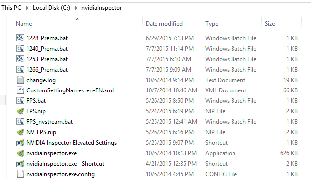

Like above Flash -> Prema's latest vBIOS MOD v1.1 (consider donating to him) -> , Unlocked sBIOS -> "PEG/Dedicated mode" -> uninstall drivers w/ DDU "Clean and Shutdown" & "Disable driver signing"
@ALL Complete Guide
1- Keep these sub-folders, delete the rest. Display.Driver -> copy/overwrite nv_dispi.inf -> run setup.exe -> clean install option -> Once Installed, close dialog -> Install GFE standalone installer v2.4.3.31Download GeForce Experience | NVIDIA | GeForce -> reboot
2- GFE Installed, set BatteryBoost to 60 FPS and then disable it -> GameStream -> "Do not Stream" -> General -> Uncheck all -> Close GFE.
3- NV Inspector -> "Frame Rate limiter OFF" -> set custom settings -> Hit apply twice -> "export current profile only" -> name it "NVI_FPS.nip" -> File associations, set .nip / NV Inspector.
3.1- NV Inspector directory "C:\nvidiaInspector\NVI_FPS.nip"
3.2- Create a .bat file to import the custom profile.
start "" "C:\nvidiaInspector\NVI_FPS.nip"
timeout /T 2
taskkill /im nvidiaInspector.exe
exit
3.3- Create a task to run the .bat at logon. General, "check run with the highest privileges" -> Triggers, delay task for 20 seconds -> Actions, browse .bat -> Conditions, Uncheck all -> Settings, uncheck "Stop the task if it runs longer than...."
4- Set GFE streamer service to "manual".
5- "P-states matching" -> Nvidia Inspector -> Performance Level [2] (P1) -> "Unlock Max" -> set core 1127 MHz -> vram 2505 MHz (OCing match P0) -> apply -> right click "create clock shortcut" -> "Create clock startup task" -> Done.
6- Test max stable OC using stock voltage, mine @1262
This will hold both core & vram (gaming), benching only after "resetting" the card e.g. installing v350.12 -> uninstalling w/DDU -> reinstalling v353.00.
P0 24/7 OC @1228/2933, P1 core @1127 / vram @2933 -> both startup tasks.
After applying the tweaks above...icons loading correctly...;)
HW acceleration enabled.

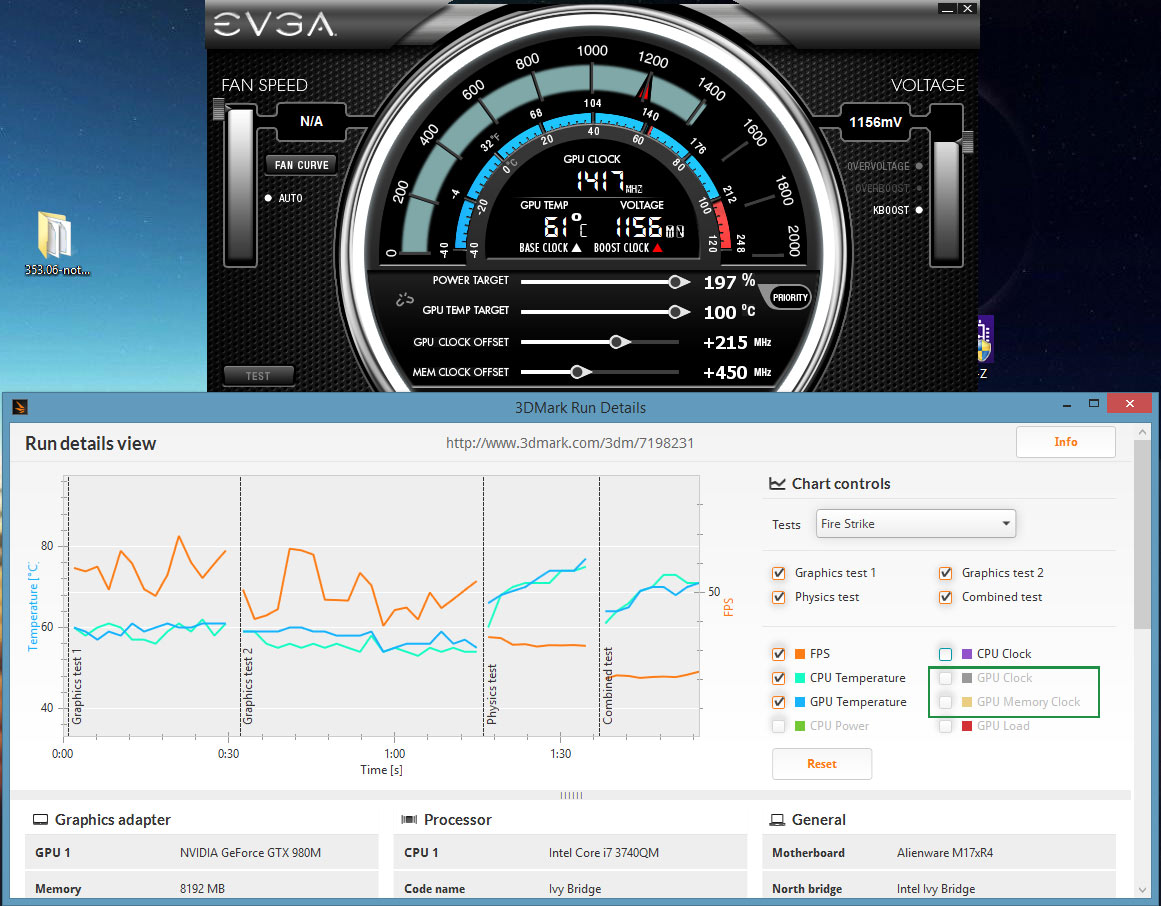

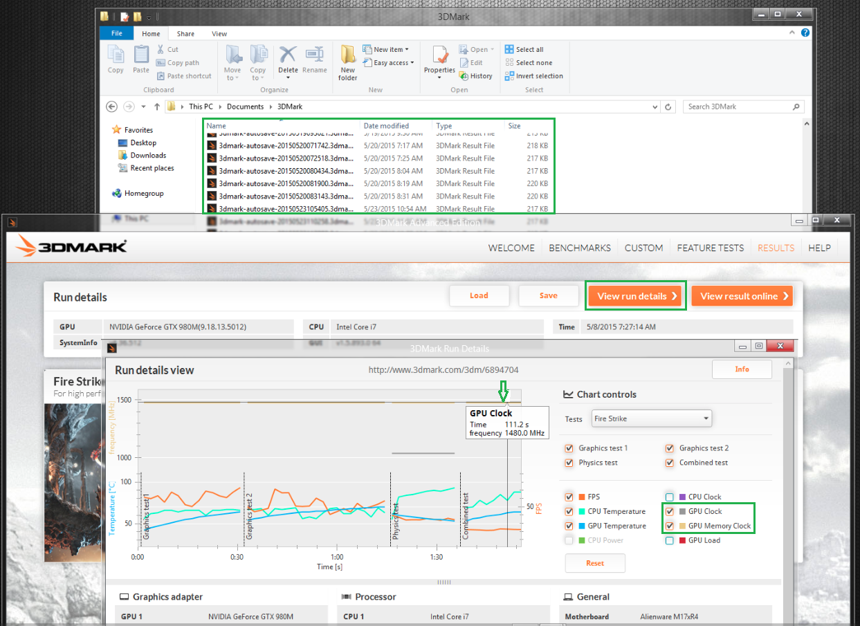

Firestrike with the new drivers (1.156V):
NVIDIA GeForce GTX 980M video card benchmark result - Intel Core i7-3740QM Processor,Alienware M17xR4
Thanks, try posting "View run details" 3dmark's autosave.
[ATTACH=CONFIG]15089[/ATTACH]
I can't mark GPU clock and CPU memory clock like you did in Run details. I am guessing this might be caused by Optimus. Both options are greyed out for me. I ran Heaven first as per your advise and the card did not throttle in Firestrike even the first time. Thank you for keeping us up to date with the latest drivers and great advises.
[ATTACH=CONFIG]15122[/ATTACH]
Thanks man, Optimus/AWs are still fine then.,,PEG mod below should work dedicated or Optimus using nv_dispi.inf
