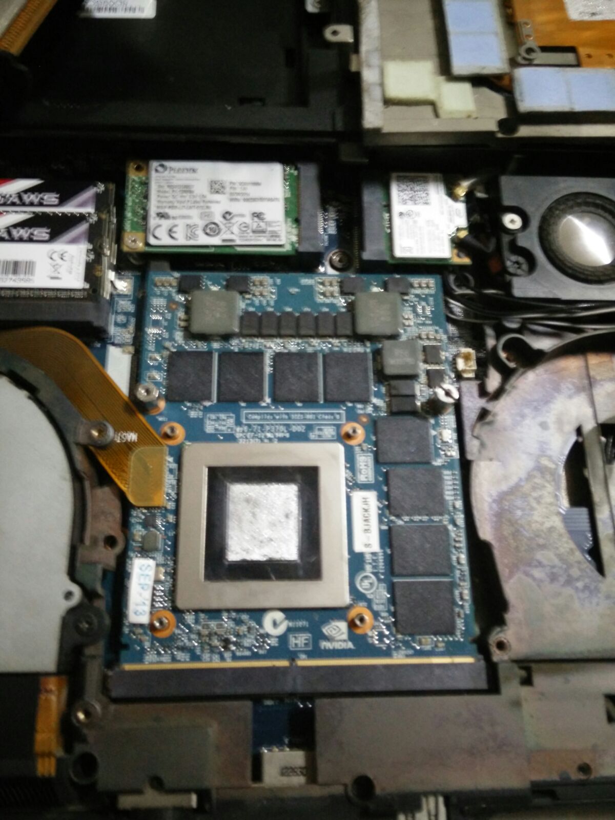

Any advice on restoring proper functioning life to my poor poor workhorse? It's artifacting in some games, has random single-second stutters/not-smooth in others, and just performing extremely sub-par in others. Also, I cannot use NVENC to record anything (though CPU-based recording works).

@Khenglish any thoughts? This is what the dead 780M looks like
I scrutinized them as best I could, but as far as I can see, the working former slave 780M and the barely-working former primary 780M looked exactly the same on all the VRMs, the core, the back, etc. If I didn't have different thermal pastes on the primary and secondary and you swapped them around while I was away from the system I wouldn't be able to tell them apart (except that ID tag near the core, of course).
Anything I could try? And/or would you want to buy the dying 780M off of me?
36 minutes ago, Khenglish said:
Artifacts is always a faulty bga. It can likely be saved by baking it. Let me know if you are interested and I'll tell you how to bake.
If it will help, I can definitely try. I don't know if I have the correct tool to bake it, though.
Does it need to be artifacting in all games? So far it's only been one or two. The other issues (99% util at ~60% of the other card, random split-second freezes once every couple hours, etc) are universally persistent though.
