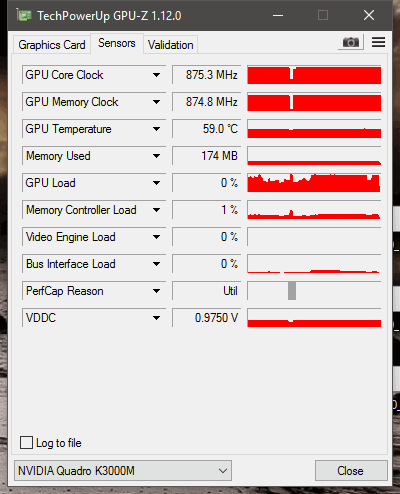

But then, I wanted to squeeze more out the card. I've tried 1000@1750 and 1050@1400, and it did work, but the card defaulted to throttling to a lower P-state like every five seconds, or so.
The attached screenshot shows the GPU under some heavy load, at 1000@1400 clocks, throttling a bit.
Obviously, jumping from 1000Mhz to 325Mhz every once in a while is not wanted, as such throttling is associated with FPS drops.
What can I do to do away with this throttling? Nvidia inspector? Modded drivers? Another GPU flash? Sorry guys -- I'm kind of lost here, not knowing what the next move is gonna be.
Or am I pushing this little GPU a bit too far?
That grey bar for "perfcap reason" in gpu-z means the card is dropping clocks due to low utilization if I remember right (if you mouse over it you will see "util"). It sounds like something on your system is stealing CPU time away from the game. Does this not happen when at stock clocks?
You do remember right! And I'm a noob (hey, at least I'll admit that). As explained below:
It turns out that there's a deviously hidden menu in nVidia Inspector of "Activate full 3D by GPU usage", which I had set to 96% and then forgot all about it (no wonders here).
So I pushed the card to 1050@1750, for the fun... and it seems it holds (there's just one throttling drop in the attached screenshot, caused by by setting the aforementioned item to 80% and coming across an undemanding area of the rendered scene (I'll set the value in question ever lower then, I guess)).

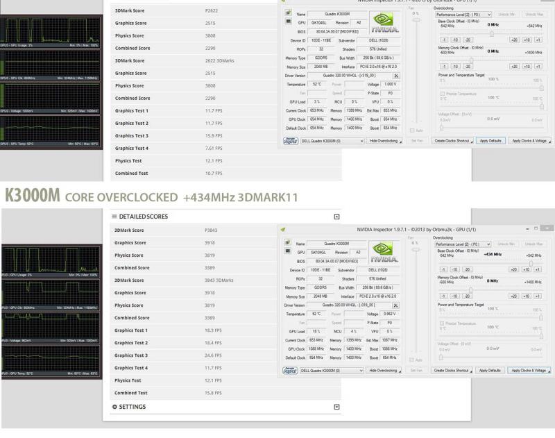

Turns out the situation solved itself, because at 1090Mhz core, the 3D application crashes almost instantly; at 1070Mhz, it takes five minutes for it to get there. So I'll be running 1050Mhz core max.
This kind of goes hand in hand with some other TechInferno guy, who (once upon a time) had a K3000M, too -- back then, he bragged about getting it to 1088Mhz... and I kept his screenshot, for reference. So these results make my card only slightly crappier-- but that's cool, too.
1050@1800 it is, so far. Read about some fools pushing their 680M GDDR5 to 2066 (but they probably didn't have this crappy Hynix memory).
