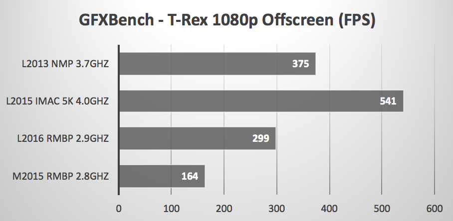

1 hour ago, Casey_S said:
Such as? I'm genuinely curious. All the new specs seem like marginal changes.
 SSD is uber fast 3GB/s
GPU is faster
slimmer and lighter
touchbar
wide color gamut is WOW :o
faster ram
http://barefeats.com/hilapmore.html
