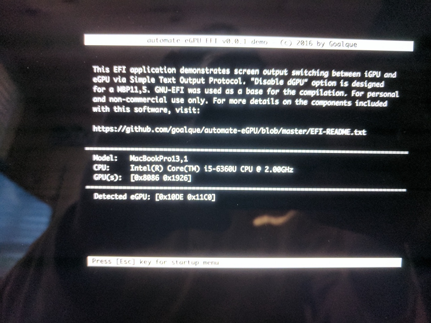

fakebanana Posted November 12, 2016 Share Posted November 12, 2016 I've also had more progress with 10.12.2 beta 2 - goalque's EFI utility now detects graphics cards plugged into the Razer Core. Unfortunately, that's as far as I can get (choosing to "Load OS X", or enabling "Warm restart" returns a "Not Supported" error - maybe this is a limitation of the demo?). automate-eGPU.sh still doesn't detect anything. Quote Link to comment Share on other sites More sharing options...

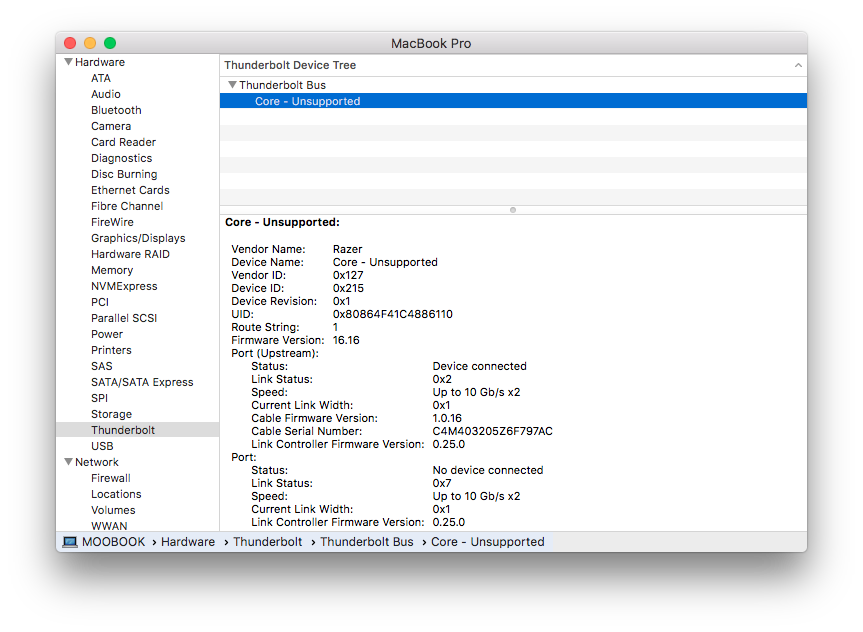

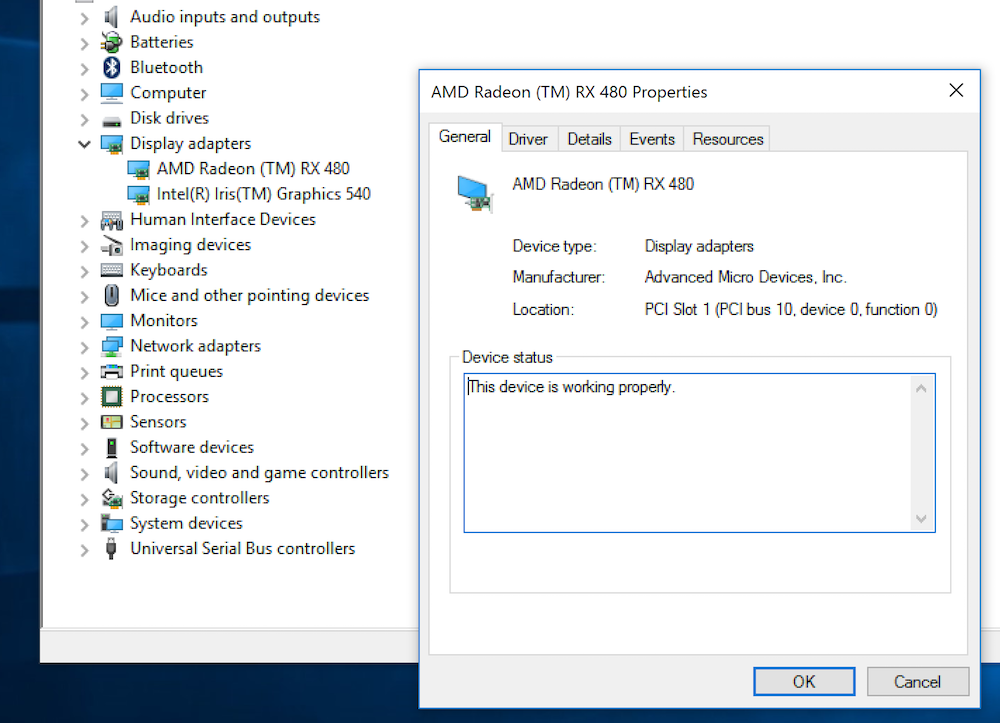

IMcD23 Posted November 16, 2016 Share Posted November 16, 2016 (edited) On 11/10/2016 at 7:01 PM, DanKnight said: How did you get your core to work? Can't get mine to work. Still stuck on the Error Code 12. I'm getting the same Error 12 in Boot Camp. I tried installing the Intel Thunderbolt drivers, and still nothing. I have a 15" with Touch Bar, Radeon Pro 460, and trying to use the Razer Core with a GTX 980 Ti. Have you gotten yours to work yet? Edited November 16, 2016 by IMcD23 added what GPU I'm using 1 Quote Link to comment Share on other sites More sharing options...
rwssoccer1 Posted November 17, 2016 Share Posted November 17, 2016 19 hours ago, IMcD23 said: I'm getting the same Error 12 in Boot Camp. I tried installing the Intel Thunderbolt drivers, and still nothing. I have a 15" with Touch Bar, Radeon Pro 460, and trying to use the Razer Core with a GTX 980 Ti. Have you gotten yours to work yet? This looks like the best solution for you: Quote Link to comment Share on other sites More sharing options...

Tech Inferno Fan Posted November 17, 2016 Share Posted November 17, 2016 On 11/11/2016 at 0:01 PM, DanKnight said: How did you get your core to work? Can't get mine to work. Still stuck on the Error Code 12. FIX: Win10 error 12 against the eGPU i. Go to Device Manager -> View Devices By Connection. Find your eGPU then disable the PCIe bridges above it one at a time like shown below including the (in this case) Root port #5. . Then re-enable them. The idea is to force reallocation by Windows. This worked on a Zbook 15/17 G2. A variation of this is to uninstall the top level PCI Bridge/Port so as to have Windows re-pnp the system upon reboot. ii. Someone with the same error 12 issue reported a Windows reinstall helped fix the issue, though removing the top-level PCI bridge in (i) should be pretty much the same thing. LINK iii. Finally, some Macbooks owners have been reporting that a DSDT override fixes their error 12: https://www.techinferno.com/index.php?/forums/topic/5874-guide-dsdt-override-to-fix-error-12/ . Do (i) again after doing this if still error see 12. iv. Enable VGA Output on the PCIe bridge hosting the Macbook TB3 controller using rEFIt or rEFInd as explained at https://www.techinferno.com/index.php?/forums/topic/1843-2012-15-rmbp-gt650m-gtx560ti8gbps-tb1-th05-win81-shelltoe/ 2 Quote Link to comment Share on other sites More sharing options...

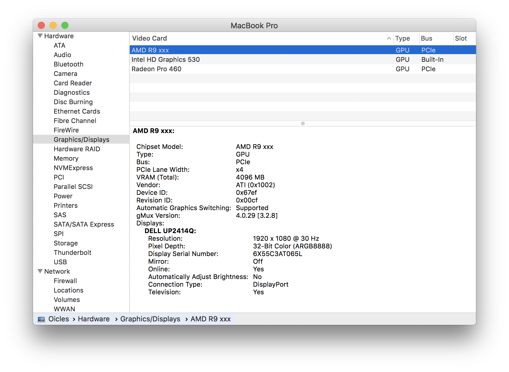

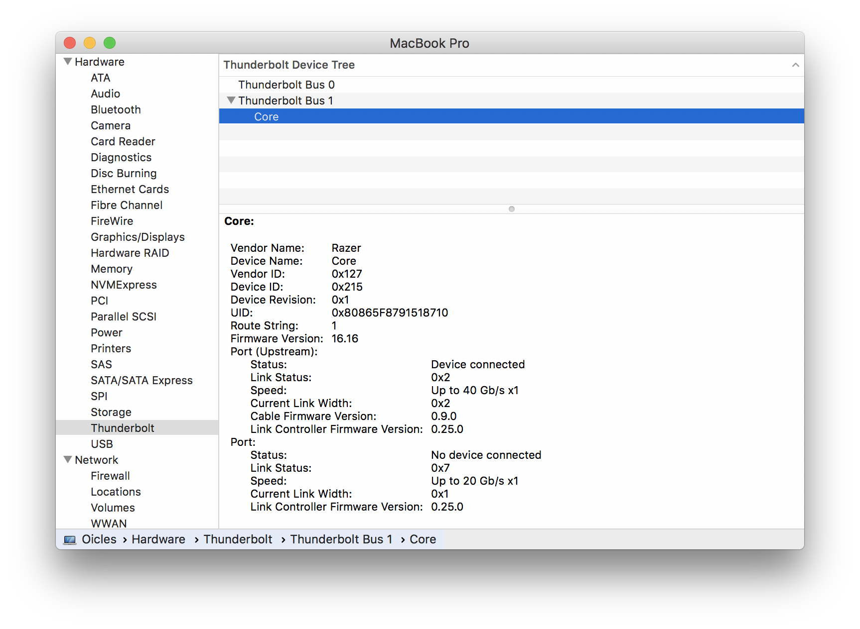

IMcD23 Posted November 17, 2016 Share Posted November 17, 2016 (edited) 1 hour ago, rettymoo said: Any one knows how to solve this one? I have mine working after making modifications to IOThunderboltFamily.kext. The Razer Core now shows up as 40Gb/s and my GPU shows up in the Graphics/Displays section. http://forum.netkas.org/index.php/topic,11654.msg34140.html#msg34140 1 hour ago, kid2010 said: by default it seems macOS refuse to recognize a set of TB3 devices (like Razer Core). After digging around, it looks like the decision is made by IOThunderboltFamily. There is a shouldSkipEnumeration function and by patching it to always return false, I was able to get MBP working with my Razer Core. I tried with RX460 and it's working (not really good though) I'm not exactly sure why Apple decided to refuse to talk with some TB3 devices and I cannot be sure whether or not the patch will physically harm the machine. Edited November 17, 2016 by nando4 link quote 1 Quote Link to comment Share on other sites More sharing options...

euqlaog Posted November 18, 2016 Share Posted November 18, 2016 On 11/12/2016 at 7:45 PM, fakebanana said: I've also had more progress with 10.12.2 beta 2 - goalque's EFI utility now detects graphics cards plugged into the Razer Core. Unfortunately, that's as far as I can get (choosing to "Load OS X", or enabling "Warm restart" returns a "Not Supported" error - maybe this is a limitation of the demo?). automate-eGPU.sh still doesn't detect anything. Sorry for the late reply. Yes, it’s a limitation of the demo. It seems that people are reporting about an error code 12 issue, especially with Maxwell series cards connected to a MBP13,1. I can confirm that my EFI app resolves this on Windows 10. Unfortunately, I cannot confirm Razer Core’s functionality and everything about this project is confidential. Here’s a couple of public 3DMark11 (still my favourite) benchmarks, with an Apple TB3 (USB-C) to TB2 adapter: RX 480: http://www.3dmark.com/3dm11/11748177 GTX 980: http://www.3dmark.com/3dm11/11751133 Stay tuned. 1 Quote Link to comment Share on other sites More sharing options...
Tech Inferno Fan Posted November 18, 2016 Share Posted November 18, 2016 Error 12 fix I've added another item which may be the key to fixing error 12 on these 2016 MBPs https://www.techinferno.com/index.php?/forums/topic/10718-2016-macbook-pros-and-egpus/&do=findComment&comment=152894 Quote iv. Enable VGA Output on the PCIe bridge hosting the Macbook TB3 controller using rEFIt or rEFInd as explained at https://www.techinferno.com/index.php?/forums/topic/1843-2012-15-rmbp-gt650m-gtx560ti8gbps-tb1-th05-win81-shelltoe/ 2 Quote Link to comment Share on other sites More sharing options...

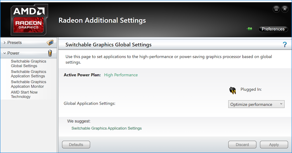

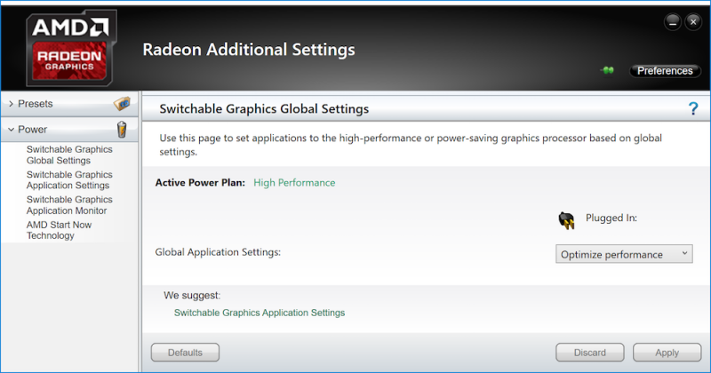

euqlaog Posted November 19, 2016 Share Posted November 19, 2016 Awesome. Internal screen performance is ~96% of the external in 3DMark11. The total score was even better than the external due to physics. http://www.3dmark.com/3dm11/11753719 This was through the TB3-TB2 adapter. It says “AMD XConnect Lite Technology” in the system tray. 2 Quote Link to comment Share on other sites More sharing options...
Morv Posted November 19, 2016 Share Posted November 19, 2016 @goalque So it does work like Nvidia Optimus but with way better performance on the internal display? Which driver? Simply the current AMD driver or a specific driver? Quote Link to comment Share on other sites More sharing options...
