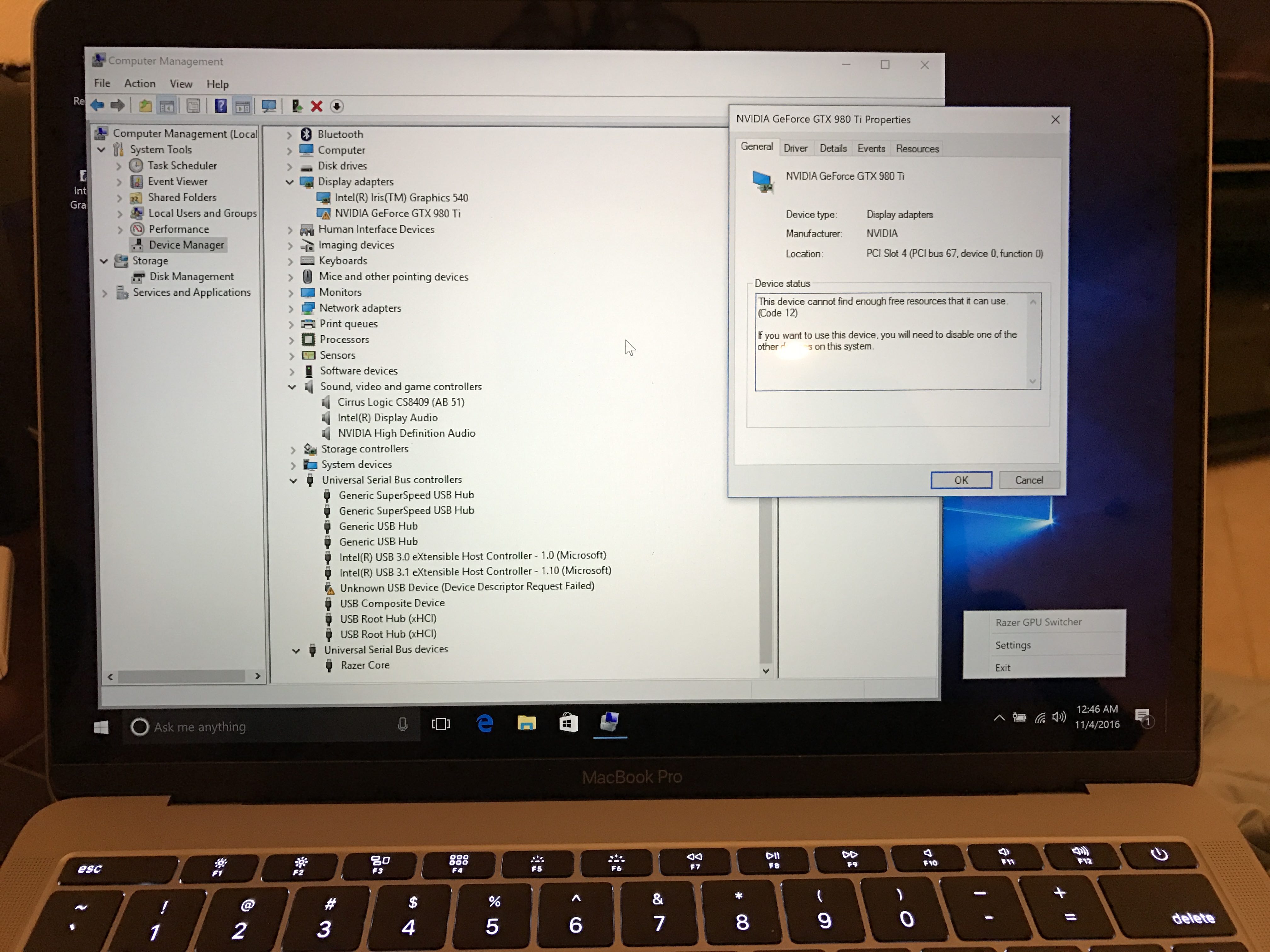

I got my razer core today and am having trouble with my 2016 MBP base 13" and a 980Ti.  Could you provide a few more specifics on the sequence of your installs?  Did you install synapse, switcher, and nvidia before plugging in the core?  Are you using the 364.72 driver version linked to on the razer site or the latest directly from nvidia (375.## i think).  Did you shutdown the system before plugging in?  Can you provide a link for the thunderbolt software you reference?  I haven't seen any notifications for this either.  I
I installed synapse and switcher, shut down windows, plugged in, started windows.  When logged into windows, I immediately got:  USB not recognized notification, a device setup installing device window, and a prompt to update synapse.  The install window and synapse updates complete and prompt a restart.  After the restart, the device manager shows what's in the attached image.  The core itself looks to be ok, but the 980Ti an an "Unknown USB device" both have errors.  It is curious that the nvidia audio device looks to be ok though.  I have no monitor connected to the gpu in the core.
Thanks in advance!
Thanks in advance!
I saw someone mention something about needing to install the Intel thunderbolt drivers in bootcamp. I would also try and install the latest NVIDIA drivers from their site.

On 11/5/2016 at 11:21 PM, RB.mac said:
I did manage to get this to work.  No luck on using eGPU to run anything on internal display only so far.  I can start a game on external display and drag in windowed mode to internal display but really not the use case I was intending.
How did you get your core to work? Can't get mine to work. Still stuck on the Error Code 12.
