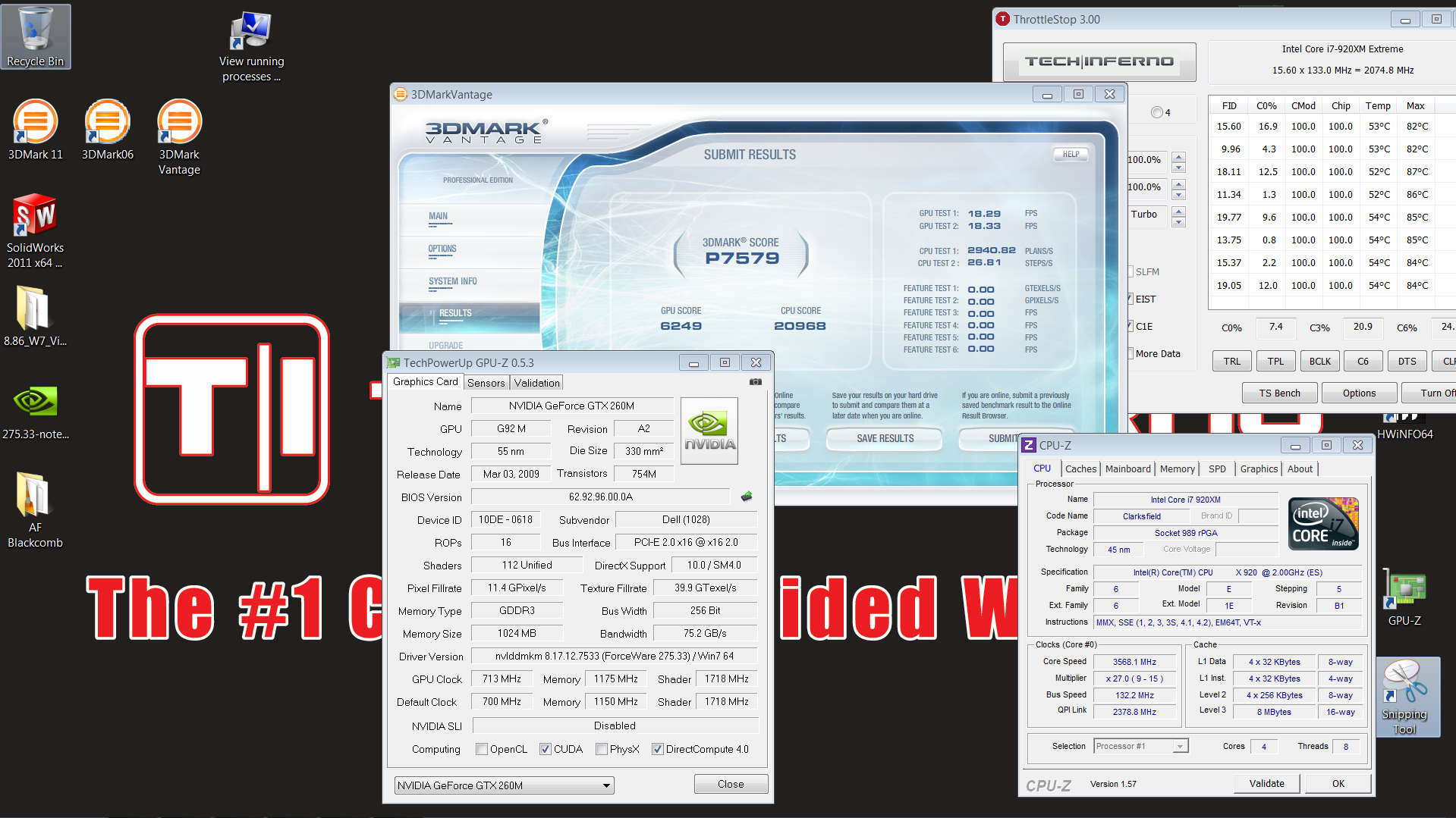

GTX 260m back in the system... slooooooow. Look how this sucks:
post-80-14494988109139_thumb.png lol :D
