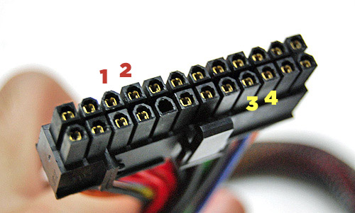

I finally solved this issue after hours of trying. If you are using the paperclip trick to power the PSU, you will need to swap the paperclip to the other side of the connecter. If you put the paperclip on the wrong side, everything will power up as normal but the GPU will not receive the right amount of power so osx will not see it. Swap the clip over and it will work. See my attachment. You either need the clip in 1&2 or 3&4. Make sure you power your mac off before retrying each time.
