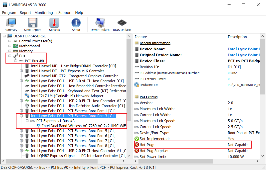

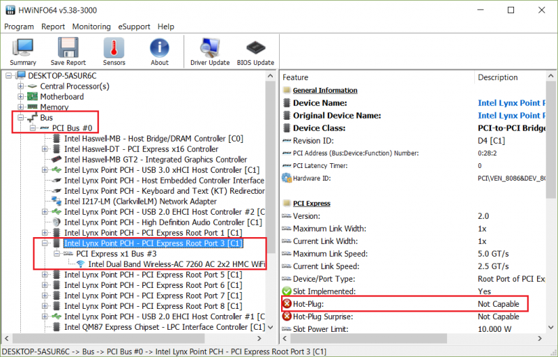

Example: use hwinfo64 to check if your eGPU hosting PCIe port supports hotplugging
1. We know NVidia drivers 372.90 and newer require the eGPU hosting PCIe bridge support to support hotplugging or otherwise an error 43 will be issued. There is some suggestion this may be confined to Win10 anniversary edition [ comments welcome ].
2. Example below: a Dell E6540 (that I'm currently using). I find the wifi card to identify the mPCIe port that could host an eGPU. Then I click the hosting PCIe bridge to check if hotplugging support is enabled.
