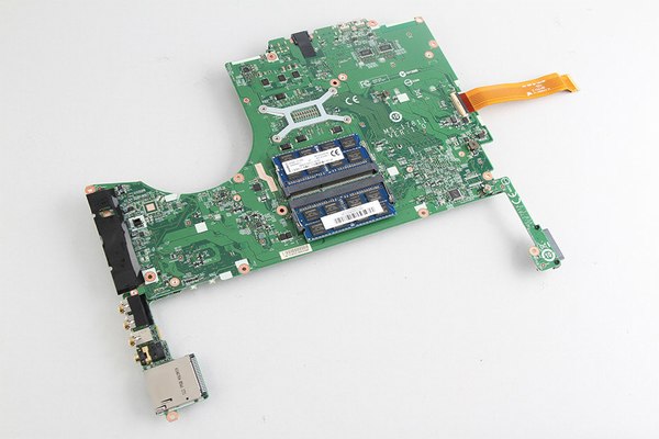

Samseed Posted September 21, 2016 Author Share Posted September 21, 2016 I can see it now..the staticky hair, a wild look of satisfaction in my eyes.. But where to start that is the problem. Just finding images of anything after ms-1763 for comparison is a mind numbing task. The GT72 board, although vastly different component wise, does maintain the same general shape. A few new "access ports" in the chassis and it might actually be functional but short of actually getting my hands on one its a little tough to plan a project like that and was hoping someone might have a list of similar or compatible boards. If only MSI had devoted an advertising budget to their mobile boards as well. Quote Link to comment Share on other sites More sharing options...

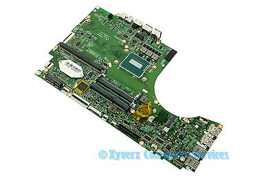

Bugii Posted September 22, 2016 Share Posted September 22, 2016 (edited) 17 hours ago, Samseed said: I can see it now..the staticky hair, a wild look of satisfaction in my eyes.. But where to start that is the problem. Just finding images of anything after ms-1763 for comparison is a mind numbing task. The GT72 board, although vastly different component wise, does maintain the same general shape. A few new "access ports" in the chassis and it might actually be functional but short of actually getting my hands on one its a little tough to plan a project like that and was hoping someone might have a list of similar or compatible boards. If only MSI had devoted an advertising budget to their mobile boards as well. Board can be obtained here. http://www.laptopinventory.com/ModelDetail.php/MSI/GT Series/GT72 2QE/Motherboards ~ System/36168 note, this was just a quick google search, I have no experience with that shop. Yes, planning without having the board in hands is challenge. You could try to find and buy damaged board for cheap - just to have something to try if it fits and then get the working one. Question is, the board costs 450bucks. You can find completely working (although used/refurbished) GT72 on ebay for about 1000usd. IMHO it would be much less of a risk to simply sell GT70 and buy used GT72 (assuming you have 450 for the board already) and you're done. Or if your goal is not to have GT72 but to do this "frankenstein project" instead, you can buy used GT72 and simply sell the parts you don't use. Please note, GT72 has "xxxxHQ" cpu. It's soldered to mobo, unlike the one you have in GT70 now. Edited September 22, 2016 by Bugii Quote Link to comment Share on other sites More sharing options...
Samseed Posted September 22, 2016 Author Share Posted September 22, 2016 This is why I get so confused when thinking about this project. Both of these are listed as MS-17811 V 1.0 and they look nothing like the one you posted(bottom) This is my conundrum. Do I spend $400+ on the off chance the chassis can be modified or spend 1000+ for a used rig that I can play mad scientist with. Of course if I have a working 72 why bother right? Quote Link to comment Share on other sites More sharing options...

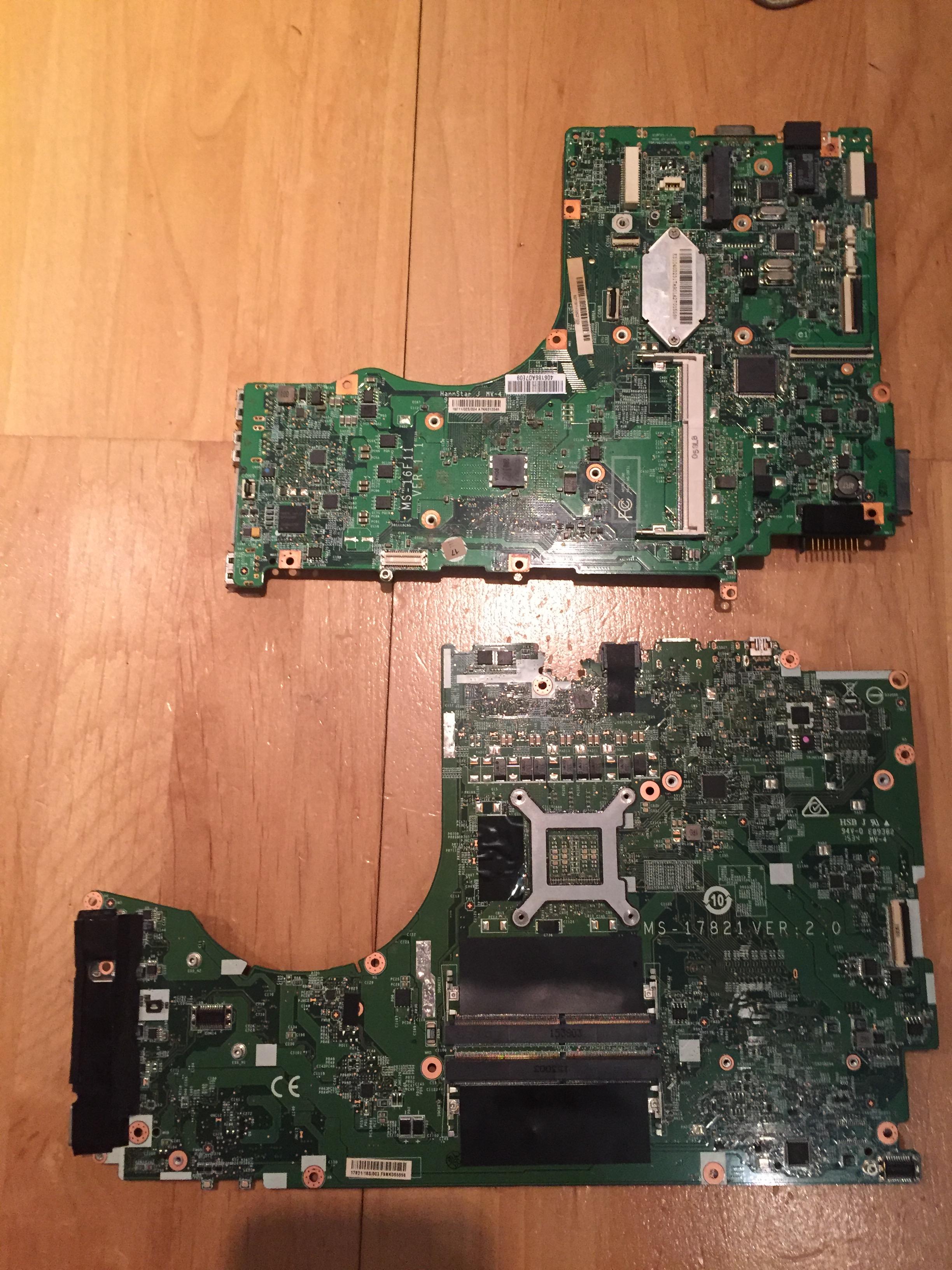

Bloetschkopf Posted September 22, 2016 Share Posted September 22, 2016 The GT72 Board is not compatible for GT70,i have a damaged Board here. Don`t think about this,this is impossible. The Latest Version of GT70 is MS-1763. And for this You need also both HDD Adapter,if You find this You must pay more than 400€ with CPU. Then You can sell Your old MS-1761 and buy a used MS-1763,ist cheaper. And the GT72 with i7-6700HQ and GTX 980M is slower than my GT70 with i7-4900MQ and GTX 980M. GT70: http://www.3dmark.com/3dm11/11553413 GT72: http://www.3dmark.com/3dm11/11586297 The GT70 is with the right Componenets a good Base and absolut Up to Date. Quote Link to comment Share on other sites More sharing options...

Bloetschkopf Posted September 23, 2016 Share Posted September 23, 2016 21 hours ago, Bugii said: Nothing is impossible my friend I saw a post here on T|I of a guy who soldered desktop GTX980 core to a mobile PCB and got it working. Respect. Interesting results. So yeah, it looks like the GT70 (1763) is better option. Since GT72 does not support Pascal cards (yet) There's really no point of upgrading GT70 to GT72. Both of them can utilize GTX980M (off topic. I found some ASUS GTX 1060 mxm cards. I'm buying one and I'll see if it will work in my GT70. I'll post the results once I have it) Could be just a "wrong picture" - not the actual photo of the board. Better ask the seller first. yes, this is exactly the point. If you ONLY want an upgrade, just get GT70 motherboard - the one for 1763 version and stick 980M in it. But some people don't care about getting better machine. They are doing this just to see if it is possible. - That's why bother to be the first one to do it. Change a GPU Chip is easy with the right Tools,a little Risk yes. But change a Board with complete different Layout is impossible,have a look at the Picture. Where You bought the Asus GTX 1060? Is it normal MXM 3.0 ? 21 hours ago, Bugii said: Quote Link to comment Share on other sites More sharing options...
Bugii Posted September 23, 2016 Share Posted September 23, 2016 (edited) 2 hours ago, Bloetschkopf said: Change a GPU Chip is easy with the right Tools,a little Risk yes. But change a Board with complete different Layout is impossible,have a look at the Picture. Where You bought the Asus GTX 1060? Is it normal MXM 3.0 ? I see. that would need a really heavy chassis modding. New board is longer so I guess you'd need to sacrifice one HDD and optical drive in order to cut a hole into chassis to stick this in. Custom made heatsink is also necessary. GTX1060 MXM3.0b here: https://world.taobao.com/item/538144341448.htm?spm=a312a.7700714.0.0.wm7MeZ#detail Yes, standard MXM 3.0b - GTX 980M next to it for comparison. I wanted 1070 but those cards are bigger, won't fit into my GT70 chassis, and they have additional power connector. This one looks compatible. Edited September 23, 2016 by Bugii Quote Link to comment Share on other sites More sharing options...
