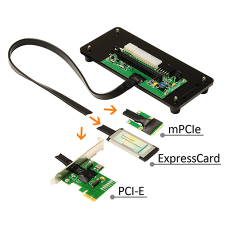

My ExpressCard Slot is a 34 one and it is one of these 4:
1 - 2 - 3 - 4
Don't know which one exactly but my question is: I saw and heard people say that Expresscards has 2.5 GB/s speed at max. Mine is showing 5 GB/s max speed (why is that). If this is possible then I will get a good 5 GB out of my GPU.
The GPU that I will use is still on delivery. But It's a powerful one and this is it: MSI R9 390 Gaming 8GB
I will use an external PSU for sure.
And I think I will use THIS adapter?
Any advice for me? Any better Adapter? Any better adapter that will serve my card good and use most of this GPU power? Anything I forgot?

PE4C V3.0 is the best eGPU adapter for your system. R9 390 will require a DSDT override on your Elitebook to work due to the limited BIOS-set TOLUD:
Thanks Tech Inferno Fan
I will work on the override and allocate the eGPU into 36-bit space thanks to your guide. I will then post my results on the DIY eGPU experiences thread.
Thank you so much for helping  me and everyone.

Hey there, new to the forum, and new to egpu experience. (tough i read a lot about it).
Question for you nando.
I got a GDC exp Beast V8 Pcie version the other day, got it working on my Toshiba L50-A-18T (i7-4700MQ @2.40GHz 8bg ram and Windows 10), Didnt need the setup software yet.
just had to deactivate my Dgpu on Device manager to get it working as my bios doesnt let me do it.
So the question is about mPcie bandwith, what graphics card do you recomend?
If i got a GTX 960 4bg Gddr5, what kind of bottle neck regarding the mpcie interface, Or should i just buy a cheaper graphics?
Would your software help in anyway, regarding freening more bandwith on the mpcie ?
Ty in Advance man.

Yes, Setup 1.30 can be used to switch the mPCe port from Gen1->Gen2 to gain more performance. Disabling the dGPU there can also improve DX9 performance.
Contact details to obtain the software is at  https://www.techinferno.com/index.php?/forums/topic/1650-diy-egpu-setup-130-previously-setup-1x/
