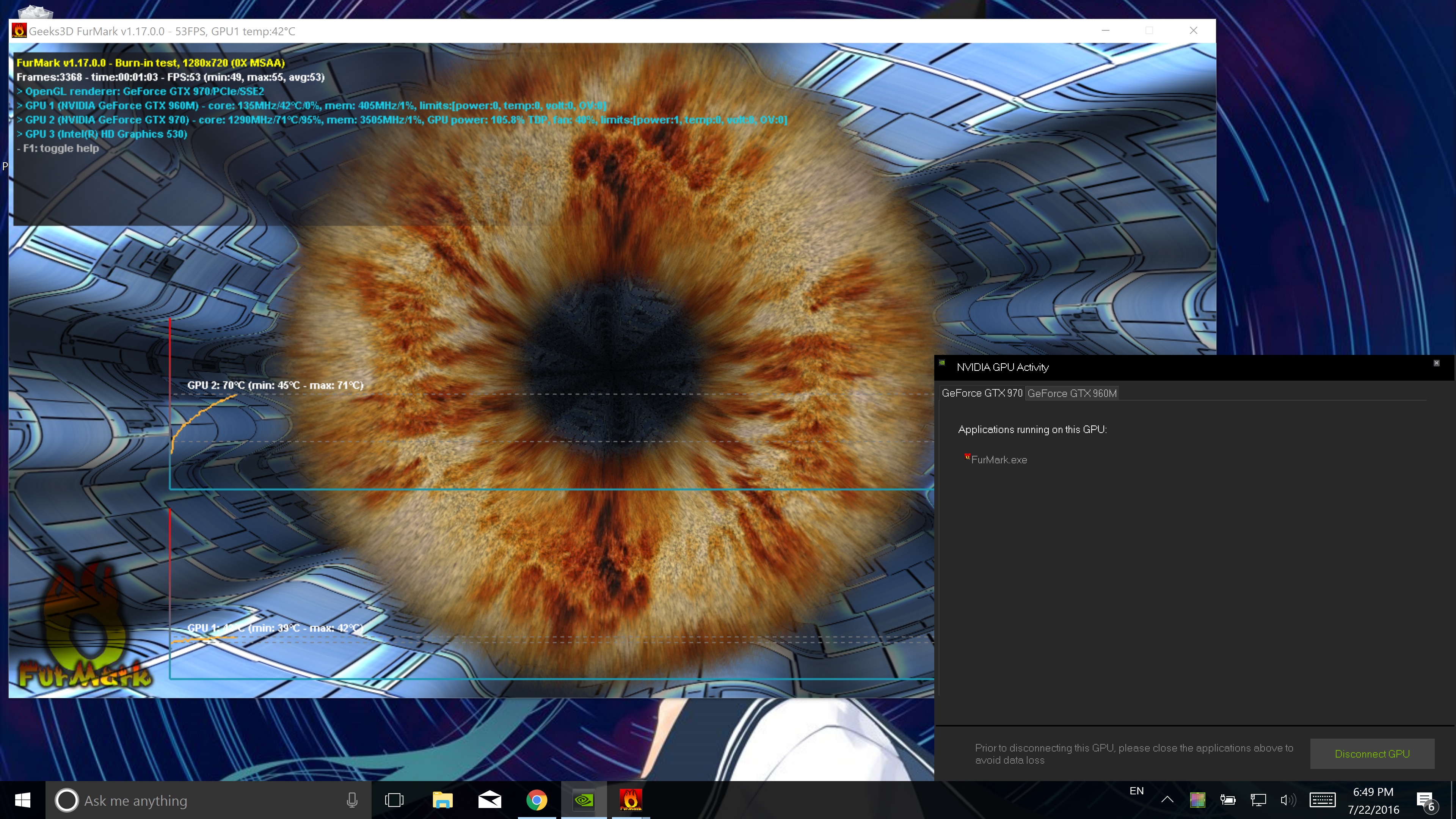

Update on Morning July 23rd 2016: Turns out the Optimus is only working for Furmark. i.e. No game would run on GTX970. Nor would 3DMark. It seems an external monitor is still a necessary fix.

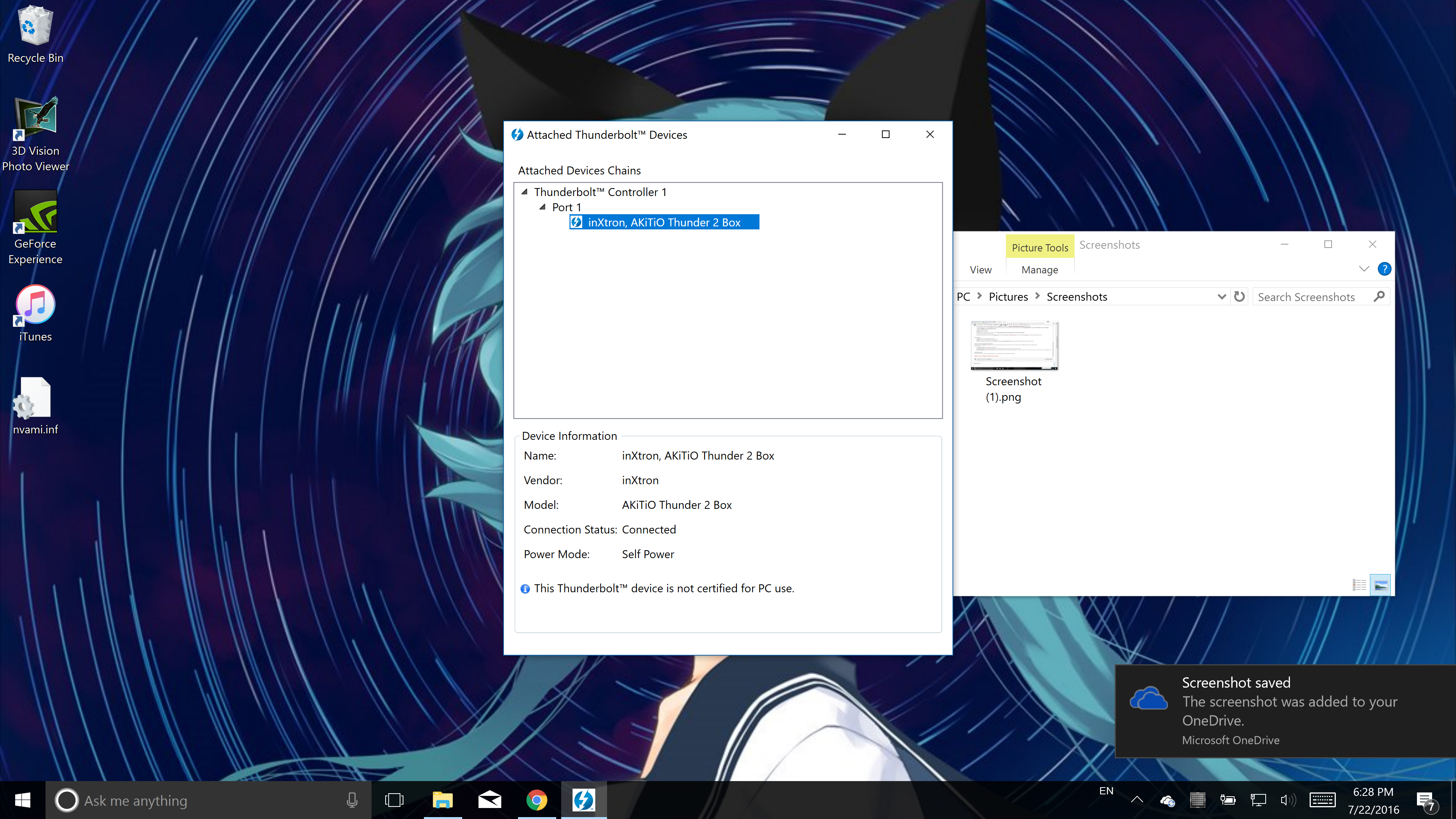

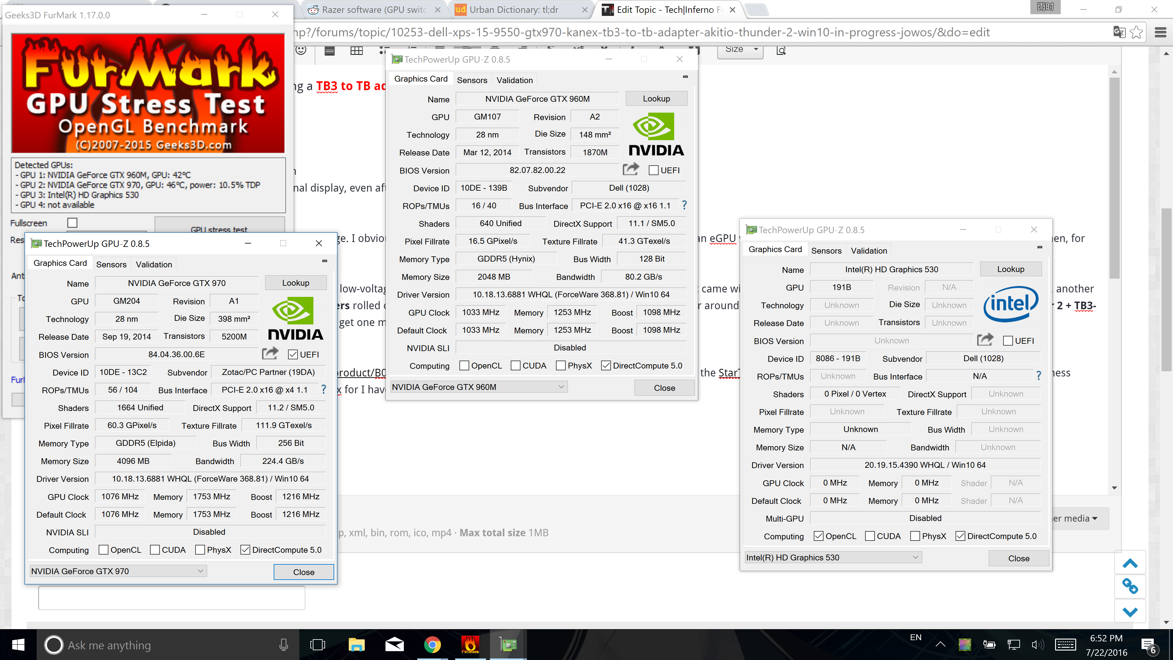

  8. reboot, and you should be able to see all three graphics card in Device Manager. (Intel 530, GTX960M, GTX970). You are free to disable GTX960M, but that doesn't help anything so far. :-(

  1. Geforce experience recognizes GTX970 no problem
  2. NVIDIA Control Panel recognizes all three with no problem.
  3. Under internal display, no game would run with GTX970, even after disabling GTX960M. GTX970 shows up properly in the GPU indicator, but it's always 'inactive'
  4. It works! Just don't disable GTX960M, and tasks will be automatically assigned to GTX970 when needed. Only works for Furmark. No games and 3D Mark would work.

  4. Just don't disable GTX960M and it partially works (only for furmark). Maybe furmark is rendering the content internally and pipe the image out through a different gpu manually?

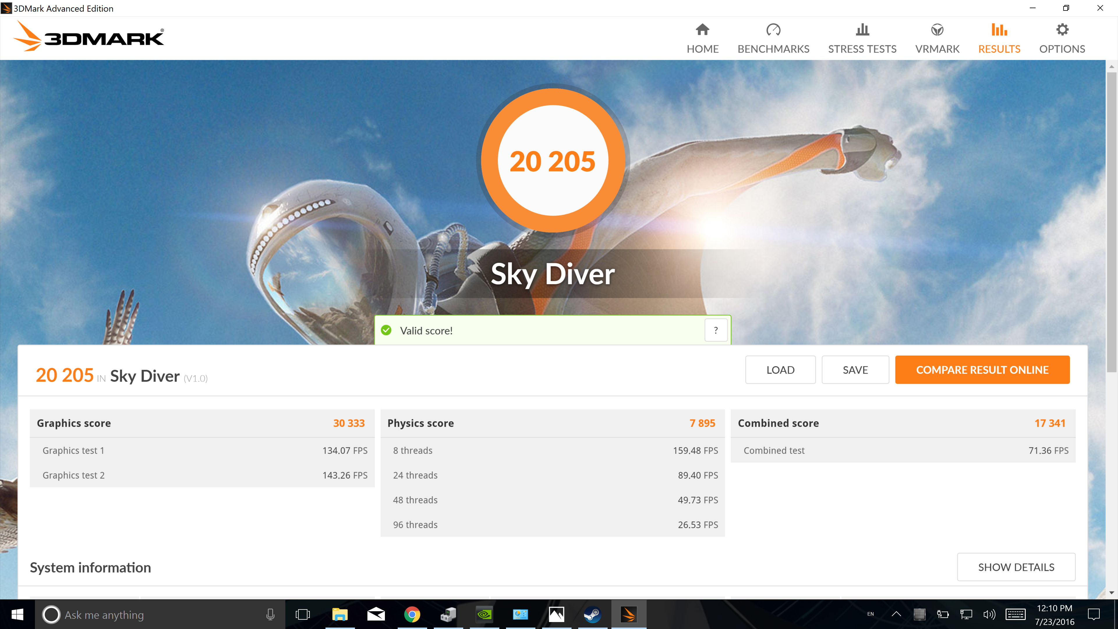

Tried out on the TV, able to achieve ~20000 on Sky Diver. With GTX960M it's around half1533176088.png

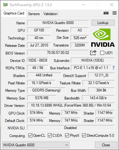

6 hours ago, ssamydla said:
Can anyone confirm that on GPUZ, normally GTX cards' CUDA, PhysX was not checked? Since i saw others GPU-Z screenshots that enabled CUDA & PhysX, but it was from Desktop PC.
My screenshot was not checked. :/ Didn't test it either. Strange thing, though. My guess is some mis-recognition, as the dGPU is also unchecked, while working fine.
@jowos Just found out that we need to install PhysX System Software in order to make PhysX work properly and detected by GPU-z.
I did some test,  by installing latest PhysX System Software it greatly improves PhysX benchmark on FluidMark. But computer freezed twice during Fallout 4 loading and FluidMark fullscreen benchmark.
I need to install Legacy PhysX software as well to make it run smooth (for old Games or Games that use old PhysX SDK). But i didn't use it much for gaming though. Only for 3D & VisualFX Applications.
If you think it's working fine. no need to install it though.  It's just work as it is.
