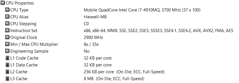

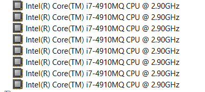

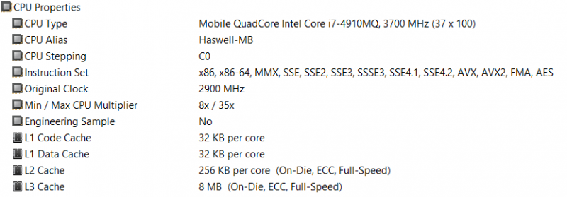

Some time ago I decided to upgrade the CPU, and after a long search found references to authentic information that help you to upgrade to Intel® Core ™ i7-4910MQ Processor (8M Cache, up to 3.90 GHz).
Previously, I had a Intel® Core ™ i7-4700MQ Processor (6M Cache, up to 3.40 GHz). I have not conducted specific tests, but on the whole system more responsive.

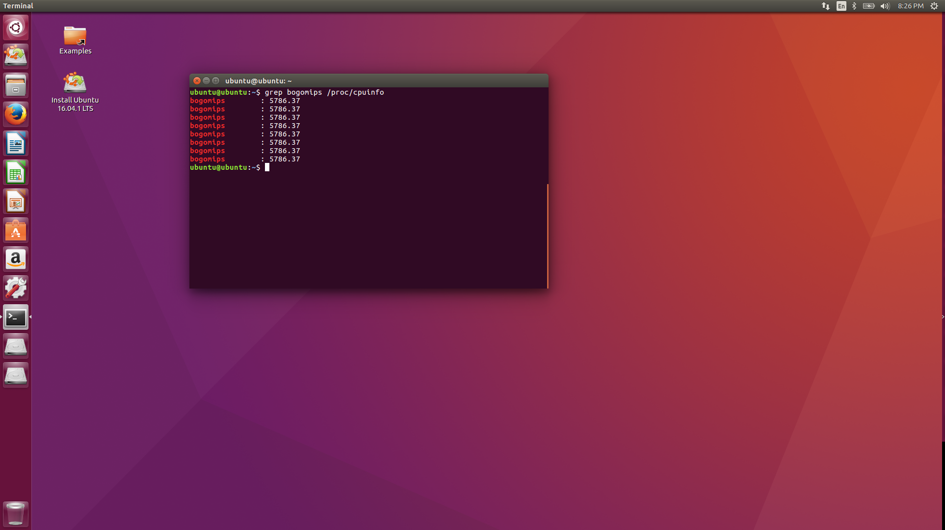

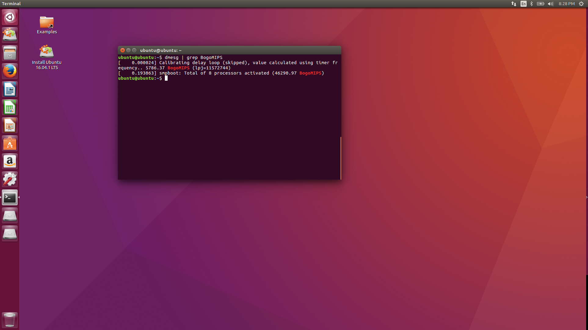

If you can run live linux, what is the indicated bogomips of the CPU?

That performance in BogoMIPS.
