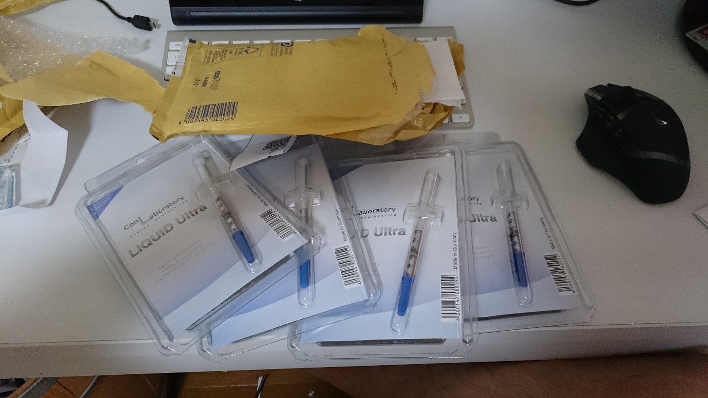

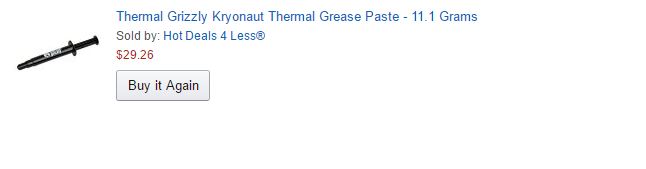

Guest Posted September 22, 2016 A really good friend just gave me an Amazon gift card, so I figured that I should start getting things in order for 1080 SLI. The way the die is made seems a bit more risky for Liquid Ultra, as everything is exposed and there is no support rim around the edge. (I am really puzzled what the rationale was for removing that support rim. It makes 1080 look like the cheap low- and mid-range GPUs without it.) So, I will start with Kryonaut to see if that is good enough. If necessary I will use an RTV silicon dam around the edge of the die if I need to break out the big guns with Liquid Ultra to keep it in line. Fujipoly / mod/smart Extreme X-e Thermal Pad - 60 x 50 x 1.5 - Thermal Conductivity 11.0 W/mK Fujipoly / mod/smart Extreme X-e Thermal Pad - 60 x 50 x 1.0 - Thermal Conductivity 11.0 W/mK Fujipoly / mod/smart Extreme X-e Thermal Pad - 60 x 50 x 0.5 - Thermal Conductivity 11.0 W/mK Thermal Grizzly Kryonaut Thermal Grease Paste - 11.1 Grams Quote Share this post Link to post Share on other sites
TBoneSan 112 Posted September 22, 2016 (edited) Good boy scout there brother @Mr. Fox I got me some more Liquid Metal for the deliding ceremony. Running short of that isn't fun. So GPU is not a good candidate for CLU hey... I have hopefully successfully updated my order to the DM3 Single 1080 with Hidevolution. I'm interested to see how the cooling fares on my "gamer-boy ( )" single. Can't wait. I've been stuck using this ... jealous ?! Edited September 22, 2016 by TBoneSan 3 Quote Share this post Link to post Share on other sites
Guest Posted September 22, 2016 52 minutes ago, TBoneSan said: Good boy scout there brother @Mr. Fox I got me some more Liquid Metal for the deliding ceremony. Running short of that isn't fun. So GPU is not a good candidate for CLU hey... I have hopefully successfully updated my order to the DM3 Single 1080 with Hidevolution. I'm interested to see how the cooling fares on my "gamer-boy ( )" single. Can't wait. I've been stuck using this ... jealous ?! LOL, no... not jealous of that. Yeah, that's definitely the way to do it. I try to always have more CLU available than what I need. I think I have 3 tubes of that, a Liquid Pro, 2 tubes of Phobya Liquid Metal, a Gelid and 2 or 3 ICD 24 tubes, and a partially used tube of Kryonaut, LOL. I'm a TIM hoarder. I've also have plenty of sheets of of less expensive thermal pads, but I figured why not go for the 11.0 W/mK good stuff. It looks like Pascal needs all the help it can get for thermals. I've never actually needed to use CLU on GPUs before and it's more expensive. I'll use it if I need to. I am a bit skiddish on the 1080s simply because of the way they are made, but proper precautions will avert the possibility of any mishaps. Quote Share this post Link to post Share on other sites

ajc9988 118 Posted September 26, 2016 A really good friend just gave me an Amazon gift card, so I figured that I should start getting things in order for 1080 SLI. The way the die is made seems a bit more risky for Liquid Ultra, as everything is exposed and there is no support rim around the edge. (I am really puzzled what the rationale was for removing that support rim. It makes 1080 look like the cheap low- and mid-range GPUs without it.) So, I will start with Kryonaut to see if that is good enough. If necessary I will use an RTV silicon dam around the edge of the die if I need to break out the big guns with Liquid Ultra to keep it in line. Fujipoly / mod/smart Extreme X-e Thermal Pad - 60 x 50 x 1.5 - Thermal Conductivity 11.0 W/mK Fujipoly / mod/smart Extreme X-e Thermal Pad - 60 x 50 x 1.0 - Thermal Conductivity 11.0 W/mK Fujipoly / mod/smart Extreme X-e Thermal Pad - 60 x 50 x 0.5 - Thermal Conductivity 11.0 W/mK Thermal Grizzly Kryonaut Thermal Grease Paste - 11.1 Grams If you need a different thickness or size pad for fujipoly, contact performance-pcs.com. They'll order a different thermal pad made by fujipoly, including the 2, 3, 4, and even 5mm pads (5mm at 6w/mK, which is good for that thickness). Florida based company that I check out since frozencpu got in a funk...Sent from my SM-G900P using Tapatalk 2 Quote Share this post Link to post Share on other sites

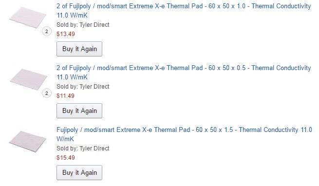

Guest Posted September 26, 2016 Oh boy, my thermal pad purchase has turned out to be more time consuming than I hoped for... All those high Xw/mK versions appear to be very hard (naturally) and may reduce the heat-sink pressure on the DIE!? Sarcon.pdf Quote Share this post Link to post Share on other sites
octiceps 256 Posted September 27, 2016 3 hours ago, Prema said: Oh boy, my thermal pad purchase has turned out to be more time consuming than I hoped for... All those high Xw/mK versions appear to be very hard (naturally) and may reduce the heat-sink pressure on the DIE!? Sarcon.pdf Yes this seems to be true of aftermarket thermal pads from Fujipoly and Phobya in general, based on what I've used and read. Compared to the somewhat squishy and stretchy nature of stock thermal pads, the 6 W/mK and 11 W/mK Fujipoly I've had were hard and incompressible, with a brittle and powdery consistency when cut. I'd imagine the 17 W/mK ones aren't much different. With these, definitely a good rule of thumb to use as thin a layer as you can get away with. Apparently the XR-m is available in as thin as 0.3 mm, but I've only seen 0.5 mm for sale. 2 Quote Share this post Link to post Share on other sites
ajc9988 118 Posted September 27, 2016 Oh boy, my thermal pad purchase has turned out to be more time consuming than I hoped for... All those high Xw/mK versions appear to be very hard (naturally) and may reduce the heat-sink pressure on the DIE!? Sarcon.pdfsomething you can do is use modeling clay or something similar to find the precise, minimum thickness of the pads needed (between some form of plastic to prevent it from getting on components). That is one solution. They also have a type of puddy tim that can be used... Sent from my SM-G900P using Tapatalk 2 Quote Share this post Link to post Share on other sites
iunlock 91 Posted September 27, 2016 5 hours ago, ajc9988 said: something you can do is use modeling clay or something similar to find the precise, minimum thickness of the pads needed (between some form of plastic to prevent it from getting on components). That is one solution. They also have a type of puddy tim that can be used... Sent from my SM-G900P using Tapatalk What I've done before is sandwich the molding clay using saran wrap, but just use enough clay to cover the chip / die. It works wonders. 2 Quote Share this post Link to post Share on other sites
bloodhawk 127 Posted September 27, 2016 (edited) 16 hours ago, Prema said: Oh boy, my thermal pad purchase has turned out to be more time consuming than I hoped for... All those high Xw/mK versions appear to be very hard (naturally) and may reduce the heat-sink pressure on the DIE!? Sarcon.pdf When will we get to see pictures of your monster? Edited September 27, 2016 by bloodhawk 1 Quote Share this post Link to post Share on other sites

iunlock 91 Posted September 27, 2016 (edited) 15 hours ago, octiceps said: Yes this seems to be true of aftermarket thermal pads from Fujipoly and Phobya in general, based on what I've used and read. Compared to the somewhat squishy and stretchy nature of stock thermal pads, the 6 W/mK and 11 W/mK Fujipoly I've had were hard and incompressible, with a brittle and powdery consistency when cut. I'd imagine the 17 W/mK ones aren't much different. With these, definitely a good rule of thumb to use as thin a layer as you can get away with. Apparently the XR-m is available in as thin as 0.3 mm, but I've only seen 0.5 mm for sale. Having used various types of Fujiploy pads, mostly the 17.0w/mk in particular, I can confirm that the higher you go in the thermal ratings the more dense the pads are. The FP 17.0w/mk pads are dense, but still flexible and soft. However, there is not much give on them so one would have to make sure to size up the pads the best they can, otherwise if the application is too thick the harder density of the pads risk lifting of the HS...although I think it'll be okay and the VRM's would compress enough to where it shouldn't be an issue. I'll have full specs of the sizes for the P775DM3 here shortly. Actually I have them already, but am working on my review and it'll be included in there. Edited September 27, 2016 by iunlock 4 Quote Share this post Link to post Share on other sites
