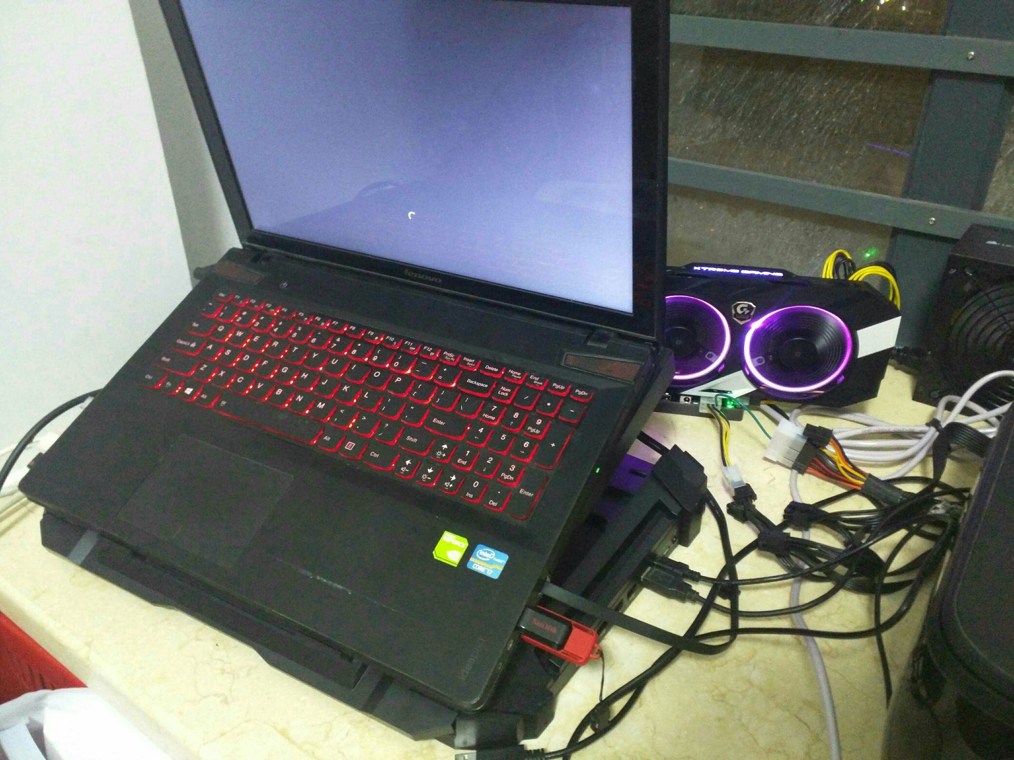

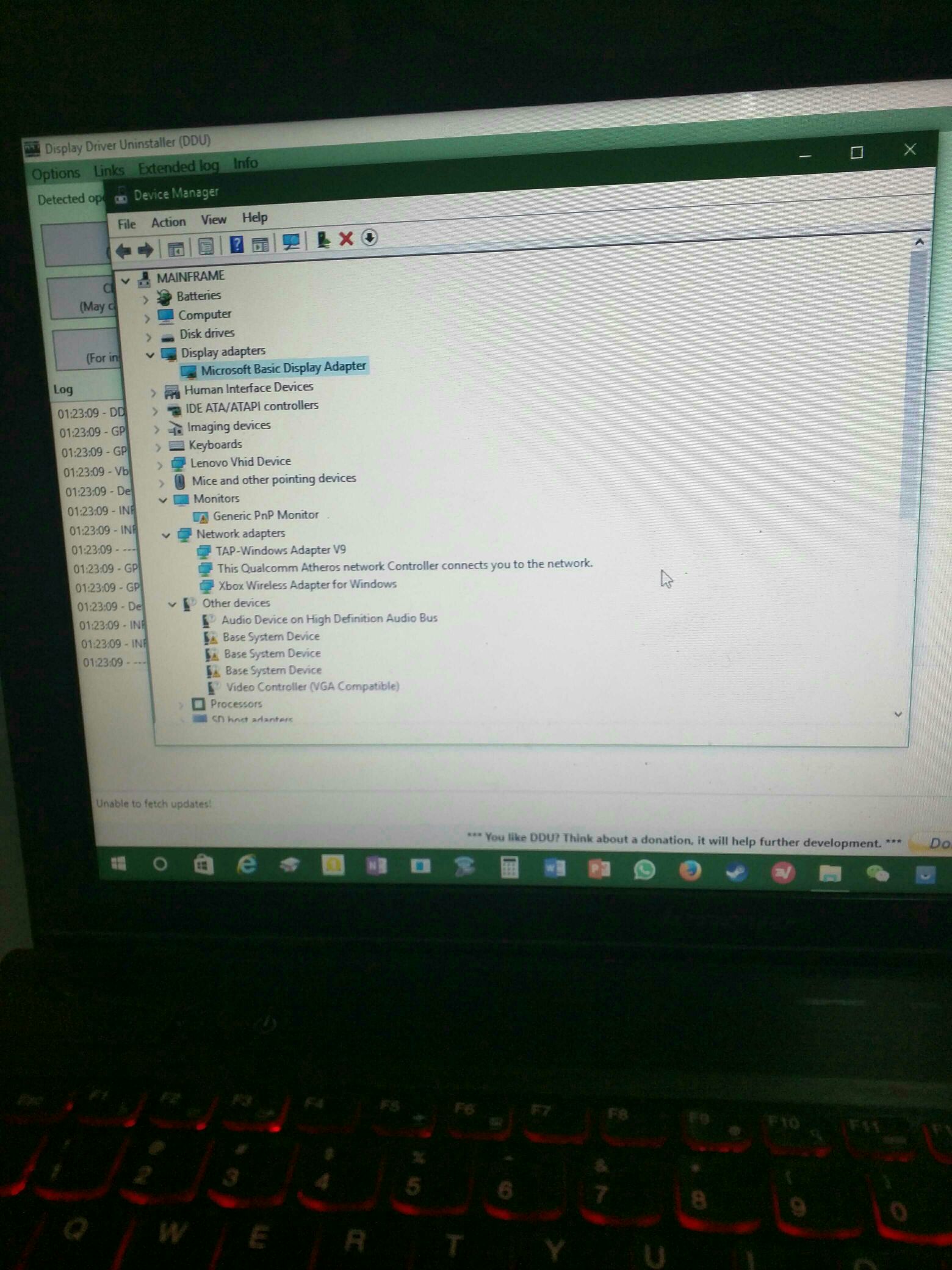

dRoLdDy Posted August 17, 2016 Share Posted August 17, 2016 Should I do something with the PTD switch? I tried setting it to 7 seconds and then to 15 seconds. The result was the same - boot loop. I can load into safe mode properly but why can't I load into normal mode[emoji24] [emoji24] [emoji24] ? So basically I'm safe mode the internal graphics card is disabled so it has no problem starting but in normal mode, the internal graphics card loads so then it can't choose between the iGPU and eGPU. This is my guess.. Sent from my Nexus 6 using Tapatalk Quote Link to comment Share on other sites More sharing options...
dRoLdDy Posted August 17, 2016 Share Posted August 17, 2016 Now I only have only one option under display adapters Sent from my Nexus 6 using Tapatalk Quote Link to comment Share on other sites More sharing options...
dRoLdDy Posted August 17, 2016 Share Posted August 17, 2016 Well I had to restore my system to the last point of successful boot. I will try the whole process again but Y500 was cleanly not made to run an external GPU with ease unlike y580 which has no problems Sent from my Nexus 6 using Tapatalk Of course I did. Sent from my Nexus 6 using Tapatalk Your plugging a monitor into the external GPU? The fans on most Nvidia GPUs will turn off at idle. I wouldn't be surprised if it was outputting video only out of the GPU. Now there is something on the external screen but still the computer is in boot loop Sent from my Nexus 6 using Tapatalk Quote Link to comment Share on other sites More sharing options...
cuethenoise Posted August 17, 2016 Share Posted August 17, 2016 I'll see the settings on my card. You probably need to install the latest drivers for the external gpu? Quote Link to comment Share on other sites More sharing options...
dRoLdDy Posted August 17, 2016 Share Posted August 17, 2016 Yes but I can't install the drivers in safe mode Sent from my Nexus 6 using Tapatalk C++ runtime not working in safe mode Sent from my Nexus 6 using Tapatalk Quote Link to comment Share on other sites More sharing options...
dRoLdDy Posted August 17, 2016 Share Posted August 17, 2016 I'll see the settings on my card. You probably need to install the latest drivers for the external gpu? I will have to restore my system to the last working state, I saved a restore point cause I thought something like this might happen. I'm unable to install the drivers in safe mode. Sent from my Nexus 6 using Tapatalk I'll see the settings on my card. You probably need to install the latest drivers for the external gpu? Also, please tell me if I should delete the existing drivers once my system restores. By deleting the drivers, all these boot problems started. Sent from my Nexus 6 using Tapatalk Quote Link to comment Share on other sites More sharing options...
cuethenoise Posted August 17, 2016 Share Posted August 17, 2016 (edited) What i did was add the card and it booted. Then I installed the latest drivers. Then I disabled the extra 750m GPU (took a little bit of trial to figure out which one was the one in the slot and not on the mobo). Then I booted up with the monitor hooked up to the eGPU. I told the bios to use the pcie gpu as the default. I had an AMD card (r9 290x), but I would think a Nvidia card would be easier. Remove the eGPU and install the latest drivers. Edited August 17, 2016 by cuethenoise 1 Quote Link to comment Share on other sites More sharing options...
dRoLdDy Posted August 17, 2016 Share Posted August 17, 2016 What i did was add the card and it booted. Then I installed the latest drivers. Then I disabled the extra 750m GPU (took a little bit of trial to figure out which one was the one in the slot and not on the mobo). Then I booted up with the monitor hooked up to the eGPU. I told the bios to use the pcie gpu as the default. I had an AMD card (r9 290x), but I would think a Nvidia card would be easier. Remove the eGPU and install the latest drivers. Thanks. Did you change any of the settings in BIOS prior to adding the eGPU or did you leave it by default? Sent from my Nexus 6 using Tapatalk Quote Link to comment Share on other sites More sharing options...
dRoLdDy Posted August 17, 2016 Share Posted August 17, 2016 What i did was add the card and it booted. Then I installed the latest drivers. Then I disabled the extra 750m GPU (took a little bit of trial to figure out which one was the one in the slot and not on the mobo). Then I booted up with the monitor hooked up to the eGPU. I told the bios to use the pcie gpu as the default. I had an AMD card (r9 290x), but I would think a Nvidia card would be easier. Remove the eGPU and install the latest drivers. Then I disabled the extra 750m GPU (took a little bit of trial to figure out which one was the one in the slot and not on the mobo). Can you please explain this in a little more detail. My system booted now with eGPU plugged in - GREAT! Btw, the fans are not spinning so I'm guessing you meant idle by not spinning. Btw, the drivers are already installed and I can see the gtx 960 in display adapters. Sent from my Nexus 6 using Tapatalk Quote Link to comment Share on other sites More sharing options...
dRoLdDy Posted August 17, 2016 Share Posted August 17, 2016 OK my system booted and everything worked. Amazing! Thank you so much Sent from my Nexus 6 using Tapatalk Quote Link to comment Share on other sites More sharing options...
cuethenoise Posted August 17, 2016 Share Posted August 17, 2016 2 hours ago, dRoLdDy said: OK my system booted and everything worked. Amazing! Thank you so much Sent from my Nexus 6 using Tapatalk Great! Glad we could help! Quote Link to comment Share on other sites More sharing options...
