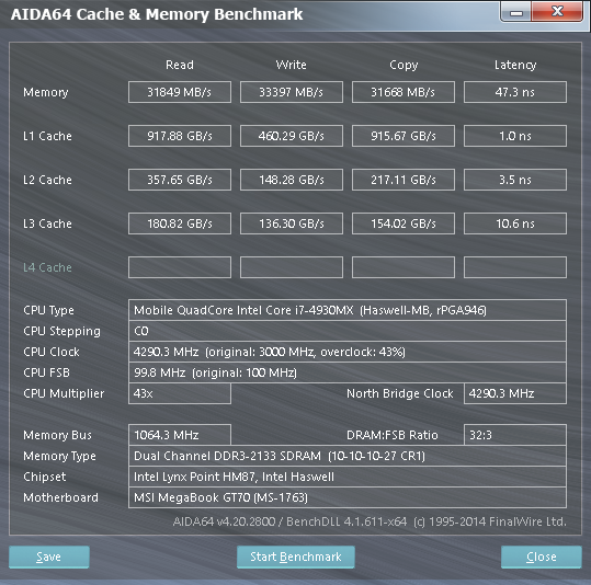

  1. Mr. Fox 2133 10-10-10-27 (all other timings is stock), but it not stable. And of course all memory controllers in CPU is different. Ability work with high frequency and agressive timings may be very different even for two identical CPUs.

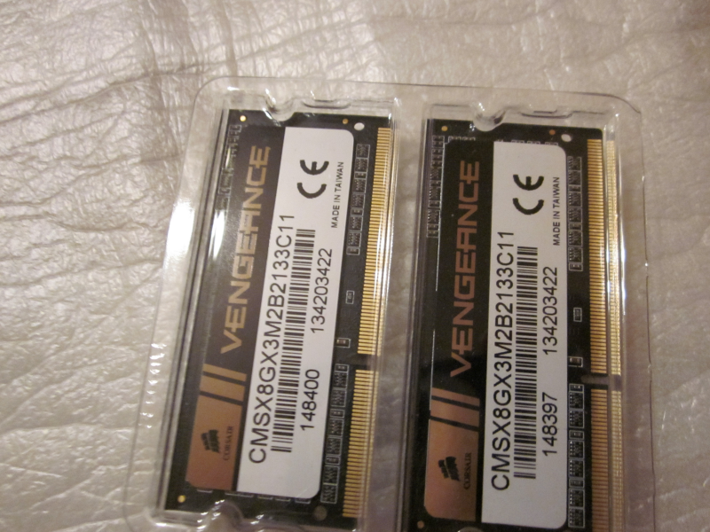

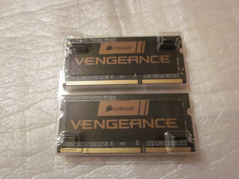

  6. Corsair Vengeance 2133 CL11 memory 32GB (4x8GB) CR1! Corsair Vengeance 2133 CL10 memory 32GB (4x8GB) CR1!

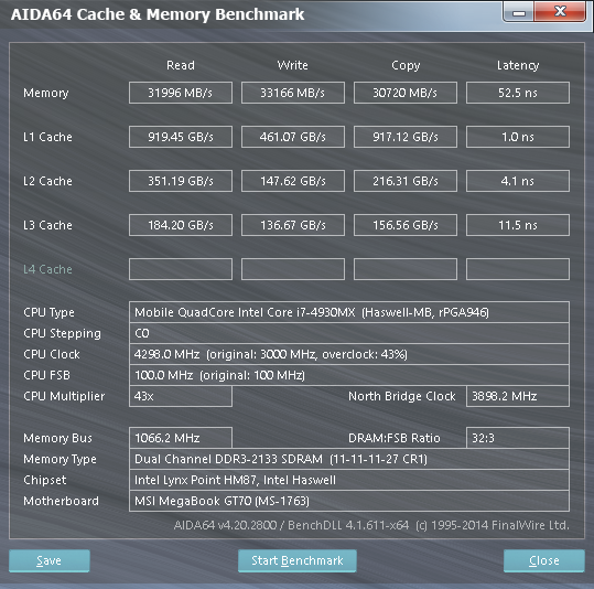

  10. Mr. Fox Set timings: CL 10 RCD 11 RP 11 RAS 24 WR 10 RFC 120 RRD 5 WTR 6 RTP 6 RC 15 FAW 25 And memory voltage 1,5V.

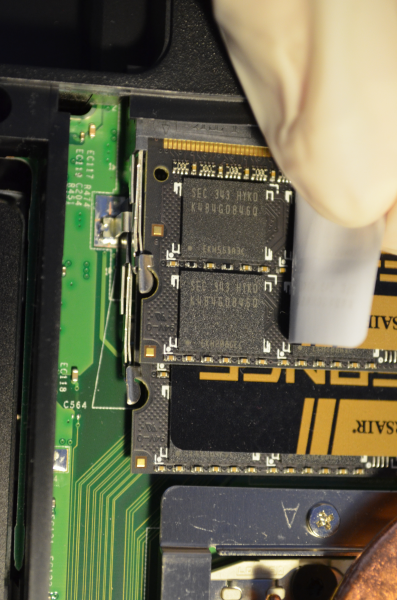

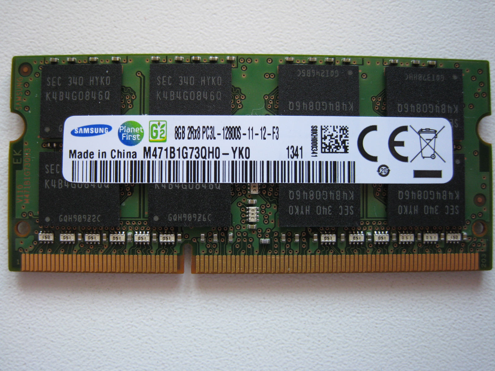

  13. You lucky. You have Kingston HyperX PnP 2133 CL12 with chips Samsung K4B2G0846D HYK0. It is the best chips in the world! Never 2x8 Corsair Vengeance 2133 CL11 will not win them (if you overclock your Kingston HyperX). Because Corsair Vengeance 2133 CL11 have chips Samsung K4B4G0846Q HYK0. In laptops max for this chips 2133 MHz with timings 10-11-11-27. But you can now overclock your Kingston HyperX PnP 2133 CL12 with chips Samsung K4B2G0846D HYK0 to 2133MHz with timings 9-10-10-24, or if not work 10-11-11-24. Just set in bios setup from "Default DIMM Profile" to "Custom Profile" and set correct timings.
  14. You right. Only single rank, and that explains the speed loss. Samsung low voltage chips Samsung B-Die SDRAM package is SEC 340 K4B4G0846B HYK0.
