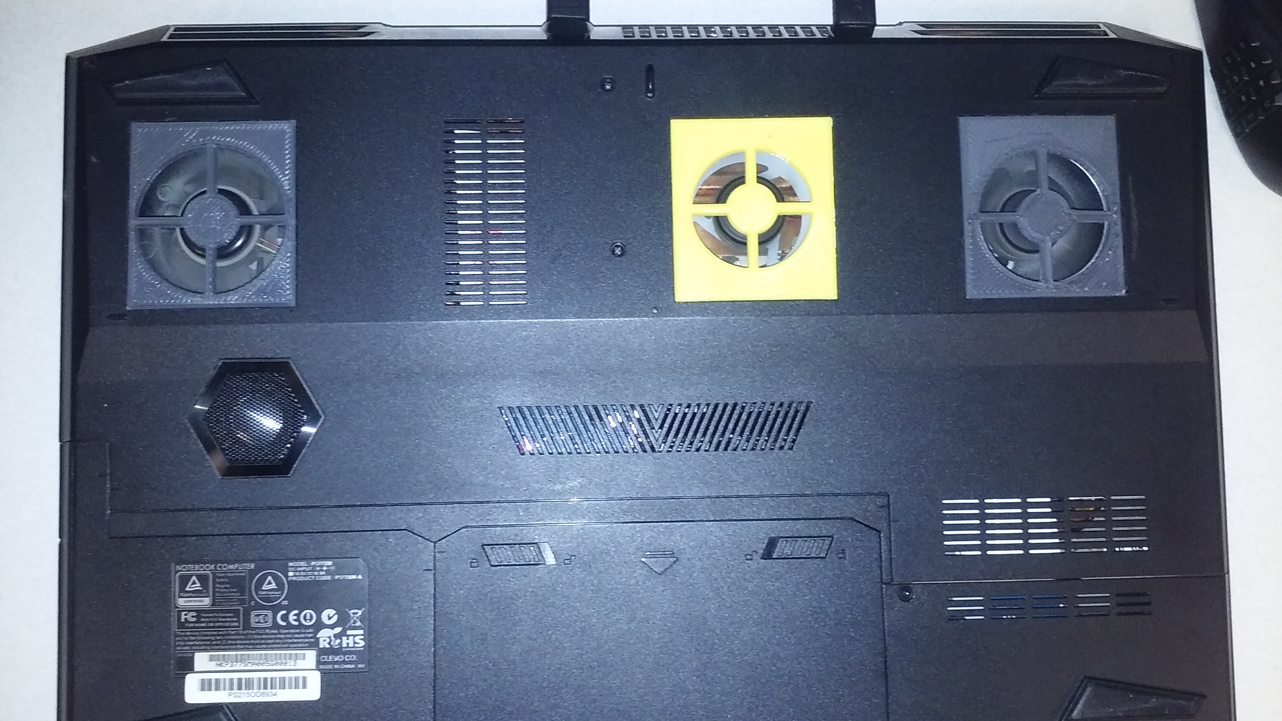

  1. Ended up cutting out my vents and 3-D printing custom replacements. Resulted in about 8-10C drops on both gpu's and cpu. Liquid Ultra resulted in another 7C drop across the board. Beginning to think my heatsinks are warped.
