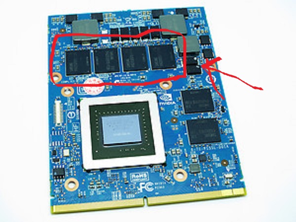

  19. You'll just need to put double layers of 0.5mm thermal pads on the RAMs here: And one layer on the rest, I also use phobya.
