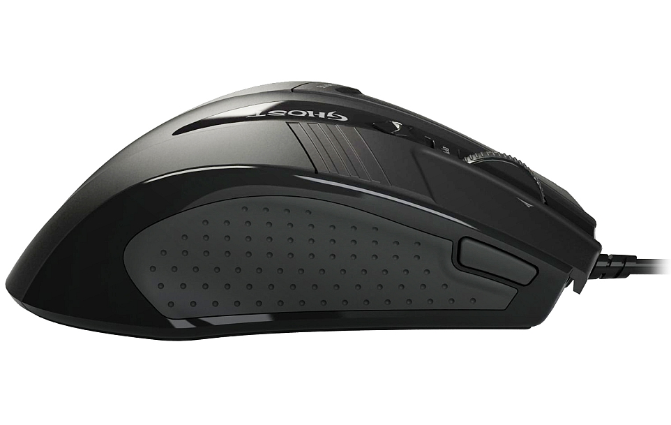

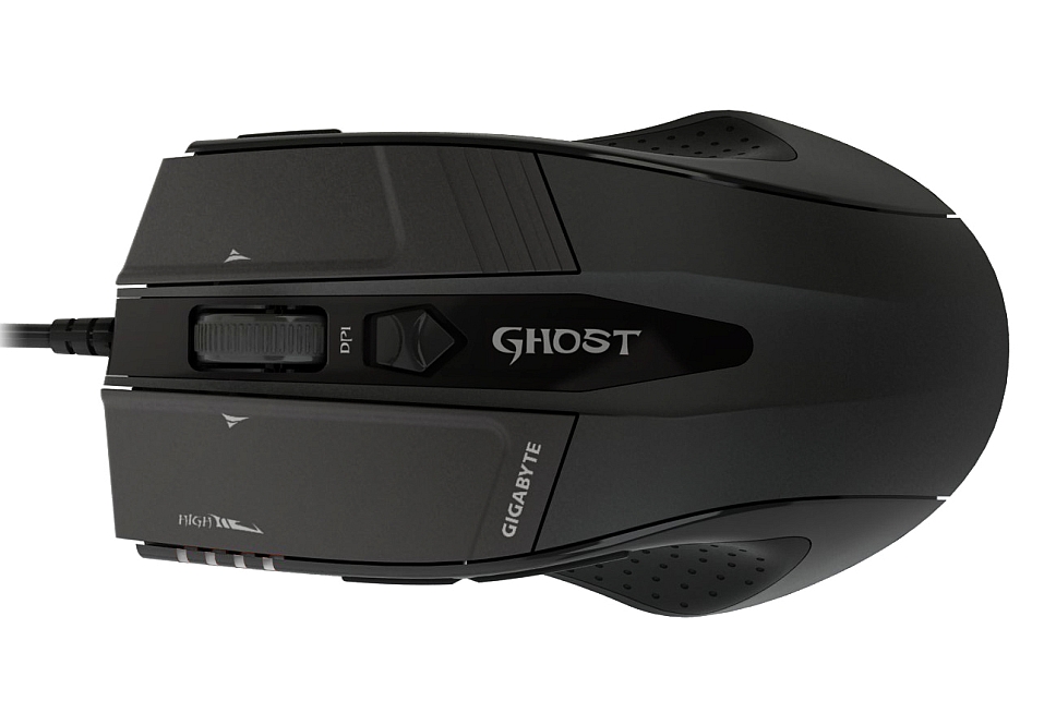

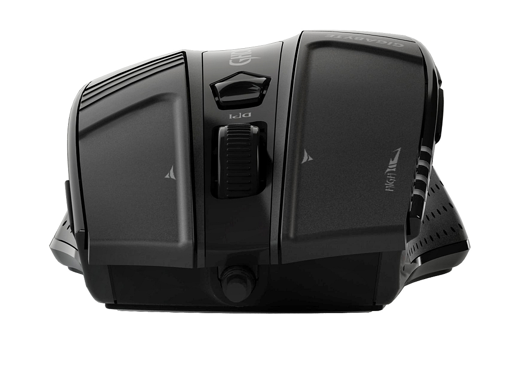

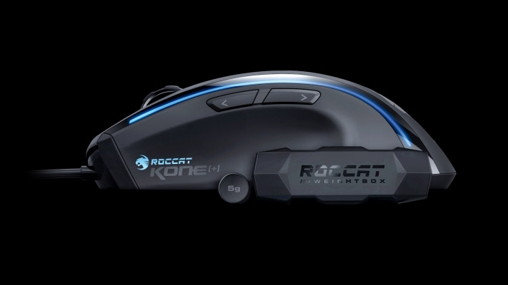

I'm currently using GIGABYTE M8000X and must say that it's great for me;) Playing FPS like a charm:) But my next mice will be Roccat Kone [+] 6000DPi because it fits a way better in my hand
