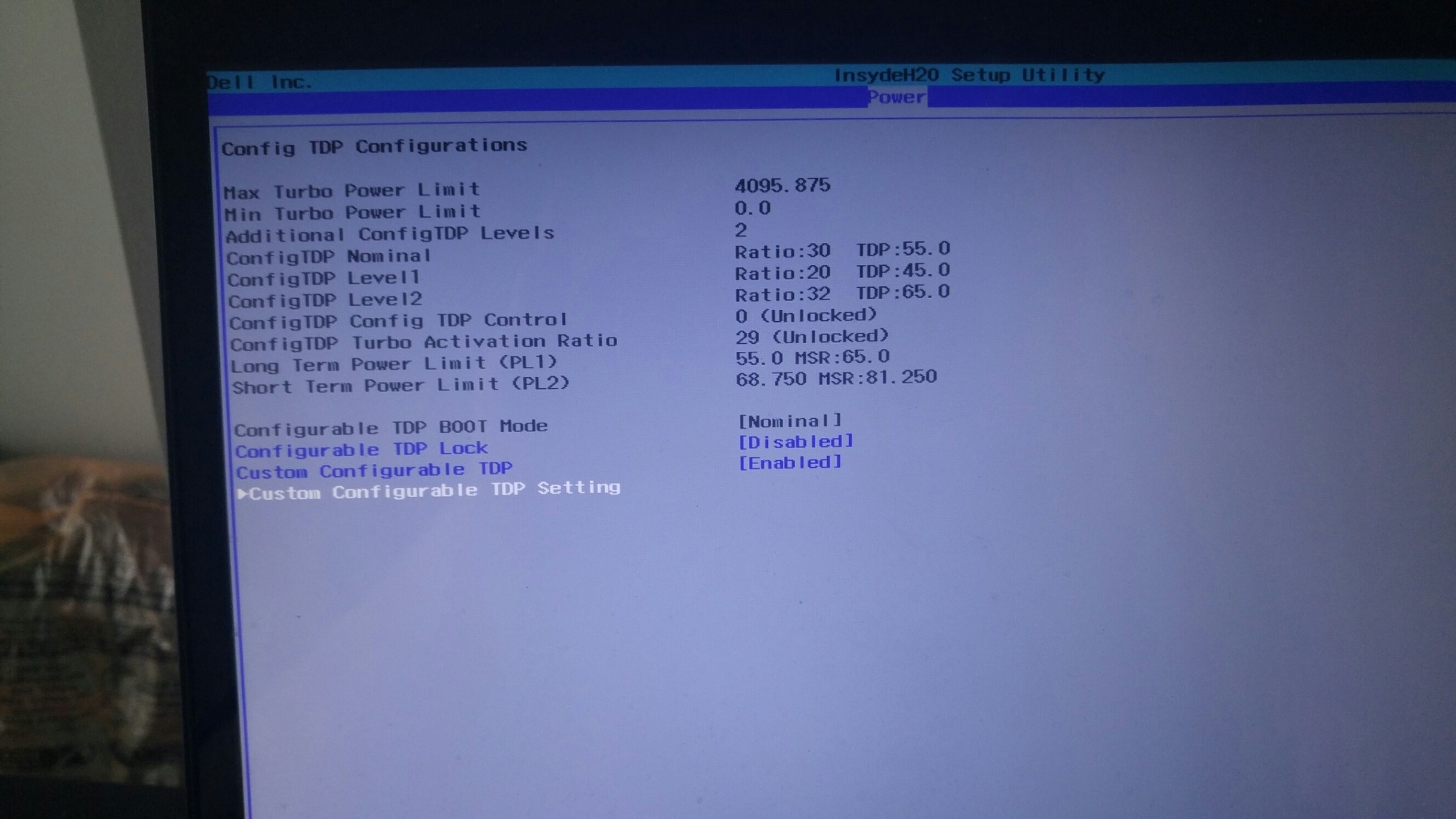

@J95 can you please share BIOS settings for removing motherboard power limit since I now have unlocked BIOS
@J95 as I have been also asking in my PM's, how did you successfully get past the TDP limit in the end? I have tried various combinations of things in this thread however it would be really helpful for me and other owners if you could get together a list of things that need to be done to get past it, like BIOS settings etc...
I have disabled MSR lock, remove the TDP lock and tried various combinations of settings however this isn't getting anywhere.. As on my thread in NBR, the minute I start the XTU stress test, the power limit gets hit in like 5 secs and clocks throttle from 4.3Ghz on 4 cores to 3.8GHz...
My Firestrike Physics score is 10950 is latest bench, which is the highest ever for me however if there is anymore that can be eeked out, do let me know!
Thanks,
Tom
Edit: I have got this showing in the BIOS.. Turbo power limit registers are not matching... This seems to be the problem for me... Any suggestions?
@J95 can you please share BIOS settings for removing motherboard power limit since I now have unlocked BO
Unlocked BIOS installed... Just doing rest of steps
@J95...
Edit: I have installed everything however J95 2 points,
1. I don't want to mess around with Creative drivers... I don't have any of those chipset issues and don't want that so I'll stick to old drivers (I have the latest ones on AW website).. do the new drivers actually make any difference?
2. I still have CPU TDP throttle... What settings should I set in the BIOS to prevent this? I have BD PRODCT disabled along with MSR... Maybe [MENTION=119]Mr. Fox[/MENTION] can also help?
