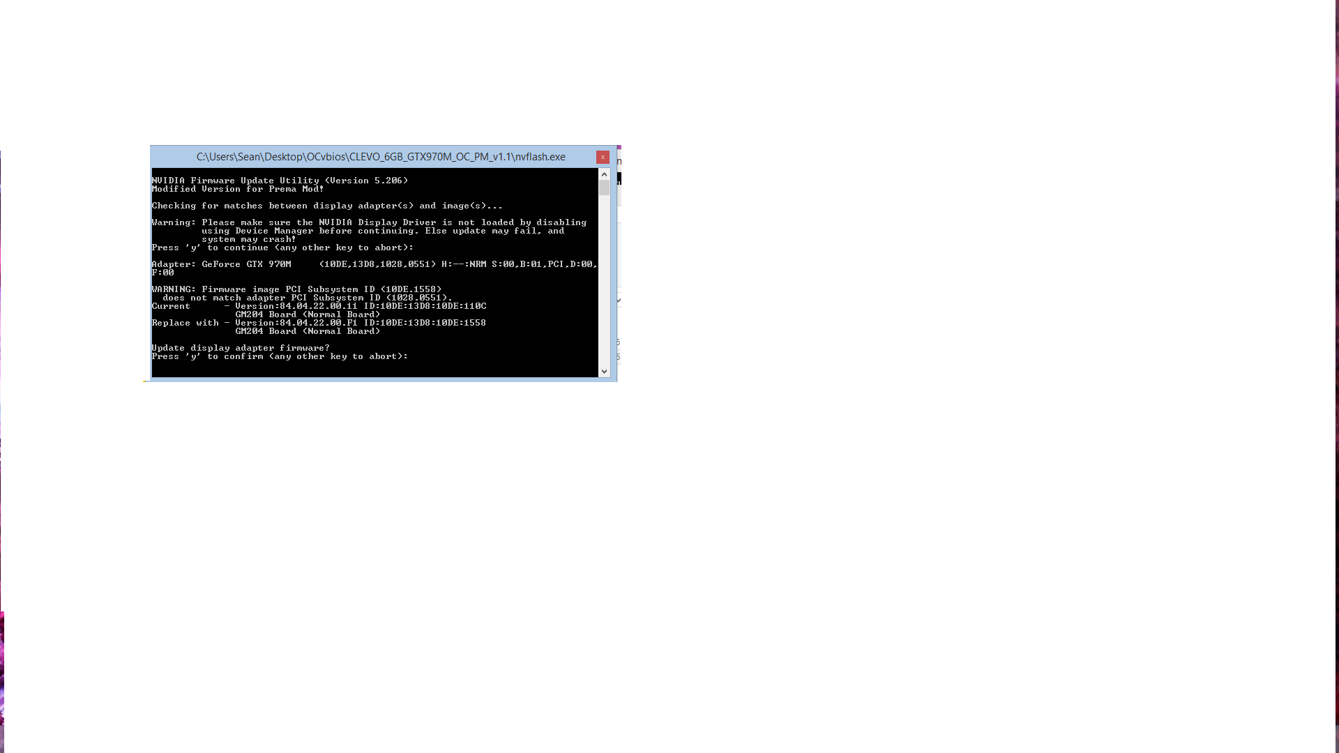

  18. I've been trying to flash the new Prema unlocked vBIOS... I got this though before flashing... I aborted as a result but will this be ok? The Device Ids don't seem to match lol.. Don't want to end up bricking my GPU... Any idea @ Prema or anyone else?
  19. I've been trying to flash the new Prema unlocked vBIOS... I got this though before flashing... I aborted as a result but will this be ok? The Device Ids don't seem to match lol.. Don't want to end up bricking my GPU... Does anyone have any idea about this? @J95, @thegh0sts [MENTION=5647]Lee James Wood[/MENTION] etc?
