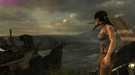

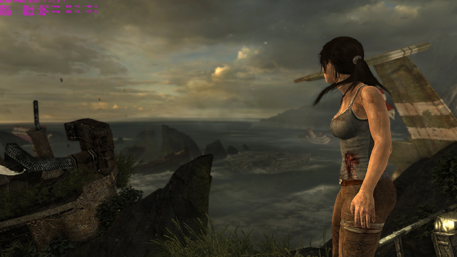

  2. hey tech inferno. so heres the problem, i flashed to svl7's oc bios and everything was golden, overclock was locked in and monitoring graphs didnt budge at all. perfect fluctuating, just the core tho. attached is a picture i took during TR benchmark, i have offset set at +200 on the core, and +200 on the memory gpu z says 1206/6408. voltage set to 1.212 both Titans are watercooled and temps are below 30c. you can see that the evga is monitoring the cards at 39% usage on the core at 810mhz. any help is appreciated
