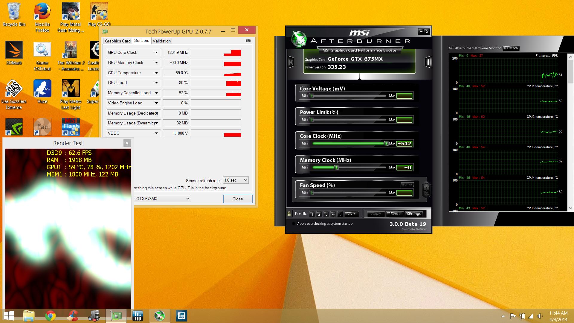

Perhaps he is reporting the frequency shown in msi afterburner? The stock memory frequency for 680m shown in msi afterburner is 1800mhz.

I was talking about the msi vbios. Clevo doesn't have a turbo button and therefore hitting it doesn't do anything at all. On msi, your voltage would increase from 1.000V - 0.950V to 1.037V - 1.012V depending on whether your temperature is above or below 67C when you hit the turbo button. If you flash svl7's modified msi vbios, the only thing the turbo button would do, is make your clocks stay at max at all times. However, changing your clocks using nvidia inspector/ msi afterburner will make the turbo button useless in svl7's vbios.
It is because with turbo off, it runs at 0.950V and with turbo on, it runs at 1.012V. - - - Updated - - - Ello svl7, can you pls unlock my core clock limit /s :snicker:

Are you sure you flashed it properly? Boost should be disabled and you should have a +540 limit. -
