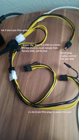

  1. @weecooper: Since nobody answered to my post #881 i´ve do it by t&e. What should is say, one step will work, the GTX660Ti is accesible. @All: There is also an other solution to get power into the enclosure if some tools (aka. soldering Iron, mini drilling machine) your friends, and you are willing to invest some work, . Here´s a little workaround In short: desoldered the barrel jack from the PCB make some solder points on the PCB desoldered the power connector form a Dell Optiplex GX620 solder the new power connector to the PCB solder two wires for to power the PCIe plugs of the GTX Plug in the jack from a Dell DA-2, power up the system, lean back and enjoy OMG, your warranty void if you do so , sh** happens, but it works quite fine for me little Impression: Once all my works finished i´ll illustrate and describe more detailed what i've done. Greetings
    2 points

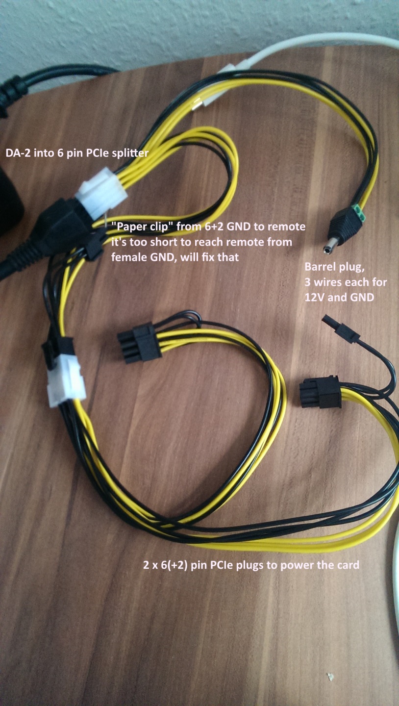

  2. So here is the picture of my cables, still works like a charm, can't await my GTX 970 *sobbing*

  7. @seefew: Good job! Love the very minimalistic wiring. Keeps the inner case very clean. Inside mine it's kind of messy. The wire for the 2*6-Pin PCIe plugs are thick enough to carry 12V and 12-13amps?

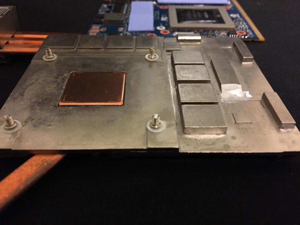

  8. New MSI MEDION Heat Sink nVidia GTX780 GTX770 E31-0406580-Y31 | eBay New MSI Heat Sink nVidia GTX780 GTX770 GT60 GT70 GTX 680 GTX 675mx GTX 670mx | eBay and so you must modify the Heatsink for the Maxwell Cards:
