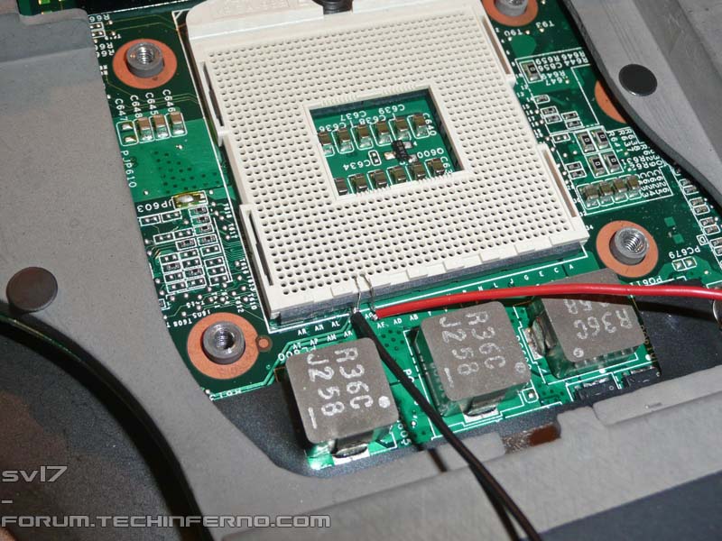

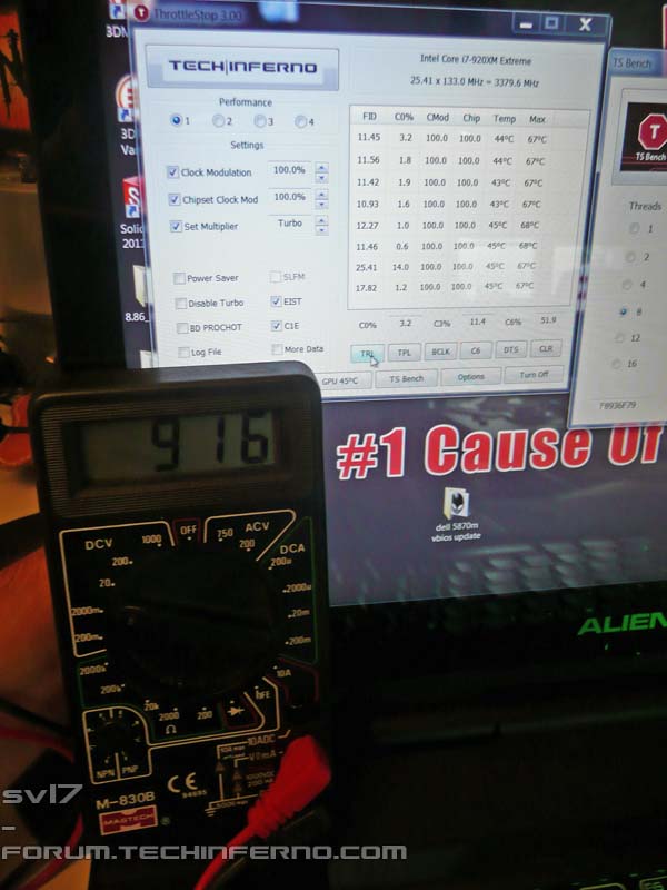

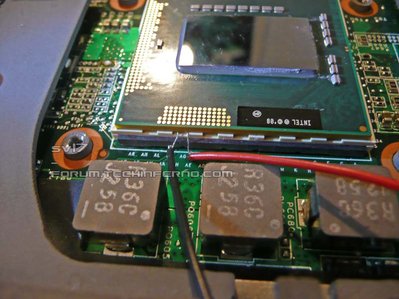

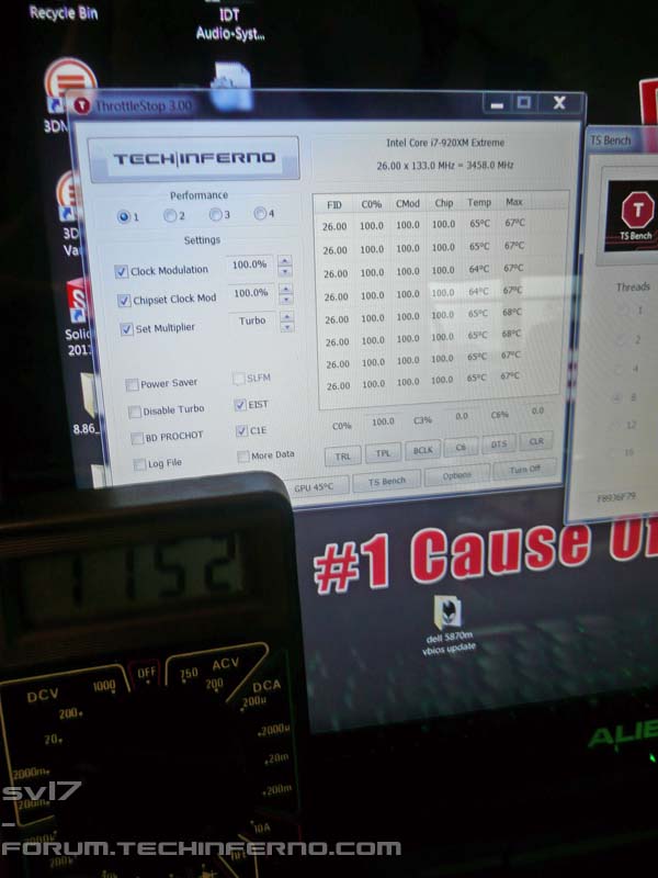

  11. Ok, since it seems that there's no method to read out the voltage with software I decided to measure it directly at the CPU. The datasheet of the CPU describes each pin, there are VCC (processor core power supply) and VSS (processor ground) pins directly at the edge of the socket, which makes it easy to measure the voltage. VCC_sense and VSS_sense would've been possible as well, but they're not at the edge of the socket, which makes it more difficult to put cables there without accidentally touching another pin and shorting something. I was mainly interested at the voltage while the CPU works at the max multi (26x) on all threads. My multimeter always reported 1152mV. There's of course a certain inaccuracy while measuring this, especially since I don't have the most expensive equipment, but it's accurate enough for my needs. This value will allow me to figure out a VID pinmod for raising the voltage a little bit. At idle the CPU was at about 900mV. In case you're interested in the voltage at a certain multi, let me know as long as I still have the cables in the socket. Though after reading some Intel datasheets it seems that the voltages may vary from CPU to CPU, I'm not quite sure about this, maybe someone here knows more about this.
