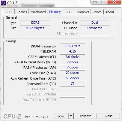

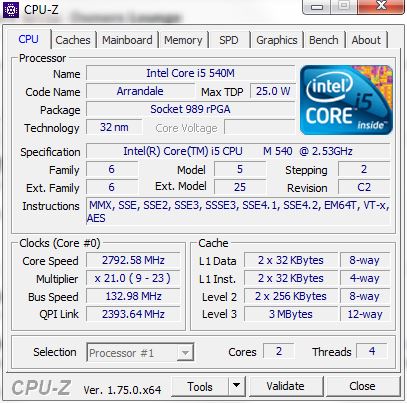

As a non-tech guy, I'm looking to breath a little life into my old m15x starting with ram.  It's not used for anything to intensive, but is showing its age.
Would Kingston HyperX  8GB Kit 1600MHz DDR3L CL9 SODIMM 1.35V Laptop Memory (HX316LS9IBK2/8) work in this system?  Any reply greatly appreciated.
Not so plug & play for me.  I end up in a reboot loop.  The memory check passe, and both show up in the bios (A09).  Saw something about a memory frequency error.  Can the frequency be adjusted?
  • Moderator
That memory is DDR3L (low voltage) rated at 1.35 which I don't think is compatible with such an old model. You'll need 1.5V memory.
