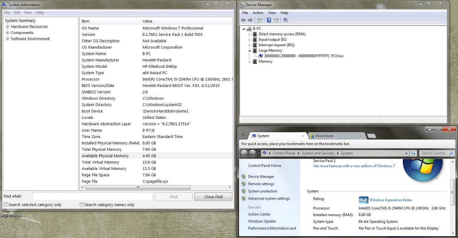

Dsdt override!

7 minutes ago, purpletoast said:
Hey everyone,
I got my parts in yesterday and I've spent many hours tinkering with it. (HP Elitebook 8460p)
After doing some troubleshooting and patching (Nothing worked to get me a clean dsdt except for Aida 64 version: Engineer [free trial]) I successfully completed the dsdt override!
Sidenote: was too lazy to make a Linux usb drive, thanks nando for the guide
Now, I'm wondering if DIY Egpu setup 1.3 is the next step if i'm using:
-  a Series 6 chipset (QM67) - EC x1 2.0 (Pe4c v3.0 EC)
-  have the large memory space
-  > 4 gb ram;  (8gb ram)
-  AMD dGpu (no iGpu), an eGPU nvidia gtx 750ti card
-  most importantly: all the load options I tried are allocating small bus resources to the eGPU in the EC slot (Code: 12).
There's not a lot of information since I can't access the later pages of the thread due to some error.
It seemed like the right one due to the PCI compaction, changing PCI busses, and disabling the dGpu. I wanted to make sure before purchasing that this is the logical next step.
Dsdt override!
https://www.techinferno.com/index.php?/forums/topic/5874-guide-dsdt-override-to-fix-error-12 already explains next steps to do if you still see an error 12 after performing the DSDT override. Quoted here in case you missed it:
Quote
9. The same fix was done on a Dell E4300 and Win7 did automatically allocate the eGPU into the 36-bit space. If you still see error 12 then there are two options to pursue:
  • Re plug'n'play the devices. Go into Device Manager -> Video cards, delete the eGPU. Also go into Device Manager -> System devices and delete the PCI Express Root Port x entries.
    Upon restarting the system, halt Win7 startup with F8, attach and power on your eGPU and then proceed to load Win7. Win7 should now be clever enough to re-allocate the eGPU into 36-bit space upon realizing there is insufficient 32-bit space to host it.
    Can go one step further and delete your eGPU NVidia/ATiAMD driver, restart the system and reload it. That may help as well.
  • Hard allocate the eGPU into 36-bit PCI space before booting Win7 using Setup 1.30. Select PCI compaction->Endpoint=56.25GB (36-bit) and then select Run compact. When prompted for the scope select eGPU.
    The result will be similar to that shown in the spoiler in step 8 above, but with the eGPU rather then the Intel HD iGPU being in 36-bit PCI space. Can then proceed to automate this by editting your %DRV%:\config\startup.bat (or V:\config\startup.bat in windows) so can just select the Automated startup via startup.bat Setup 1.30 bootitem and have it do everything for you:
    call speedup lbacache
    call vidwait 300
    call vidinit -d %eGPU%
    call pci
    call chainload mbr
Ah, seems like I missed part 9.b . I'll retry step 9.a and update later tonight. Also, would uploading the fixed dsdt with the relevant laptop model number/bios version be helpful, or will it just cause people more problems.
Would be more helpful to create a complete 8460P implementation guide where the DSDT part has a link to the fixed DSDT. Then 8460P users have a complete reference of what they can get going after putting in the required steps.
Sounds good! When I get it working, I'll make a guide on what I did/Steps I followed.

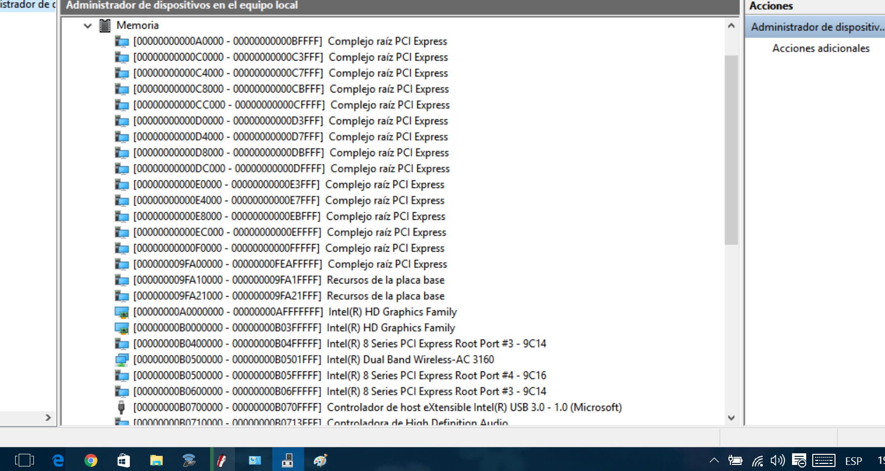

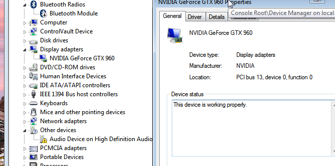

The t530 is arrived, I have reinstalled windows 7 with egpu connected, no error, everything appear to be fine, the igpu and egpu are installed without problem.. But when I play with games they use only the igpu, I've tried selecting the gtx960 inside nvidia panel as preferred for gaming but no changes.
Any advice? I must install egpu setup for make it work? Thanks.
Inviato dal mio Lenovo P70-A utilizzando Tapatalk
Edit: solved ! After connected an external monitor the egpu works also into internal over games, t530 works without any mods.

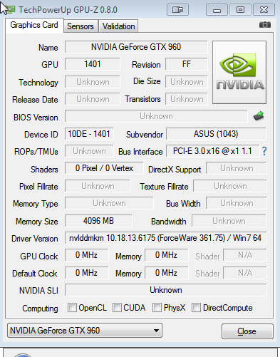

Hello,
Here are my specs:
DELL M6400 (quadro fx3700m built in)
EGPU adapter: EXP GDC 8.0 via express card slot.
External card : GTX960
The EGPU card is found and drivers installed: SURlXEw.png
However, I'm still only seeing a picture on my laptop display and not the external monitor I have connected to the EGPU card. Also I'm unable to start NVIDIA control panel or any games without them crashing.
I tried running DDU to uninstall my quadro card drivers before installing these drivers but still no luck.
Should I have to disable the dGPU?
Here is gpuz screenshot: rp8lVLt.png
Thanks
