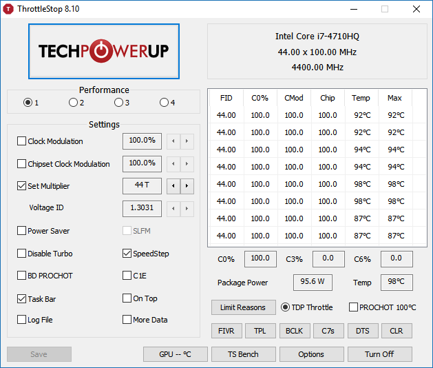

iAchilles 0 Posted July 12, 2016 4 hours ago, Ultrax5 said: @iAchilles If the battery is at 100%, the CPU can reach 58 Watts, so that allows for 3.6Ghz@all cores. You can try setting core VCCIN to 1.75V and using PowerCut, that will allow for any multiplier because it wil hack the power reporting, so it won't trigger PL1 or PL2. Anyway, the setting doesn't stick after reboots and is basiccally a huge hack, so use it with caution. C7s section can be helpful in getting more battery life, and TPL is only needed when you overvolt your CPU. I've tried undervolting the GPU on Clevo vBIOS and I've managed to get it to 1.09V(minimal voltage allowed). The max overvolt limit on the other hand is 1.2V, but it didn't really help me much, because after certain frequency my GPU starts erroring out in OCCT and no overvoltage helps it. Doesn't matter if on my modded vBIOS or the Clevo one, it just hits a hard limit of the GPU silicone quality itself. I still don't know how to unlock undervolting using my modding knowledge (I only know how to unlock core clock slider + voltage up to 1.2V). to my and ur surprise, ive checked it with battery full and the power cord plugged in, yet PL1 and PL2 happen after, i think, 48 W passed !!!! how this doesn't happen with urs ?!? i cant reach 58 W AT ALLLL !!!! and yes i read the READ ME file of TS by which how to eliminate throttling based on power consumption but the prob here is how u know exactly what is VCCIN for our CPU in y50-70 coz if we set the VCCIN number wrong it might lead to dangerous result. Quote Share this post Link to post Share on other sites
Ultrax5 11 Posted July 13, 2016 @iAchilles The VCCIN is usually 1.75V, doesn't matter if it's desktop or laptop. I've never seen values other than that You can try going lower, just remember to keep a 0,4 delta between the core voltage and the VCCIN, for example if your vcore is 1,1, the lowest VCCIN you should use is 1,5V. 1 Quote Share this post Link to post Share on other sites
